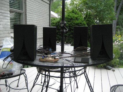

I got all four done. I must say, I'm somewhat disappointed in the sound. Perhaps I'm spoiled. Others are impressed by them.
IMO they sound tubby. The bass is surprising, if not too exaggerated. Percussion and bass guitar are surprising from such small speakers, They sound much bigger than they are. They sound better when played loud.
Vocals are another matter. Male singers sound like they're in a well.

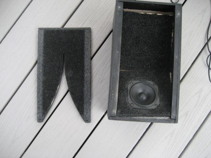

I recall some suggestions regarding stuffing. They currently have some acoustic stuffing in the stub cavity above and behind the driver, with some more loosely behind the driver. I'll add more in the path leading to the slot and more densely stuff the area directly behind the driver. I recall reading that adding stuffing reduced the bass output but made the bass tighter. I'll report back.

After adding stuffing to the boxes (and a Royal Oak Brewing Mean Streets Amber Ale to me) the sound is very much improved.

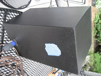

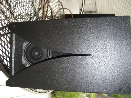

Full disclosure: the enclosures are 1/4" baltic ply. The motorboard and front K-slot boards are 1/2" baltic ply. The interior panels are dampened with 1/8" closed cell foam. The front of the baffle boards and the back of the K-slot boards are covered with the textured closed cell foam shown in the attached photos.
Rather than binding posts, I use Neutrik Speakon connectors. I always want a product of Lichtenstein in all my speaker build.
The enclosure are glued together with Loctite PL supplemented by brads from a Paslode finish nailer and liberal clamping. There are no air leaks.
After the added stuffing, and the beer, the sound is very much improved. The tight percussion is even better. The drum solo on Brubeck's Take Five is amazing. The cymbals are now readily apparent.
Vocals, male and female, are improved. The "down a well" effect is gone. They are amazing little speakers. I'm eager to see how the mate up to some DIY subs.

Those look fabntastic! Like mini PA boxes with Speakons and black Duratex paint. I have never heard one made of half in BB ply - that is some stiff stuff. Glad you like the sound and Take 5 is one of my favorites. Try listening to Paul Desmond's Glad to be Unhappy (I think he played sax for Brubeck in Take Five) sometime - the wide sound stage on these will go beyond their placement width.
