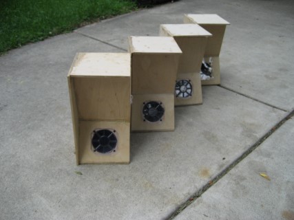

@xrk971 so the last couple of days I've tried drawing your plans to scale a couple of times, with a height of 15 3/16, and I can't seem to make it add up. Specifically there seems to at least be a right-angled triangle problem on the left:
h^2 + 3.0^2 = 7.5^2
h = sqrt(7.5^2 - 3.0^2)
h= 6.87" for the baffle
then 6.625" (top slanting piece) + 3 * 0.2" (bottom, top, top of slanting piece) + 0.84" (vent gap) + 6.87" = 14.935". A decent chunk away 15 3/16, and that's without even slanting the piece above the baffle, which makes its height less =/
Show me a sketch of where your problem is. I can't follow your written description. Use GregB's CAD drawing as the basis of scaling. My sketch in post 1 is kind of approximate. And actually it wil work pretty well with a little variation so don't worry if you can't get all the dimension to line up. What I do is lay out the side and take a ruler and draw where the boards go based on how deep the front chamber is and how big the vent gap at top is, the the internal separator wall gap.
Sure, sorry that was a poor explanation, here's a sketch. Basically I can't seem to make the height work with the size of the internal components at the front. I'm totally fine with "take the height, depth, baffle size, vent size, and front chamber depth as gospel and measure out the rest to fit", just want to make sure that's the right thing to do.
Yes, that is the right thing to do. 🙂 Match those key dimensions and aim for circa 15in tall cabinet (external) and you should be good.
But if you really want to do a "scale" drawing, use GregB's CAD plan here:
https://lh3.googleusercontent.com/-IsPCPSK6_lQ/TtU92CD8zMI/AAAAAAAABik/txissf4J4PI/w678-h524-no/Karlsonator.png
And scale that rather than use my drawing.
