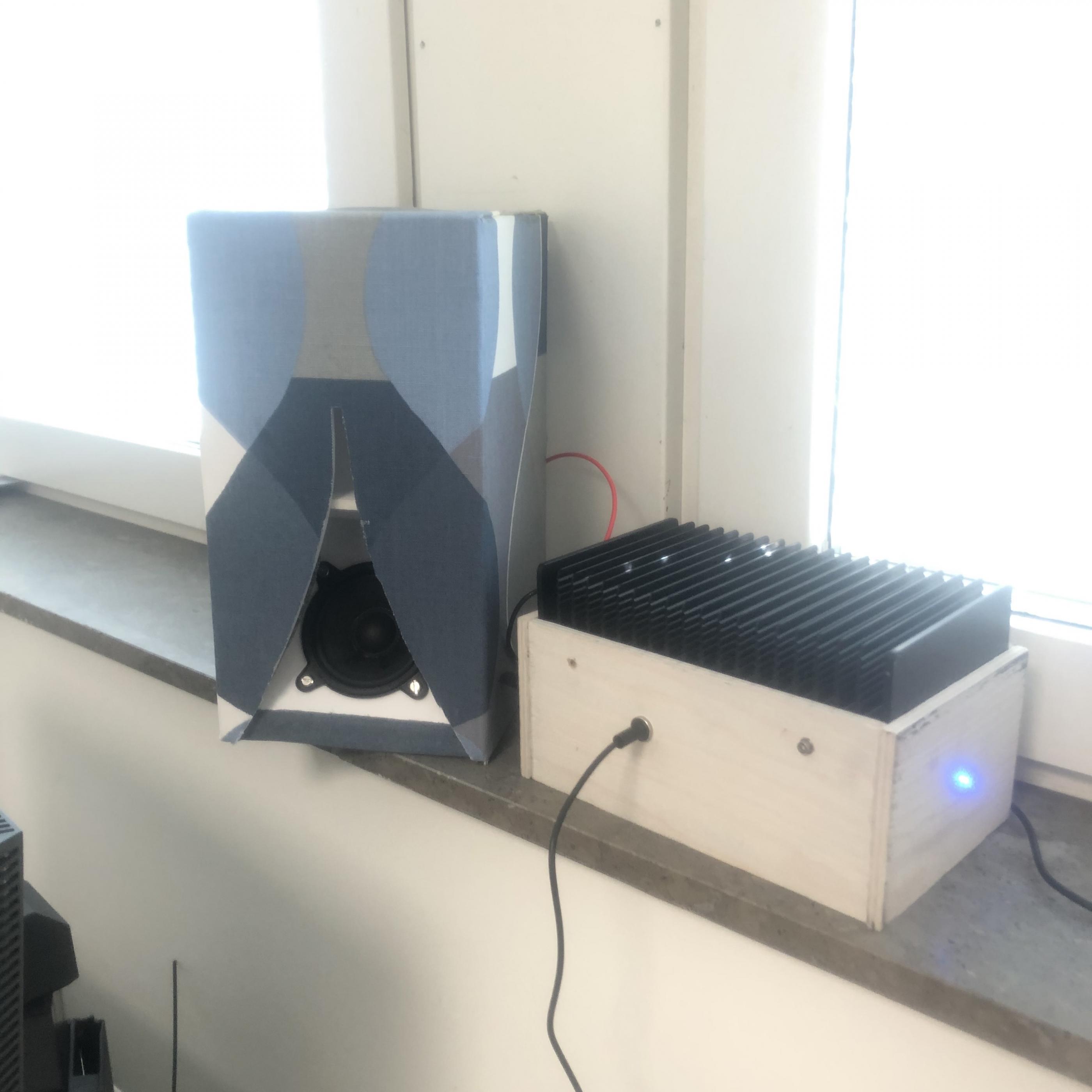

I have searched for a reasonable speaker box for my Faital 3FE22 as alternate to a Whiskey tube. This project looked interesting so made an attempt. This is the result. I was very surprised over the sound quality when connected to a ACA channel. I found a spare cloth for covering.
Thank You all for the templates. I had to shrink it down a bit due to board size (700x500mm) but happy with the result.

Actually fits and looks ok on that ledge there.
Paint the amp box grey and you got a set!

That is the highest praise I can get, thank you.
The speaker light up the mood at work with an ACA-channel.

Super good looking speaker there, Sov! I really like the patterned fabric covering. Great idea. I might have to make a set like this. That’s good that you shrank the size a bit for 3FE22. It’s got a more powerful neodymium motor and Qts and Vas is smaller, so a smalller cabinet is probably perfect. You have 91dB sensitivity so perfect for a 5W ACA.
Very nice build quality and attention to details - one of the best looking 0.40x Foamcore Karlsonators I have seen.

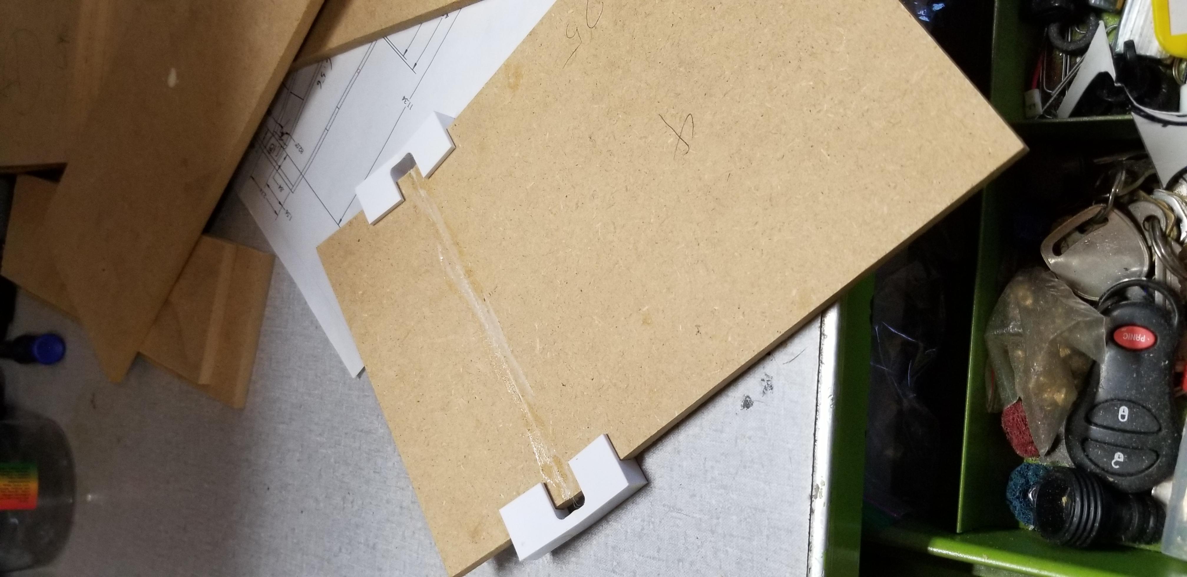

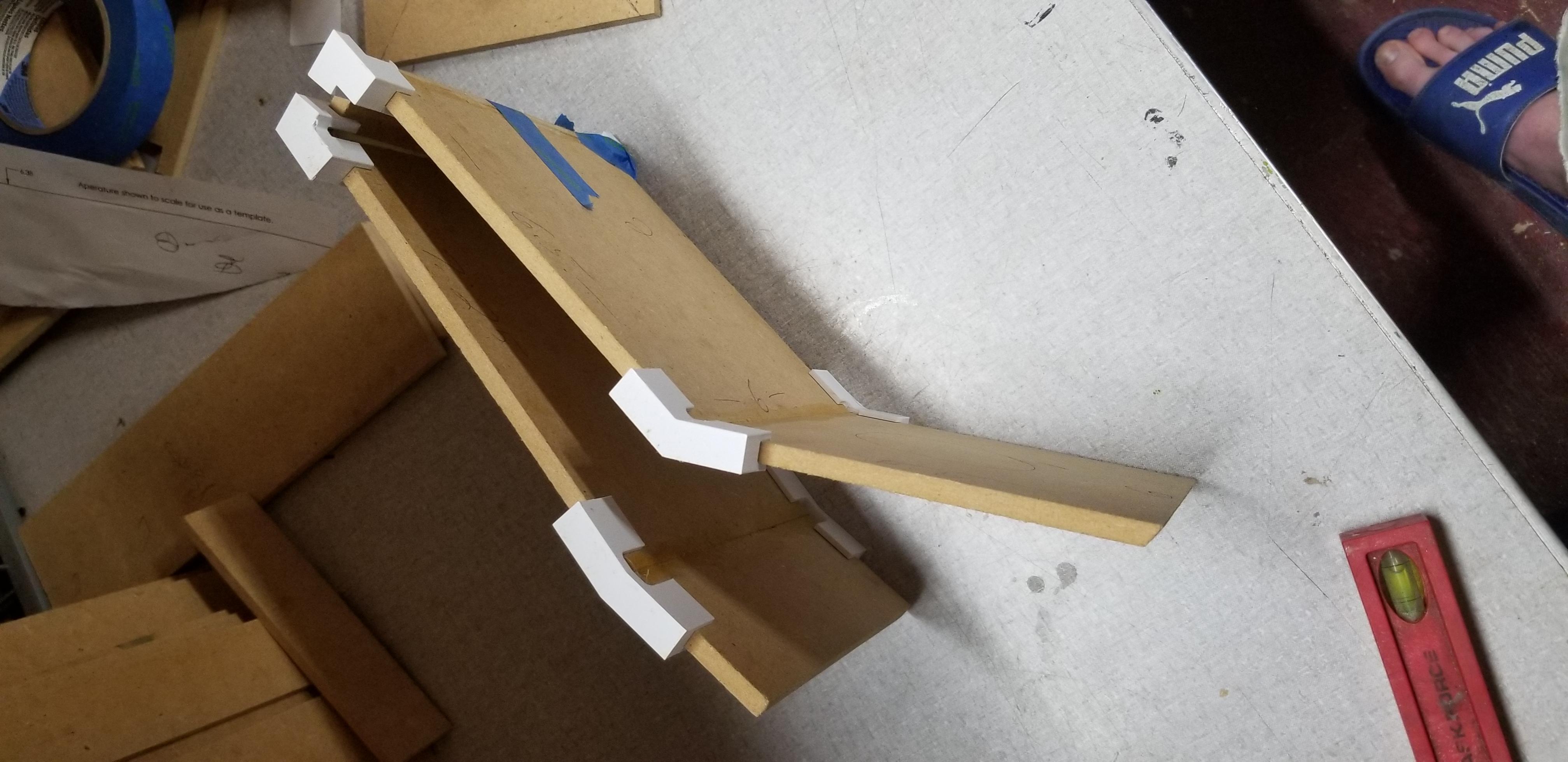

Did you make custom 3D printed jigs for holding the boards in place while glue dries?
Another way is to glue onto a side panel with the shape drawn on it. Use hot melt glue as tacks to hold in place while wood glue dries.
