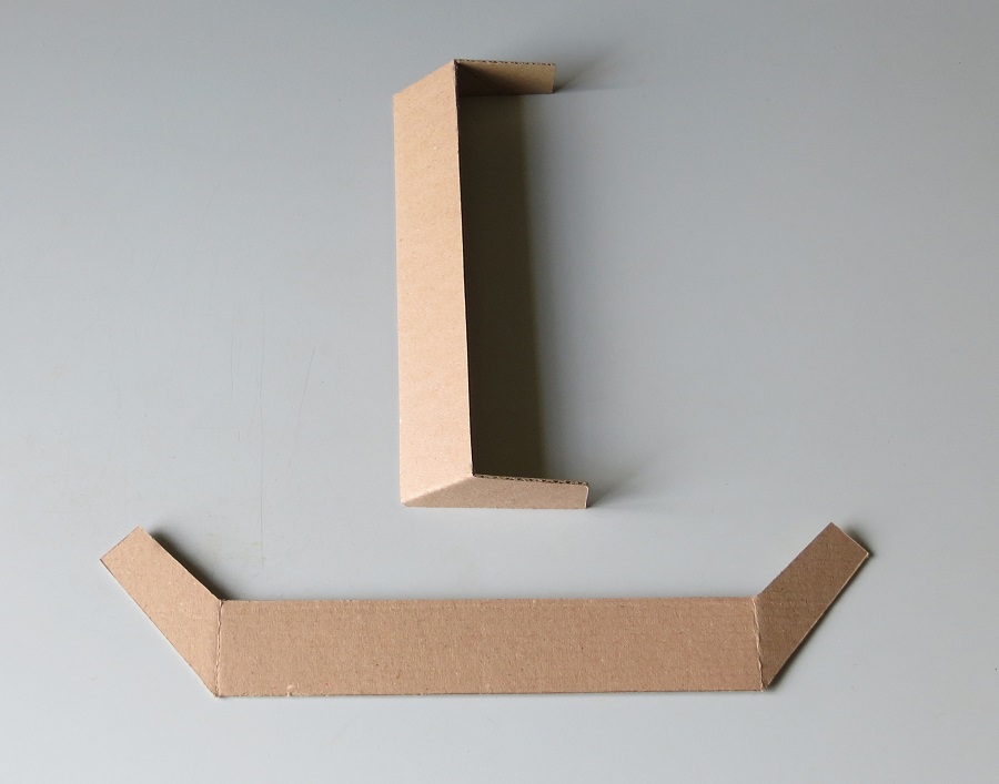

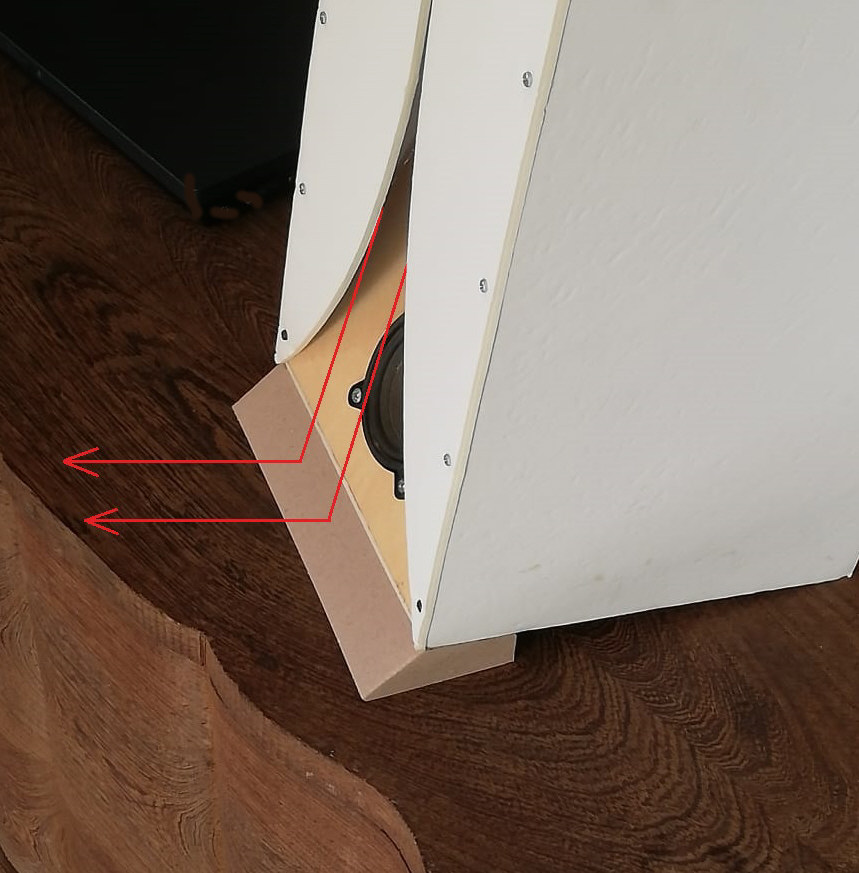

I don’t know if this has been done before, but it does yield very positive results if the angle of the deflector plate is correct. The angle will depend on the height of the speaker and ear height, as well as the distance of the listening position from the speaker. My first guess was 40 degrees from horizontal, but I get a lot more bass when sitting on the floor. That means a slightly flatter angle is required in my situation.
The size of the deflector plate will depend on how much space is available downward or how much you’re willing to raise the speakers if it’s standing on a fixed surface like mine. Revision 2 will have a larger deflector plate (it is 37mm wide atm), as I’m sure that I’m not catching all the sound waves that come streaming down and out the bottom of the K-aperture.
Take measurements, draw it out and get the angle right. And then go and enjoy free bass!
Disclaimer: Please don't expect subwoofer-magnitude bass. This concept boosts bass a bit, but it may not be enough bass for most people's tastes. Unlike a sub, it doesn't create bass from almost nothing. If the music piece doesn't have any or little bass, this gadget will not miraculously give a lot of bass.

The next iteration will be of white foam core, X. And much wider too. This is just the beginning of my experimenting, but I wanted to share it here in case others are also interested.

Having said that, I made the deflector plate much wider now (125mm) and also got the angle right. Apart from added bass, it also affects the soundstage, which is more "dense" in the center than before. The easiest way to describe it is "Karlsonators on steroids". This is the best I've ever heard my speakers sound. But funny thing is, the effect is more noticeable on some music tracks - the ones with more bass.
I suspect that this idea will become a permanent fixture on my Karlsonators.

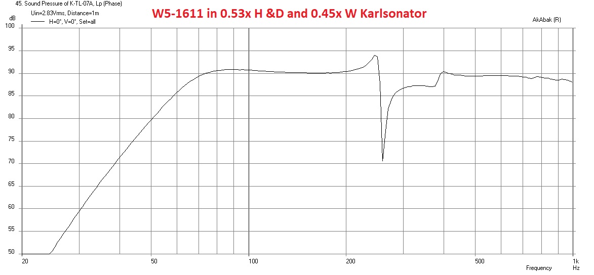

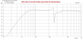

I was looking to build a MLTL with my W5-1611SAF, but then I thought they might fare well in a mini-karl.
It was asked in post #2255 way back in 2017, but I think it fell through the cracks and never got an answer.
Would you mind telling me if it's a good driver for this?
I think it would look good, and the W5 is big enough for some decent bass output, but still small enough to not use a tweeter.

Yes, the W5-1611 can work ok in a 0.53x scale Karlsonator. You will have a slight bass hump overshoot by a few dB. Better is 0.53x H&D but 0.45x W to make it a little skinnier. This wil give a flatter response. 90dB sensitivity and -3dB at 64Hz.
So if you have an 0.53x box already, just swap drivers. I wouldn't bother making it smaller in width.

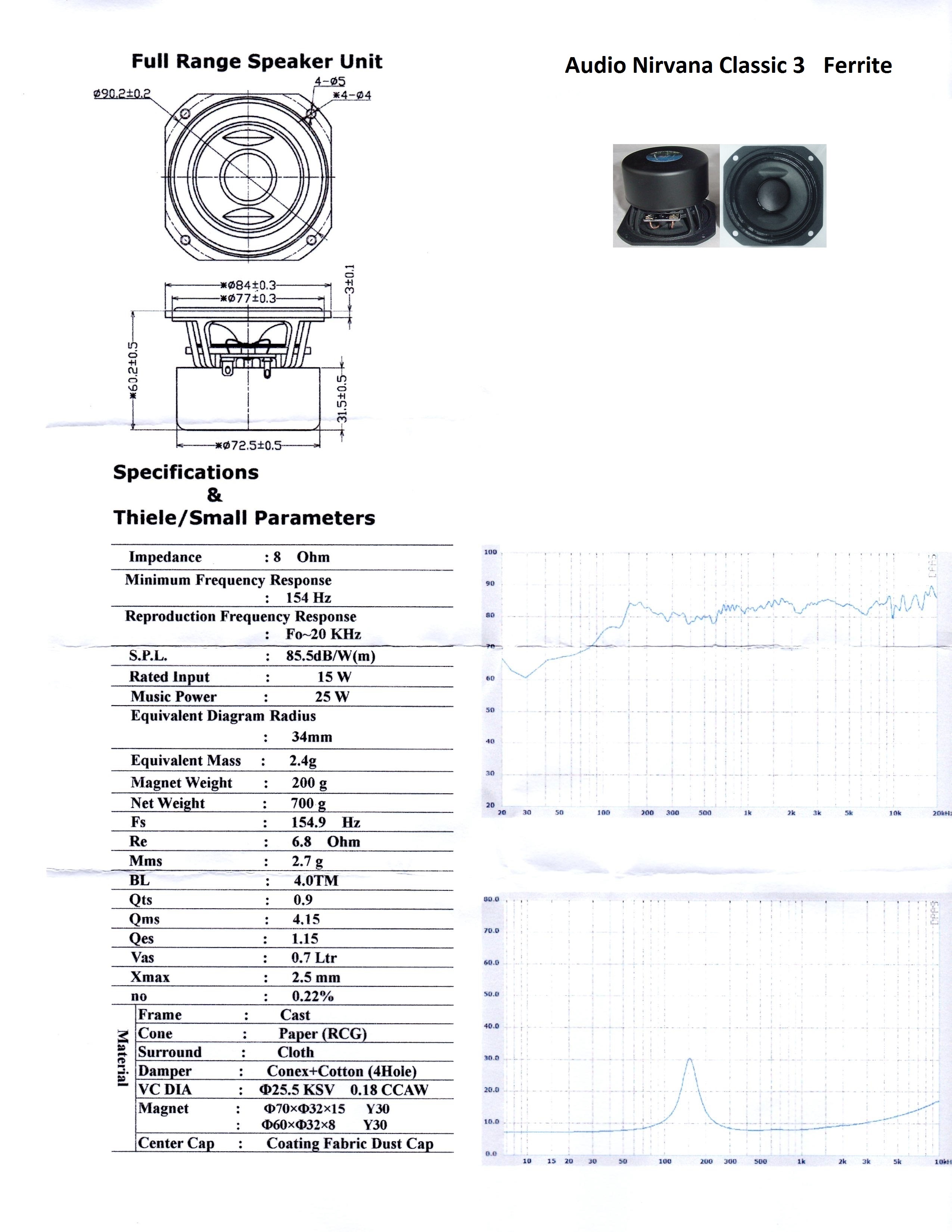

Could I ask you to run a sim for an Audio Nirvana 3" Full-Range driver, for use in a Karlsonator 0.4x? (I live in St. Louis and the AudioNirvanas are made here in the area, so ... shopping local).
Is this a suitable driver for the 0.4 size, or would some tweaking in Height / Width improve the presentation?
Audio Nirvana also makes a 4" and a 6.5" full-range ... wondering if those would work too.
Here are the specs for the 3" driver:
Def_Driver ‘AudioNirvana Classic 3’ | Audio Nirvana 12A Qts 0.90, 2.5mm xmax, 15w 85.5dB
Sd=55.16cm2
fs=155Hz
Mms=2.7g
Qms=4.15
Qes=1.15
Re=6.8ohm
BL=4.0Tm
Le=0.0mH
Vas=0.7L
https://www.commonsenseaudio.com/an3specs.jpg
*did not know how to find or calculate Le value so left at 0.0*

This is a typical 3.5in driver (36cm^2 Sd based on 6.8cm dia membrane) with Qts 0.9 but fs is rather high. Based on my experience designing these - no need for a simulation. It should work fine in a 0.4x scale Karlsonator.
