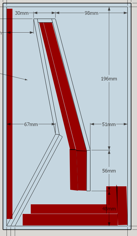

that post brought me to the point where i am stuck.
i don't precisely see which surfaces are padded inside the inner chambers.
Mini Karlsonator (0.53X) with Dual TC9FD's
I have built 0.4x and 0.53x versions. For both I have used dense sponge only in the backside of the inner chamber and on the bottom panel (right below the driver) with fantastic results. So I hope my answer helps you.
Yes, mostly those areas you showed, but not on the front [emoji4]
on the backside of the front panel i attached carpet.
this is where x put foam board.
i'll leave that area as it is.

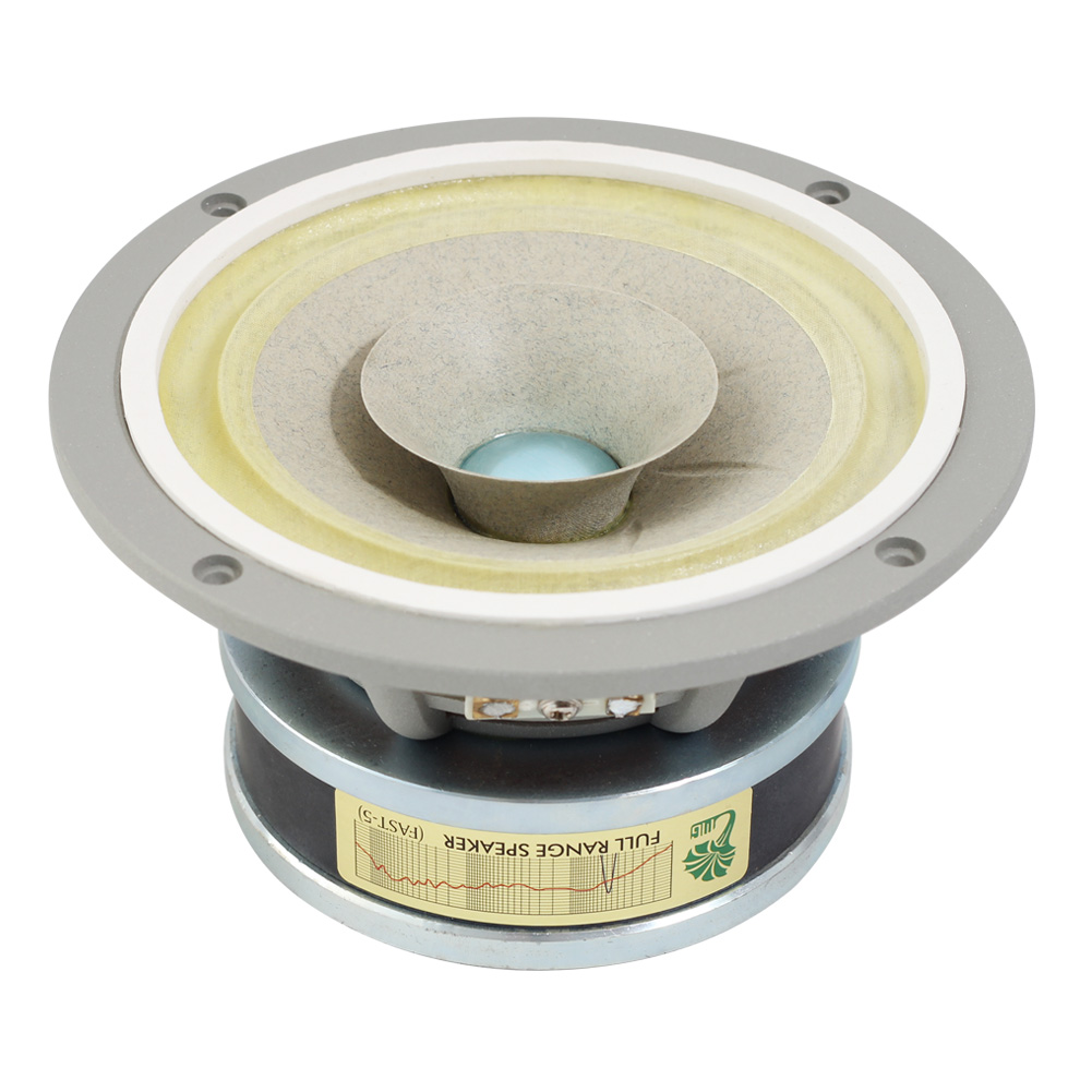

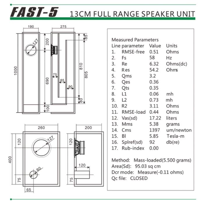

XKR - here's another driver possibility. This brand seems to be gaining momentum, and the drivers are very well priced...
Lii Audio Fast-5. Will this Karlsonate well?
That looks promising actually, of the TS parameters measure out like that, it could work. Will have to run a simulation to set scale just right.

How cool to see that they depict the frequency response on their label! Who else does that?
