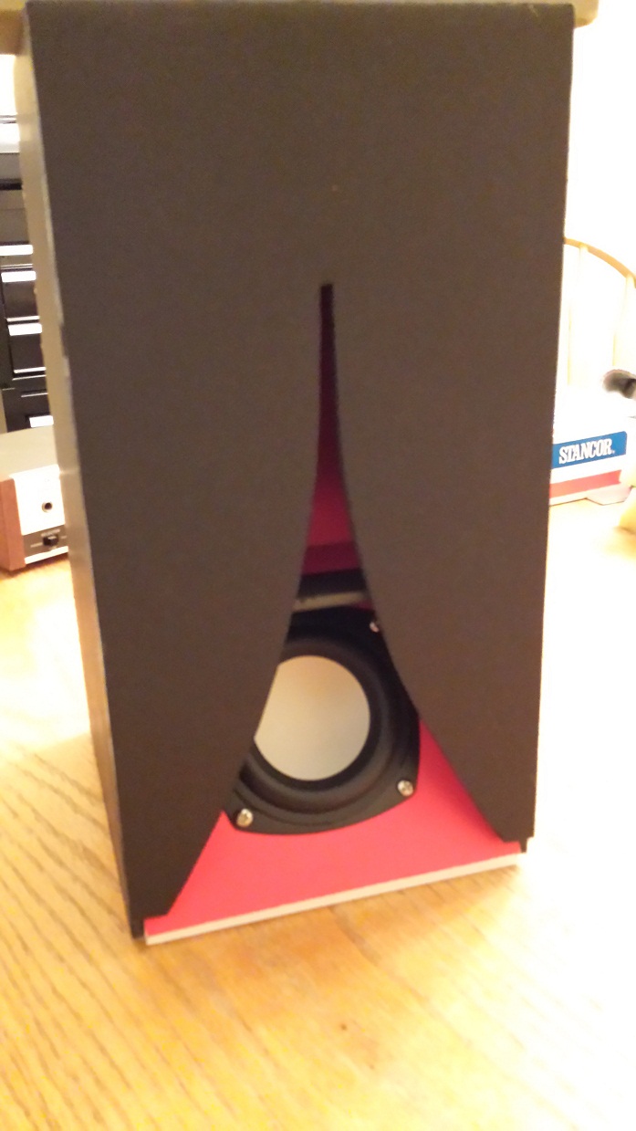

I started the first XKi W5-2143 of a pair this A.M.
Any directions with regard to the front aperture?
I saved a picture of your XKi build buts its at an angle, so difficult to get "close enough for government work" from looking at it.
Is the damping material used and its application the same as with the 0.53x Mini Karlsonater?
Thanks.

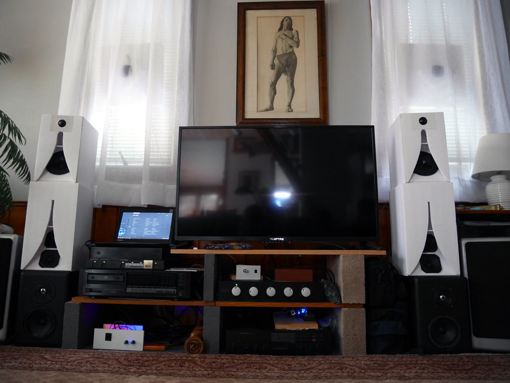

So I have be listening to my foamboard 0.4 Karlsonators with Aura NS3-193-BA's since 2013 and I have to say that I really love them, there hooked up to my TV. I thought that it may be time to build a second pair, 0.53 dual's out of wood and I keep thinking in the back of my mind that I read somewhere, probably on this thread, that I may lose some of the magic by not using foamboard. Is there a post where someone compares foam to wood? What is the general consensus? Thanks.
Wood can sound great if you follow steps to line inside and front chamber with melamine foam and cover inside wall of aperture with foam core. It’s detailed in this thread - look for posts by myself and photos of the Jhofland cabinet getting prepped with foam.

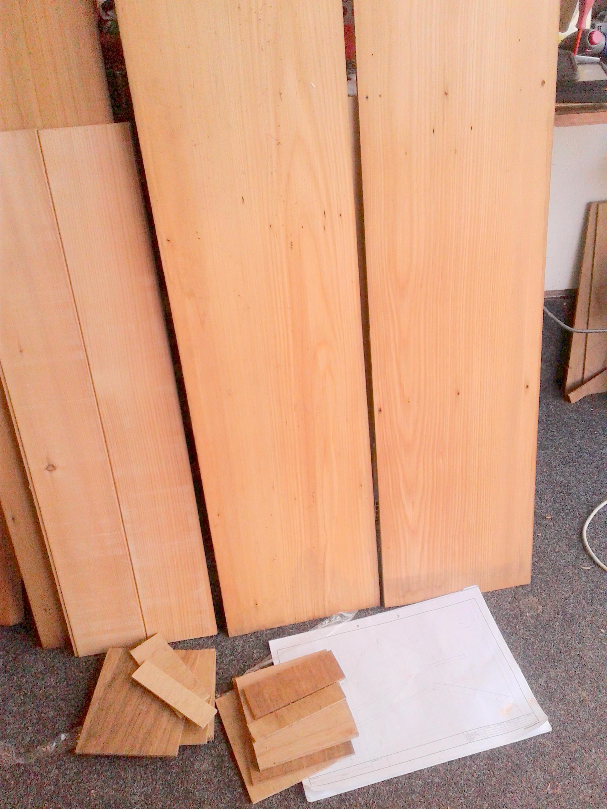

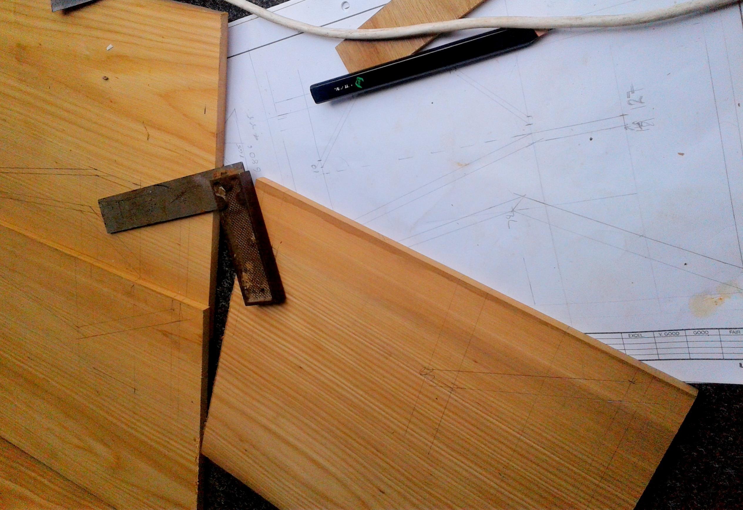

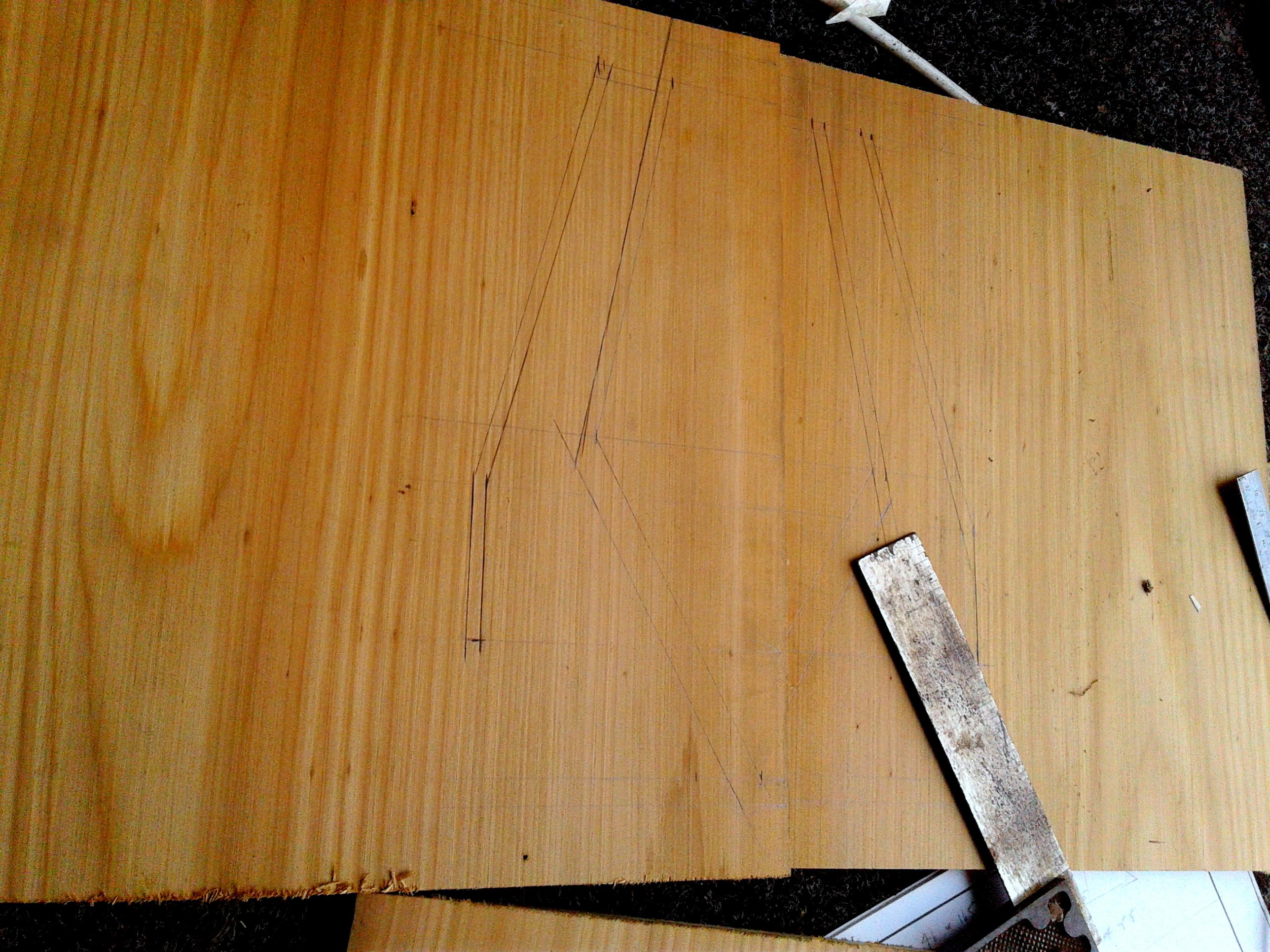

Made a start on a pair 0.4 Karlsonators,drew up scale drawing a few weeks ago and cut out inner workings from leftover scraps of Meranti marine ply .Raided wood rack and found some 12" wide 3/8" dressed Kauri sarking that came out of a 100+ year old villa when i cut a hole for a window ,machined it up perhaps 15 years ago so at least its well seasoned.Good use for it cutting thru nail lines so only odd scrim tack hole will show.
Cut sides rough to length and marked out the inner rebates so baffles set a few mm into each side still deciding whether or not to make them "corner" cabinets,will do rebating then decide
