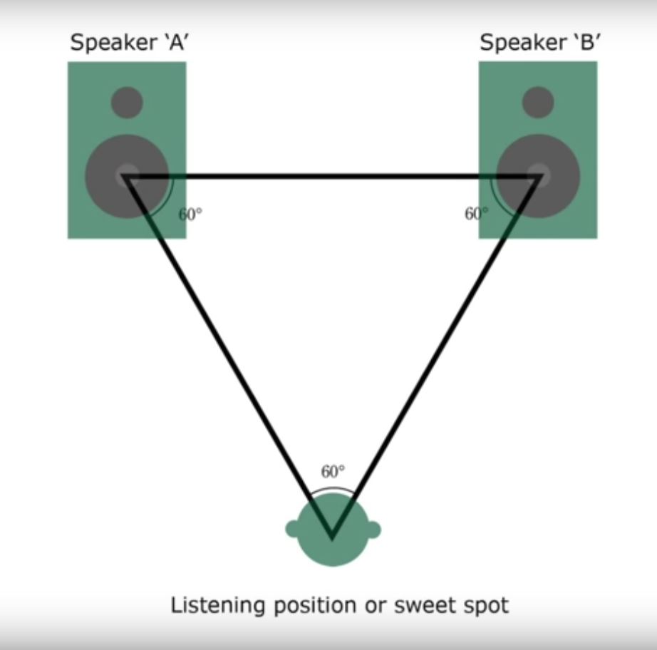

As some of you know, I have recently built a pair of 0.53x Karlsonators with dual 3FE25-16 FaitalPro drivers. The sound was very good when powered by my B1 buffer preamp + TDA7297 chip amp. I’ve enjoyed the speakers a lot until I completed and connected my Amp Camp Amps.
This is probably important info, so I’ll mention it here. I followed the advice of Paul McGowan of PS Audio to position the speakers away from the front wall so that an equilateral triangle is formed between me and the speakers. See picture below.
While the sound is even better than before (sometimes downright amazing), I can’t hear the speakers for the most part. On the majority of music tracks the sound is in-between the two speakers and slightly behind while there is hardly any sound coming from the speakers themselves. 😱
Have I wasted my money and time building these speakers, because now I can’t even hear them?

Yes, these speakers have beautiful imaging and allow perception of a soundstage much wider than their placement. I have had same experience with disappearing act. This has a lot to do with phase coherence. SE Class A amps do this very well.
I totally agree with you, X. And I think these speakers are a very good match for ACA. OTOH, if someone listens to them with lesser amplifiers, they are really missing out. Just my humble opinion. 😛
