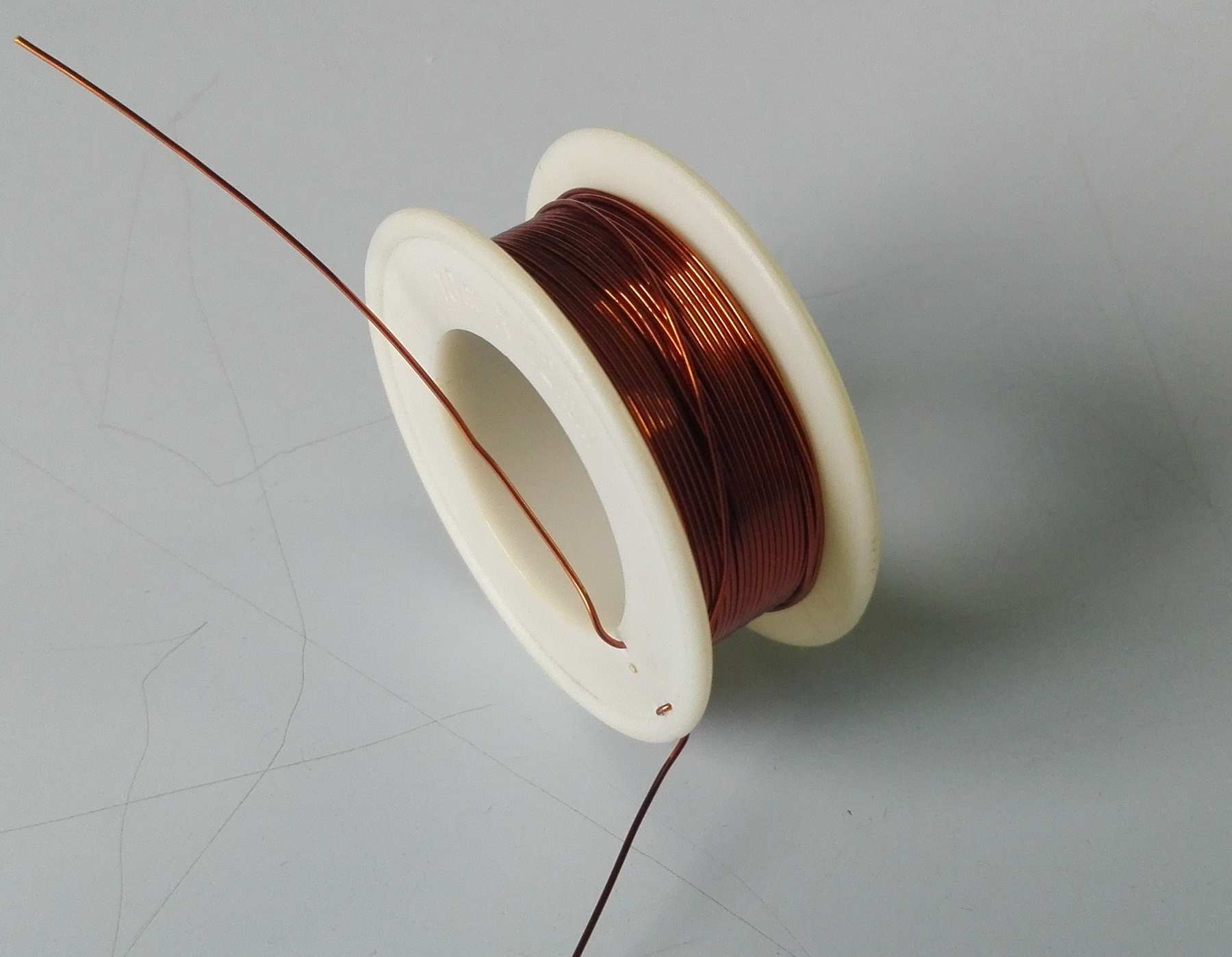

Today I wound a 0.9mH inductor and connected a 5 Ohm resistor in parallel (2x 10 Ohms paralled). This circuit was connected in series on the + line of one Karlsonator speaker to my TDA7297 amp and it damaged the channel on the amp instantly.
Now the channel just hums. Any idea why? I've read that these chip amps are delicate, but this is ridiculous.

PS Image below of 0.9mH inductor wound on a bobbin normally used for PTFE plumbing tape.

PS I've just realized that it's possible to wind 0.9mH chokes with lower resistance by using thicker wire. Hmm, that may be the way to get back some sensitivity!
I suspect that I only needed the BSC because I'm using dual 3FE25-16's. I've heard the sound of Single TC9FD 0.4X K's and it didn't have the same problem.
Yes, and it is ok to wind thick 18 ga wire on a ferrite core or toroid. Will only take about 15 turns probably around a 1in dia toroidal choke. The ferrite will substantially reduce the length of wire. Actually, if using ferrite, your wire length is reduced so DCR may go down quite a bit. You must have an LCR meter? You don't have to worry about saturation distortion too much as the currents are relatively low and it's all AC.

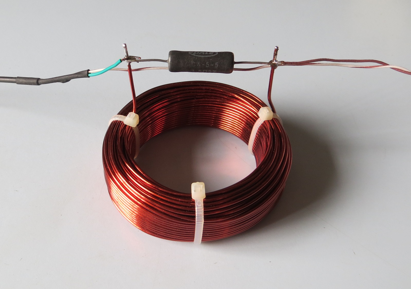

The addition of BSC's completely transformed the dual 3FE25-16Ohm 0.53X Karlsonators. The sound is now much more 'mature' and extra bass appeared out of nowhere. I'm so chuffed with them now, I can't stop listening, and without any sign of ear fatigue. The painful ear syndrome is gone and I'm enjoying room filling sweet sound with plenty bass. Before I added the BSC's, a sub woofer was used to augment bass, but it now stays switched off.
Pictured below is the final version of the 0.9mH choke that I made on a 50mm former. I used this Air Core Inductor Calculator to design it: https://m0ukd.com/calculators/air-cored-inductor-calculator
That’s a very pro-looking air core. Jantzen couldn’t make a better one and it probably saved you a bundle.
