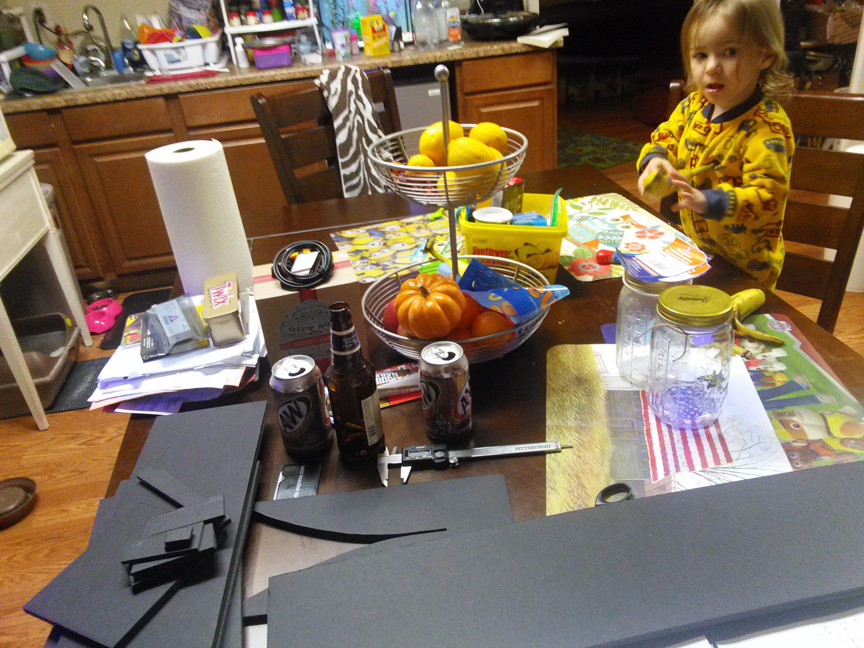

Well, finally got around to starting on a pair of foamcore speakers. Doing the vifa in a pair of the 0.4x. The only boards I could find that weren't mangled were black, and a single sheet of white, so black it is. Cutting went pretty easy, but there sure is a bit of a learning curve getting the whole thing folded and glued, and the lo-temp hot glue gun we have didn't help things... They are glued and drying as we speak.
As you can see my son couldn't resist being right there while I was doing it 😀

I love how they are made on a kitchen table with kids nearby rather than in a secluded dusty woodshop. Black looks nice really.
I second that X. I am sure he will grow up into a careful audiophile after watching his father work at it ;-)
You gotta get to them before their mothers put other ideas in their heads! 😉
Black looks nice! I also had a little helper making mine at the kitchen table 🙂 She gave up after burning herself on the glue gun a couple of times and decided that drawing was more for her (shes 6 by the way, i wouldnt let a 3 year old hold the glue gun!).
They're great for the kids room too, they can color them before you put in the drivers 🙂 Another point for foamcore...

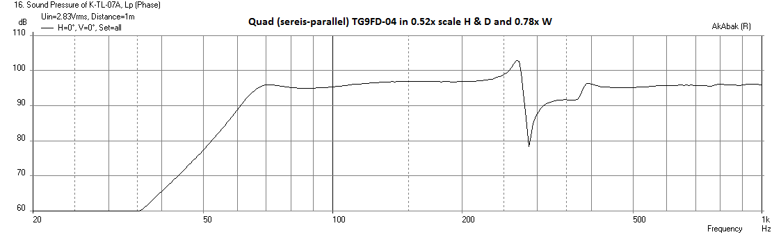

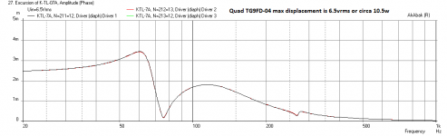

Quad TG9FD-04 Karlsonator
I ran some quick sims and it looks like a quad TG9FD could be really interesting. Not the deepest bass extension, but is a bonafide 96dB at 2.83v speaker with about 75Hz tuning (62Hz F3) for rich full bass. This could work very well for fleawatt system. Max power is only about 10.5wrms (6.5vrms) before hitting xmax and gets about 104dB.
So dimensions ended up at a squat looking wide format box 0.52x scale in Height and Depth and 0.78x in Width. This works out to be a Square format box at 16in tall x 16in wide x 9in deep. Not the most attractive aspect ratio, but can be nice if you don't mind a "sound cube" concept.
Here is frequency response:

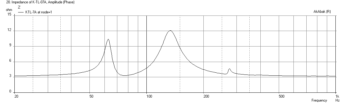

Here is Impedance:

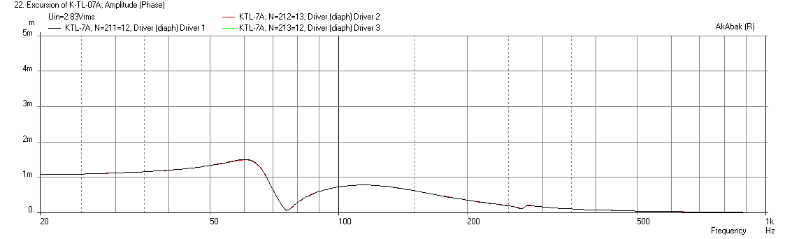

Here is Cone Displacement:

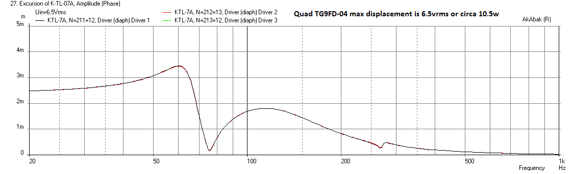

Here is Cone Displacement at xmax limtied max power of 10.5wrms (thermal max power is 5w x 4 or 20wrms):

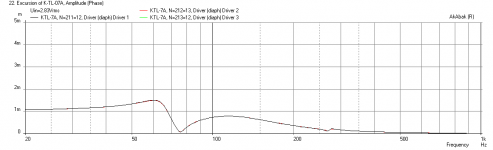

For normal music listening levels of 90dB at 1m, takes 1.5vrms and cone displacement max is only 0.8mm, so it is well within linear travel limts so will sound very clear and low distortion. With 14dB dynamic reserve from 90dB is a good thing. Should be a fine sounding quite compact speaker.

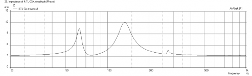

Here is Impedance:
