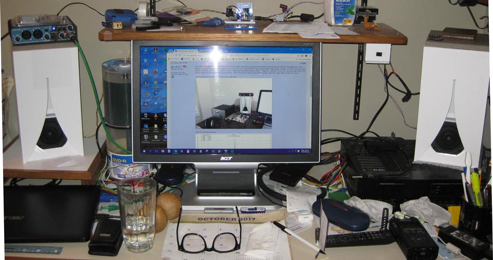

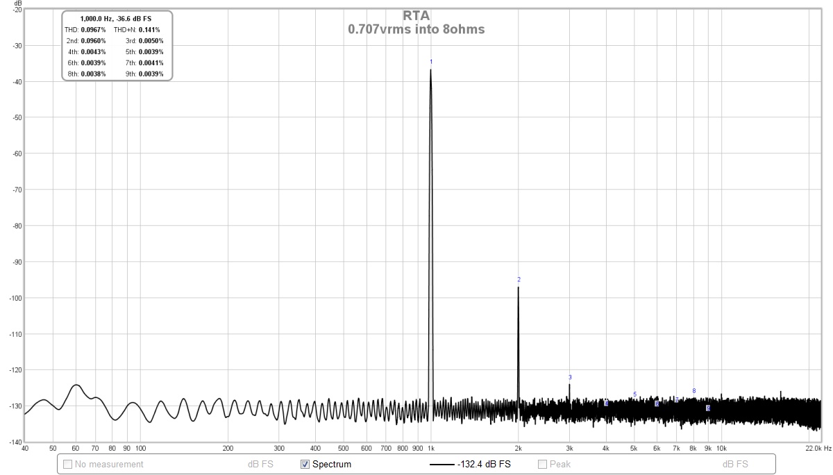

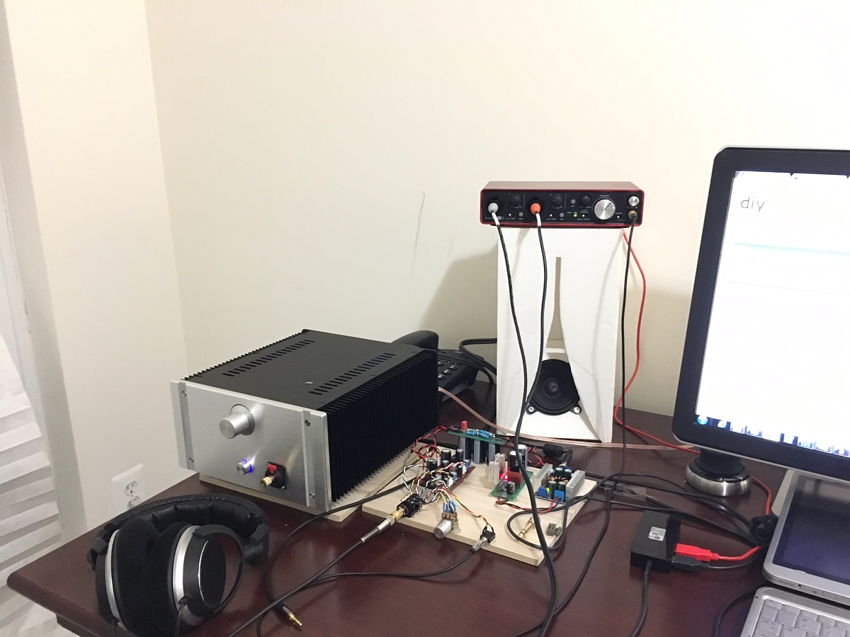

So I was listening to Gretchen Parlato on my 0.40x's (3FE25) powered by my Silicon Harmony SE Class A *headphone* amp, and it sounded just glorious. I was curious so I put my measurement rig in place with a 8w power resistor and the Focusrite 2i4 as the interface and here is the FFT I get in REW (at the same volume level I listen at - about 0.71vrms). So one look at the FFT shows that it is dominant second harmonic, with a tiny bit of third, and nothing else, and the noise floor is flat and clean.
Silicon Harmony is the one in the case with fins:
707mV rms into 8ohms:

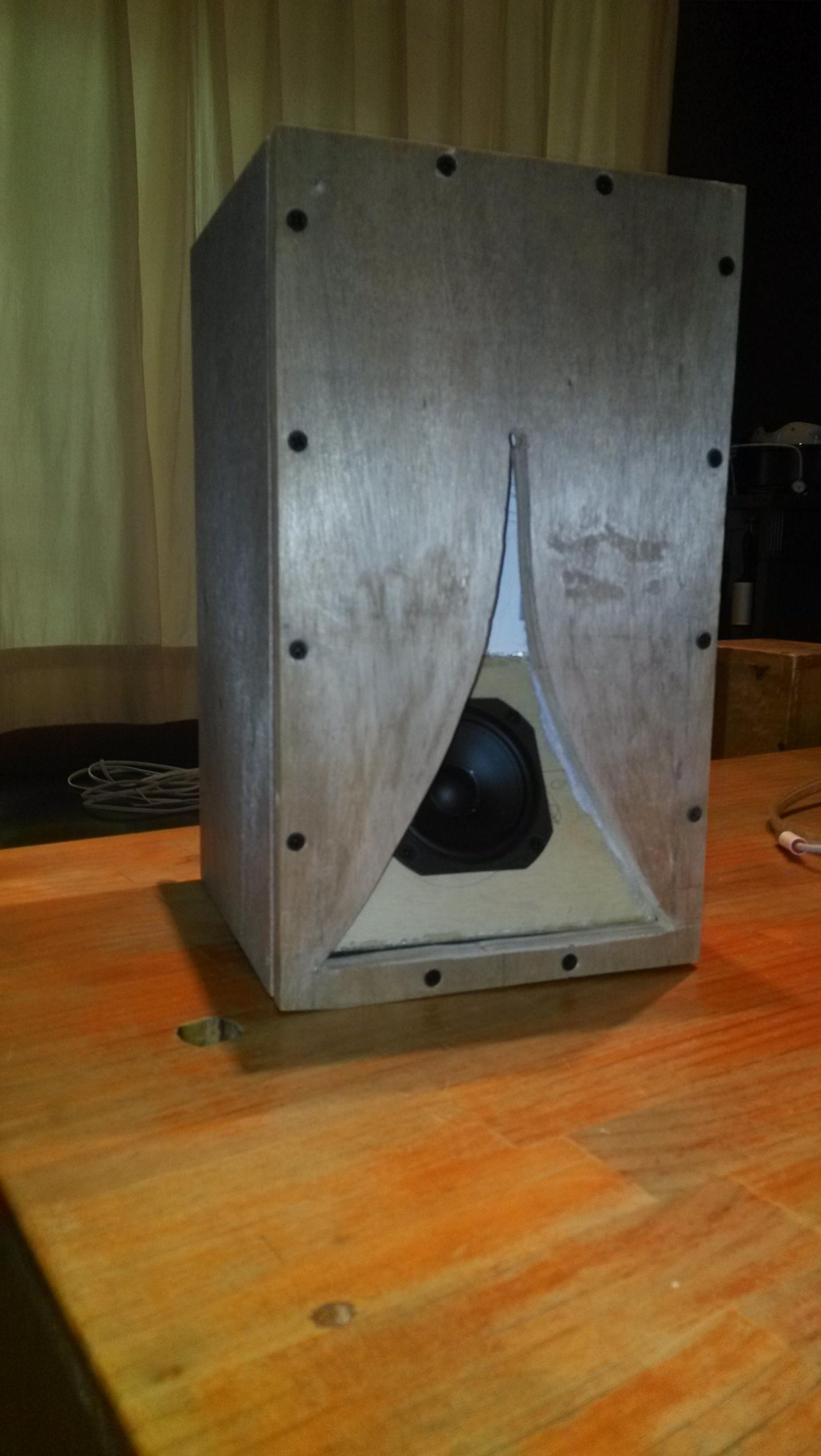

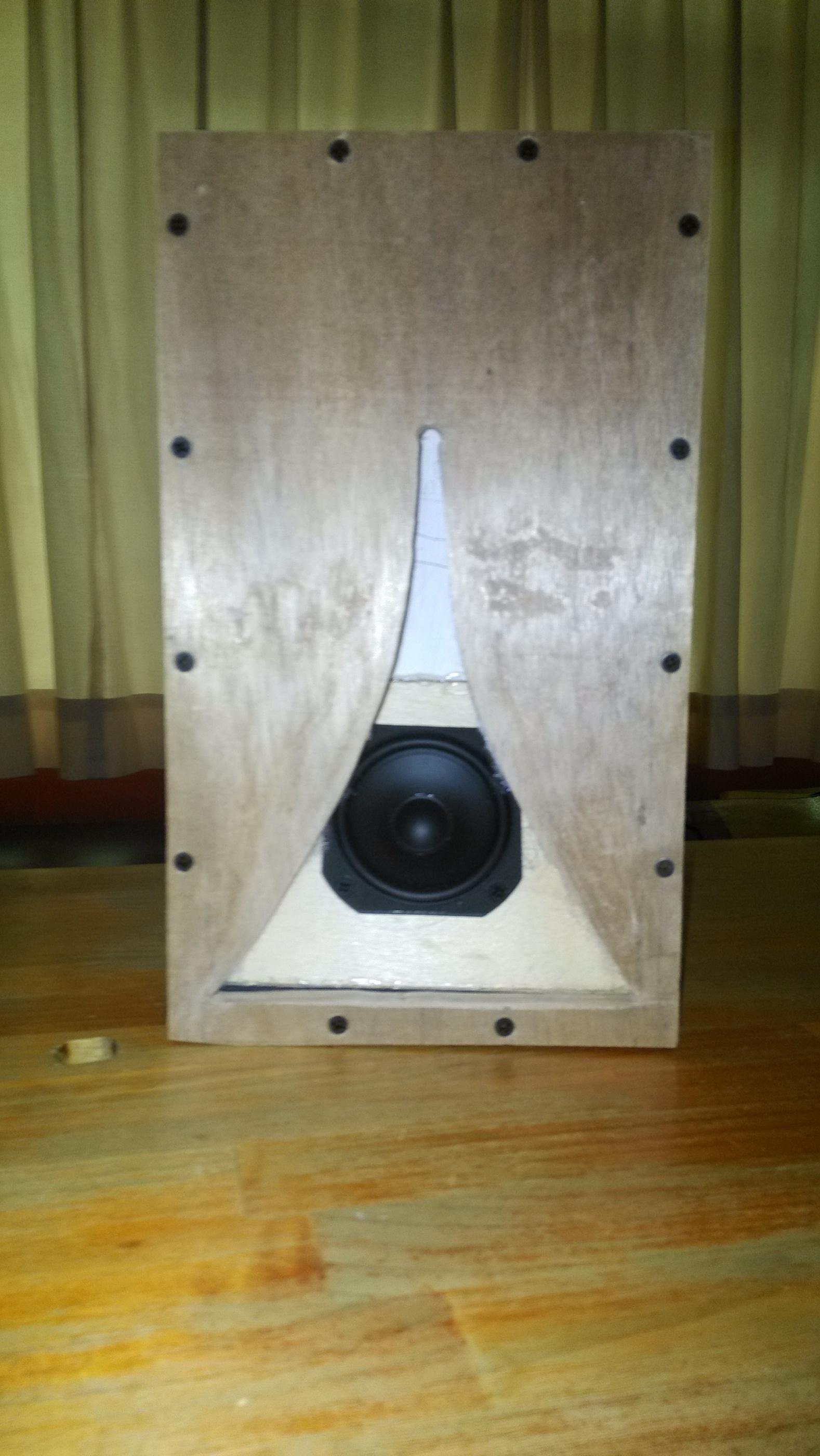

I see your aperture goes a lot higher than the one I have, following the sketches I found here for 0.4x. (unless I completely miscalculated it... which has been happening in the past! I'm far from fool-proof!)
Could it be the reason why I think it sounds boxy and muffled?

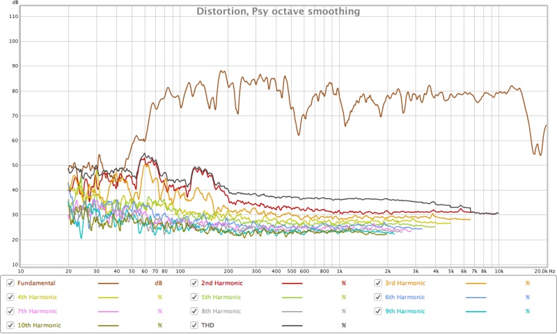

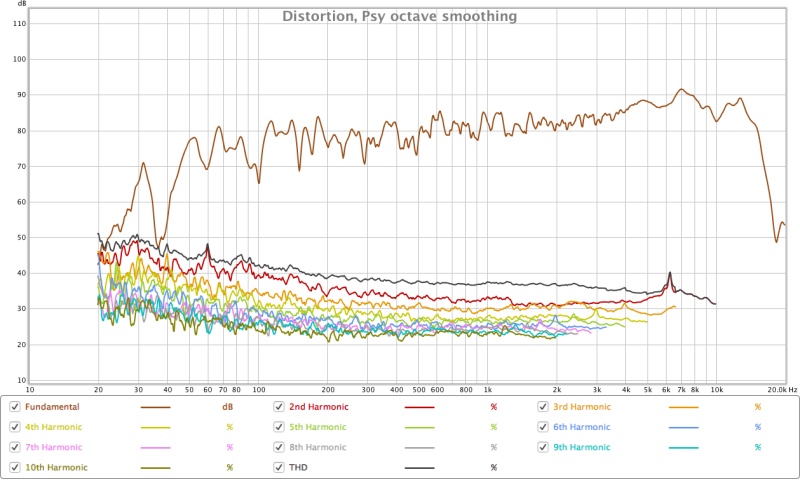

Here's the FR and distortion for the miniK I built.
Not super clean.
I include the TABAQ FR and distortion as comparison. It needs a BSC to bring the top end down, but as you can see, it still is as loud as a miniK 0.4, even when adding a BSC.
Not super clean.
That looks nice Perceval. If you can show us a straight frontal perspective so we can see how big the aperture is relative to the driver cone. The height mainly controls the bass extension and power and the width of the aperture controls the mids and HF transmission. Try to make the aperture big enough so that it intersects the driver surround as the curved wing profile crosses through the driver face. That should open it up - it is sensitive so maybe 5mm to 10mm more removed from the aperture should do the trick.
It looks like you may have some rattles/buzz on your box, are these two measurements same drive voltage and mic at same distance away?
Yes, forgot to mention... measurements were with the exact same setup, minutes apart with nothing touched besides swapping the speakers to place them at the same place, and moving the mic up and down a bit to be in front of the driver. Mic is at 1m.
I'll try opening the aperture a bit more, see if that takes care of the boxy sound.
You don't get that kind of distortion with your miniKs? I thought it might me the design, as nothing rattles in the box.
Thanks for trying it - it may just be that you really like the ambiance of the OB or an open faced speaker. Here was my measurement with a 3FE25 from a long time ago. I don't have the distortion data as it was long ago and my hard disk crashed since then and I lost a bunch of data.
So a thought just occurred to me. People who make this speaker out of foam core or cardboard seem to have a much better sound. It may be that wood is the culprit with the boxy sound. The foam core actually re-radiates some of the sound, possibly contributing to more passive radiation like a guitar body. Just a thought. If you have some cardboard - try making a quick and dirty one and see how it sounds. The foam core also seems to not have as much of an issue with the W notches you have with wood. Although Jim Shearer reported excellent results from his wooden 0.53x Karlsonator with dual TC9FDs earlier in the thread. I just notice both you and emuMannen reported closed boxy sound and both your builds are wood.

perceval- your box looks too wide to me for a 0.41X. the inside width is supposed to be 6". Mine seem much skinnier. They sound great. The K lens covers more of my speaker than yours does.
The inside is 165mm (6.6") as per the drawing.
It looks wider because the outer shell in made of 15mm plywood. I used 5mm plywood for the labyrinth inside.
Hi, for what it's worth, I build mine out of wood, 0.4x with one TC9. Not boxy at all, no funny resonances or terrible peak that I notice. The inside is lined pretty heavily with 8mm felt.
