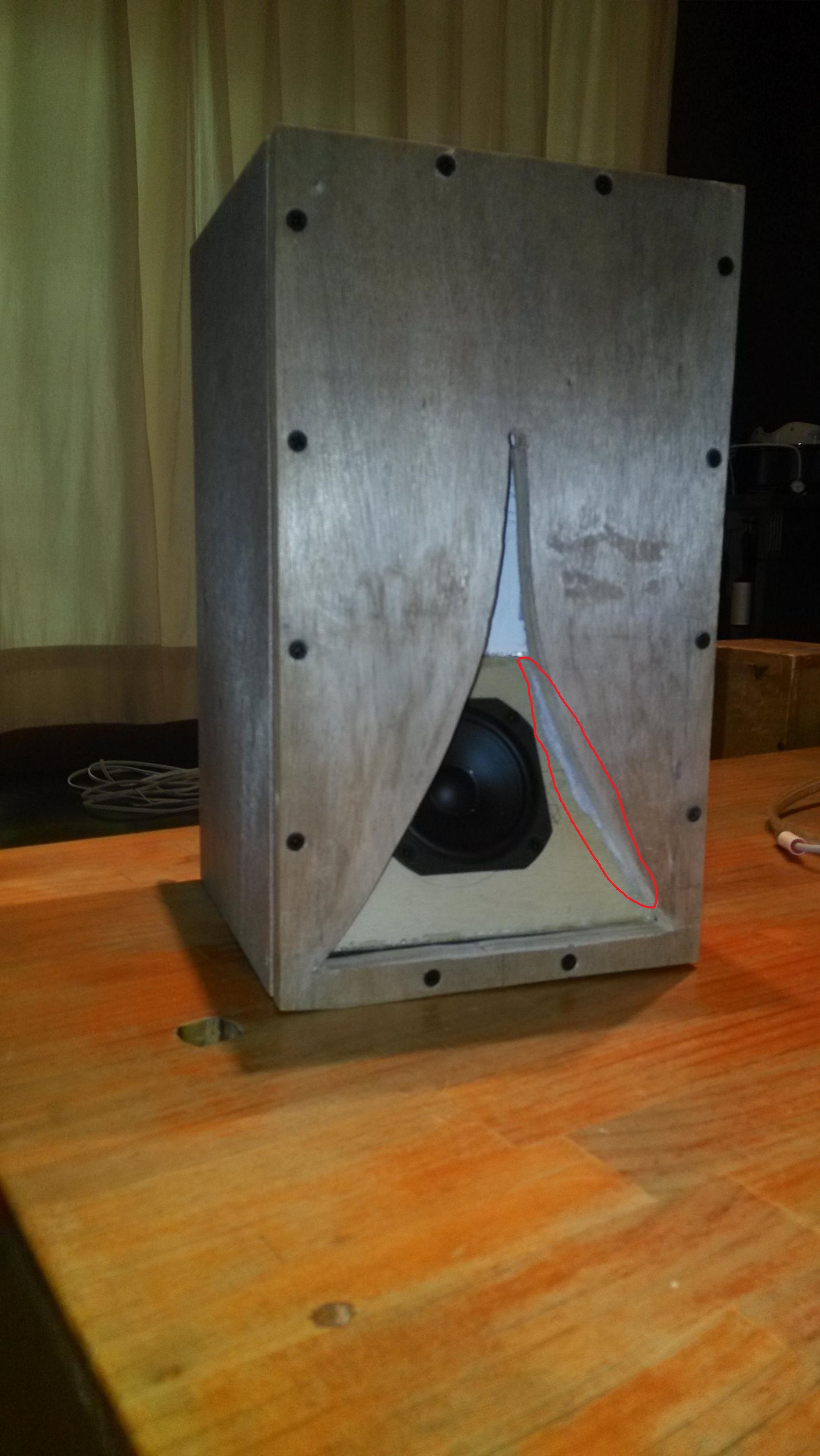

I cannot remember which reference I followed, but I lined the line behind the driver, the bottom and the top of the enclosure. Not the whole line. Did you line the backside of the K-aperture? Also, what kind of screw/method did you use to put the K-aperture in place? Thanks.
I see your aperture goes a lot higher than the one I have, following the sketches I found here for 0.4x. (unless I completely miscalculated it... which has been happening in the past! I'm far from fool-proof!)
Could it be the reason why I think it sounds boxy and muffled?
Perceval, it does look like your dimensions are not 100% correct - both the aperture and the aspect ratio of the box.
Your photo is not very hires, but there is something else that does look suspect and it seems there is some glue between the aperture and the driver baffle? Could be the photo, but it does look strange. I highlighted the area on the attached photo. Could you post a photo without the aperture? And how does it sound without the aperture?

I did not line the top / back wall of the enclosure, besides right behind the driver.
I put felt, as X mentioned, behind the aperture wings, at the height of the driver.
The aperture is locked in place with a foam gasket between the outside edge of the aperture and the enclosure, then screwed in place.

Inner box dimensions are exactly as the diagram mentioned: 300mm tall x 165mm deep x 165mm wide.
I also followed dimensions for the aperture. Maybe the outside dimensions appear much bigger because by using the 15mm plywood, it added 30mm all around

That is a little felt lining peeking out because of the angle of the shot.

Then all seems ok. Just trying to debug here. You should fall off your chair when you first hear this speaker. Not sure why yours is not behaving so well?
I suspect it is the wood vs foam core effect here. Hmm....
Most people love this speaker and the 3 cases where they weren't impressed have all been wood builds.
I might add a warning on Post 1 that this speaker is best made with foam core for best sound. One easy compromise is to make a foam core cabinet but thin plywood and foam core aperture. That still sounds good.

Could be the stuffing, I'll play with that.
Could be like X mentioned, the foam core dissipates some of the boxiness away, while the harder wood keeps it inside.

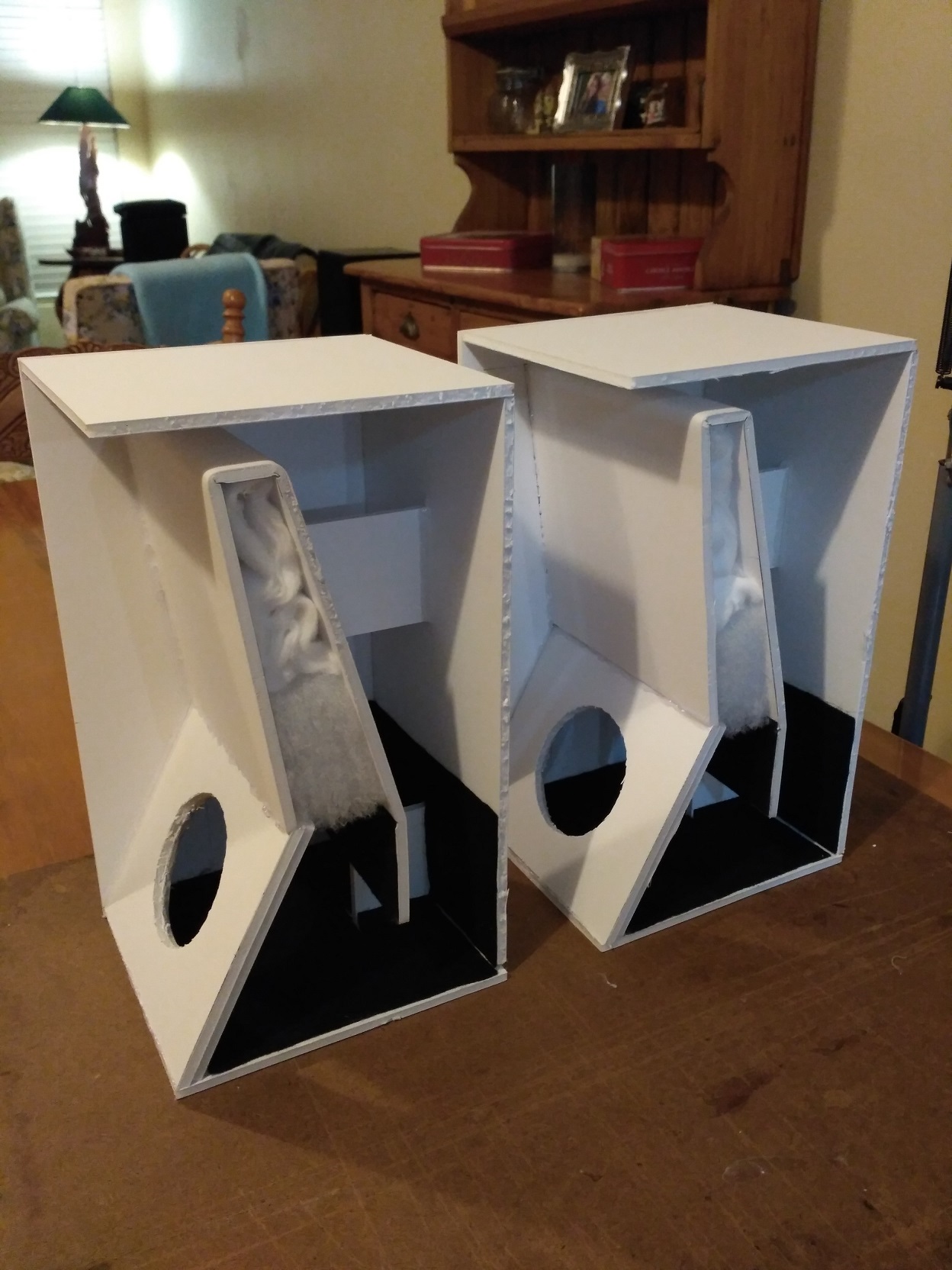

I wonder if you don't perhaps have too much stuffing? Here is a photo of mine. I only lined the sections behind the driver with thin black felt (2mm) - only bottom and back, not against the sides. Then some cotton wool in the upper section of the "whatever you call that section behind the driver baffle". Then very light pillow stuffing in the bottom half of that whatever section. I have nothing at the back of the apertures. Hope it helps.
PS: If you use wood you might need even less stuffing or lining?
twocents- My stuffing routine is similar to yours except I also stuff the chamber where the driver is and a small amount at the bottom of the rear. Some also use open cell foam where your black felt is. I've tried that as well.

If it would not be too much trouble, could you please build a quick and dirty foam core 0.40x Karlsonator and re-evaluate with TC9FD? I would love to get to the bottom of this sound quality discrepancy that I seem to be seeing a trend with folks who build all-wood implementations. Since you did the hard work of making an all wood one already, you are a natural for trying the foam core. I will give you some incentive to do this, please see PM 🙂
