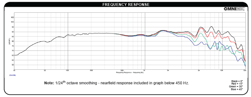

The dual TC9FD is quite impressive sounding, but lacks a little Sd compared to a W5-2143. If you are sensitive to peaks and like smooth drivers, the MA A10P may not be your cup of tea (called a 6in driver but Sd is smaller than Tang Band 5in driver).
Here is an A10P frequency response. It is plotted on a insane scale (-10dB to +110dB scale to reduce the visual impact of such peaks), but those peaks are of order 6-8dB at 4khz and 6kHz.

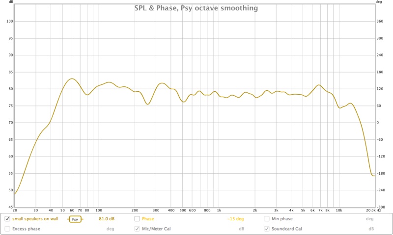

Here's the latest, using an iPad and the treble reducer EQ setting, but could be done easily with a small BSC circuit of 1mH and 8 Ohms in parallel.
The TABAQs are on a wall to help the bass get that curve... off the wall, the 60-ish Hz range drops by 3dB.
A Tabaq is a long mass loaded TL design and sounds very balanced when appropriate BSC circuit is used. However it has low efficiency due to BSC and no real bass gain. The Karlsonator on the other hand actually has enough bass gain to compensate for the -5dB falloff of the baffle step loss. Thus, no BSC is needed or used. So for comparison, a Tabaq with a 91dB 3FE25 will lose -5dB in sensitivity due to BSC so has about 86dB down at 80Hz. Whereas the 0.40 Karlsonator will maintain about 90dB down to 80Hz - enough to give it a rich sound. The Tabaq digs deep though maybe 55Hz - but is softer. When used with a less sensitive driver like a TC9FD, Tabaq will be 81dB sensitivity.

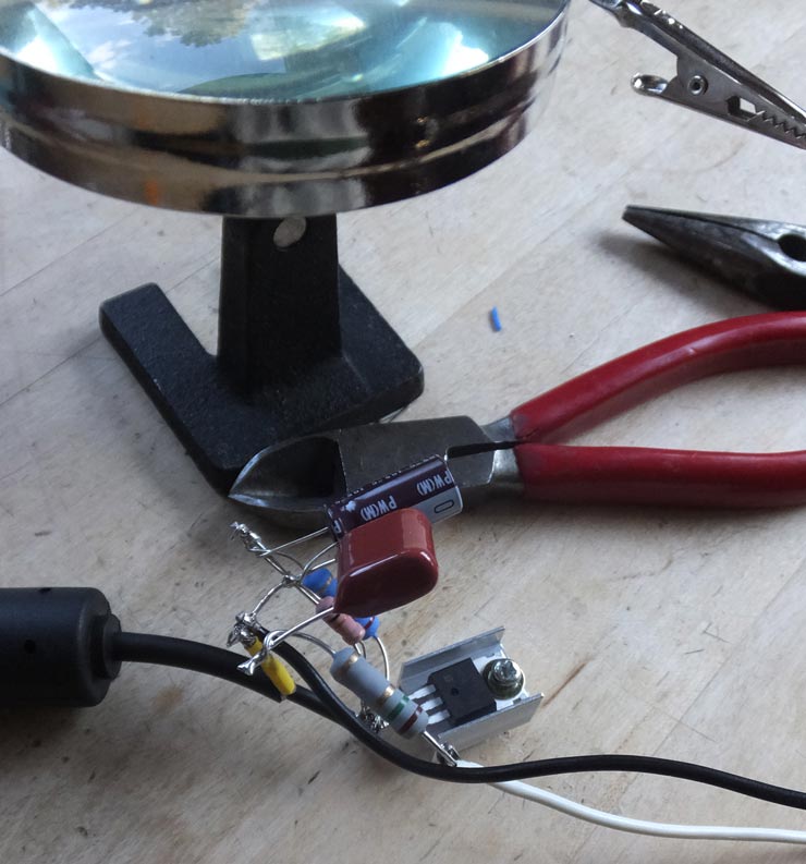

xrk971- I finally got the parts and assembled Juma's Easy Peasy Cap Multiplier. My hands were shaking through the whole soldering process. Luckily none of the delicate parts smoked. I'm running an HP 130 watt 19V laptop SMPS into the cap multiplier into a TDA7297 into MK 0.41X's w/ TC9FD18's. Like you said it would, the bass has improved. It's actually hard to believe the sound that is coming out of a few dollars worth of parts and 3.5" speakers. Just listened to Jaco playing on Joni Mitchell's version of Goodbye Pork Pie Hat; it was a visceral, life affirming experience and I was grinning like a kid with an ice cream cone. Two cones. You mentioned also a block of 20 or so 1000 uF cheap caps for added zest. Are they just wired in parallel? And then where do they go in the circuit exactly? Thanks again for the great guidance.

The cap array is all in parallel and goes in between the cap multiplier and the amp. Make a high current bus using solid core 12ga copper (Romex is good). Solder the 20 x 1000uF caps to the thick bus. Connect amp power leads to the bus via 16ga to 18ga copper stranded wire. The cap multiplier is needed to reduce any hum from mains. If you did not have hum then not needed. But cap Mx also provides a gradual ramp up soft start so no speaker pop from turn on.
The cap array allows use of cheap caps with typical 60mOhm ESR. 60mOhm/20 is now a 3mOhm cap ESR. That acts as essentially an infinite reservoir of charge (for a short period) so that the output transistors are never current starved. Bass impact goes way up.
You can also buy the Folsom TDA7297 PCB which has a built in cap array (Destroyer OS recommends use of Panasonic OSCON low ESR caps). So he uses fewer more expensive caps ($2ea x 10) vs my cheap bag of 50 for $3 from Aliexpress.
