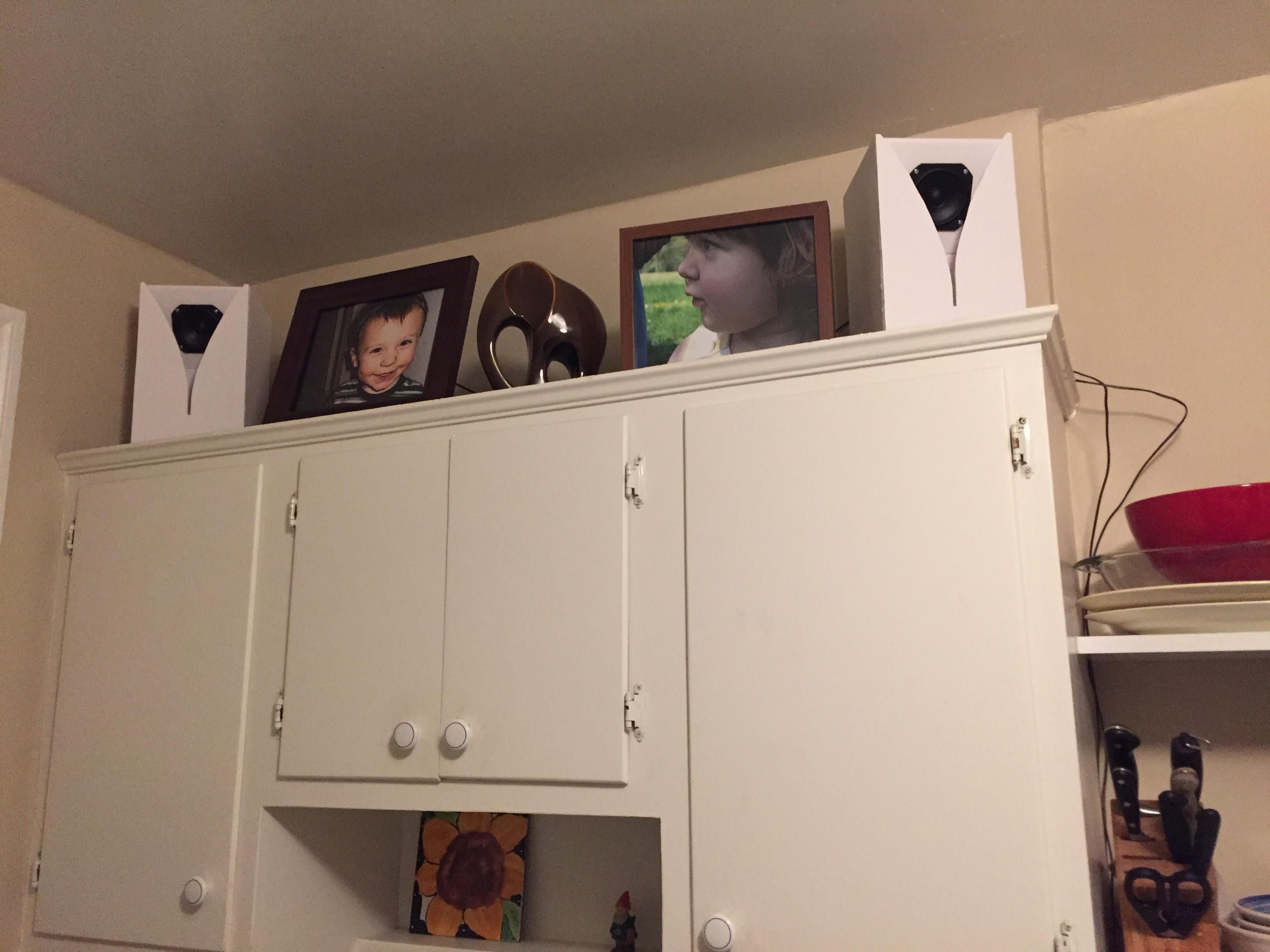

Love this thread and all the possible variants. I really enjoy my 0.4 TC9FDs in my kitchen.
Has anyone made a small sub to pair with these passively?
I understand it would be simpler to add any kind of sub with its own amp, but I was thinking it would be great (in my application, above my kitchen cabinets) to have a small foamcore or XPS passive sub to tie in with the little Karlsonators. Maybe 2 low profile MLTLs to lay between the TC9s...?
Just tossing out ideas to eek out a little more low end without getting big.
