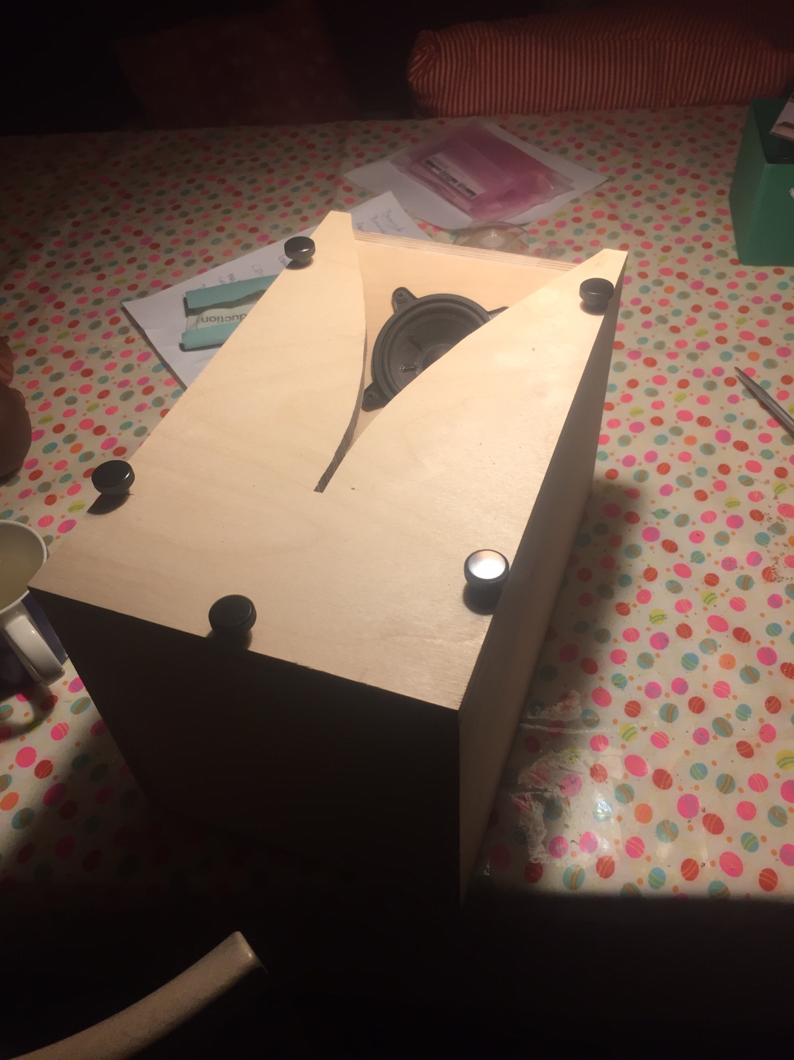

Finally finished my 0,4x with faital pro 3fe25. Impression to come.

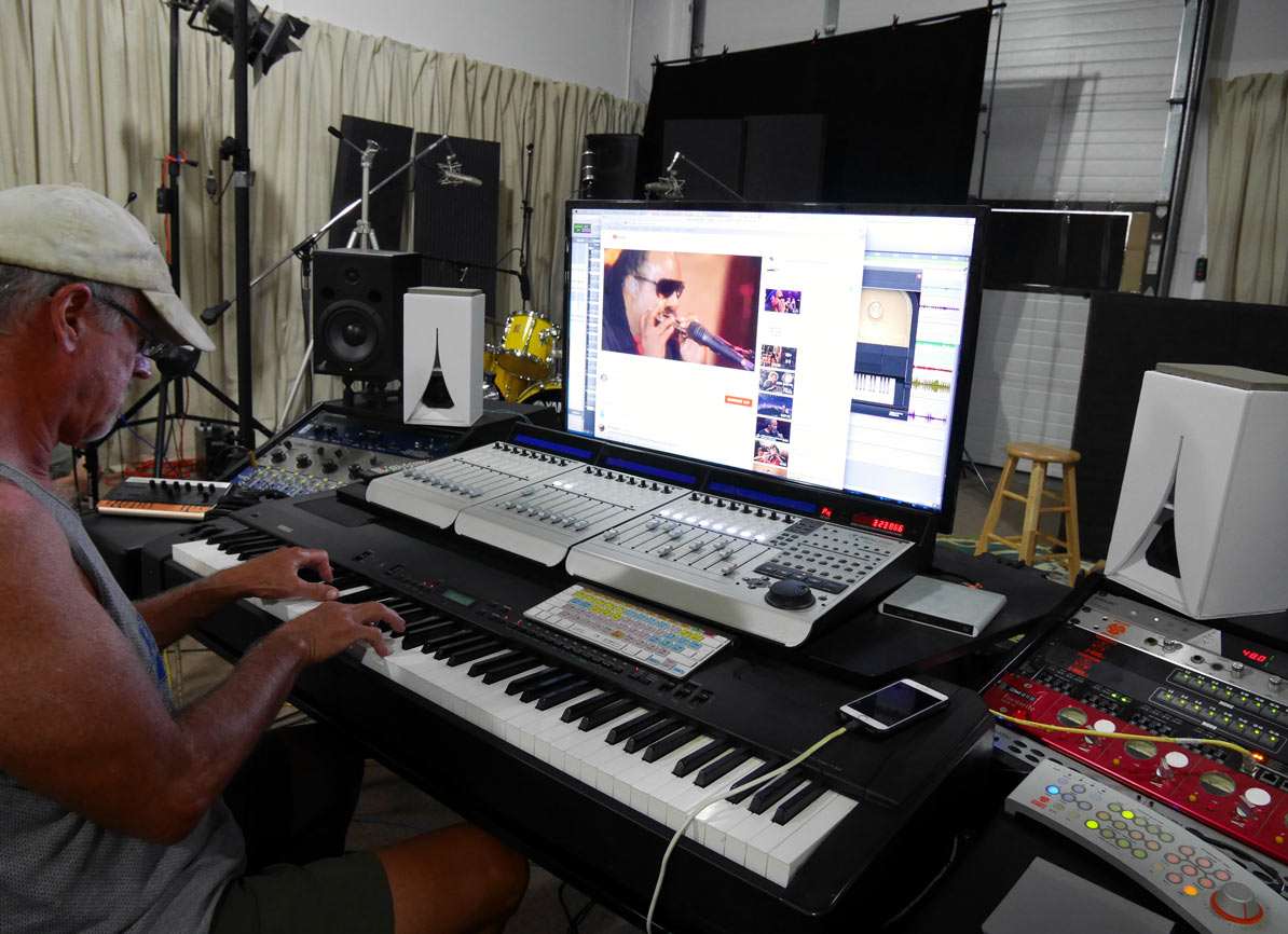

MK 0.41X in studio
Here's an update on the MK 0.41X's that I built for my buddy's studio. They were installed about three weeks ago. To my ears they are miles ahead of the Event monitors that are already there, especially for mixing purposes. They won't play as loud, but I prefer less levels anyway to combat ear fatigue. The studio owner's initial comment "wow, they are really bassy" which I suppose is true considering their size. But they do not produce a bloated bass. He subsequently used them to check a mix and was very impressed. The real plus is that the midrange on the MK's is very clean and easy to differentiate instruments. On the Events it's just a big hodgepodge mush of guitars, keys, vocals, drums and cymbals that make it torture (for me anyway) to get a good mix. There is a ceramic tile on each MK to weigh it down (helps with the upper bass region ~125Hz) as well as a second front wing on each (liquid nailed onto the original wing) for the same reason. These are a second set; the first set I use daily at my computer for hours on end, going on two months now. I haven't listened to music this much in years. They are totally enjoyable. I am about to embark on a set of 0.53X with the Dayton 5" PA full range to use in the main listening room; have them go head to head with a 20 year old scanspeak two way 🙂
