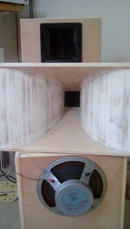

I realize it might look like it shouldn't work, but, it does, and sounds marvelous ! Mid range horn to tweeter @ 6kHz, down to mid bass @ 250Hz.
That was exactly my point: you are very happy with the sound, yet there are some aspects that clash with "common wisdom" on this forum. Not trying to say common wisdom is wrong, but maybe some atributes are overvalued. Example here being lobbing "should be" awful in this setup, yet you perceive none. I've also seen comments from very experienced users suggesting lobbing might be overrated. Another example was given on this thread before along the lines of conical horns sounding better than they measure.
Another aspect might be dispersion match at the xo point. I would imagine your AMT and horn have pretty differnt dispersion at 6kHz, right?

Mr. Lewinski, you raise an interesting question (and topic). The horn loaded ribbon tweeter is limited to 40 degrees vertical, and 70 degrees horizontal.
I'm not sure if it is clear from the picture, but the ribbon is angled down such that it fires directly at me, in my listening chair. Also, because of the very large size of the red horn, there is virtually no off axis response. I wouldn't know how to calculate it, but my guess is, the dispersion pattern of each @ 6K is more alike, than different. It sure sounds like it, anyway 🙂
Another aspect might be dispersion match at the xo point. I would imagine your AMT and horn have pretty different dispersion at 6kHz, right?

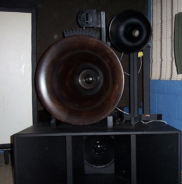

Greetings again Eldam. Always enjoy reading your posts. To clarify, the driver in the large red horn is the Tang Band w8-1772. The horn loaded ribbon is sourced from The Netherlands. Mid-bass is push-pull, slot load. Low bass is push-push plenum load. I'm seriously thinking about horn loading the mid-bass. After all, it was designed with the horn loaded concept in mind. Never quite done this way before, though, so it would be a first (as far as I know). The mid-bass slot is already quite dynamic, @ 100db/watt, but, I have a feeling horn loading this beast will be the icing on the cake. And, I do love cake 🙂

I think a big radial expo horn sounds great, I keep going back to them. They have a 3D live sound when setup right with lots of depth and great power response. This is with compression drivers though but what's nice is you get the controlled directivety of a conic horn plus the gain on the LF.
The lobbing is an issue and the closer you can get the mid and treble the better you are. If you sit in one spot and don't listen critically standing or laying on the couch it becomes less of an issue. Again, a radial horn can be made to have a short vertical profile and still deliver the goods.

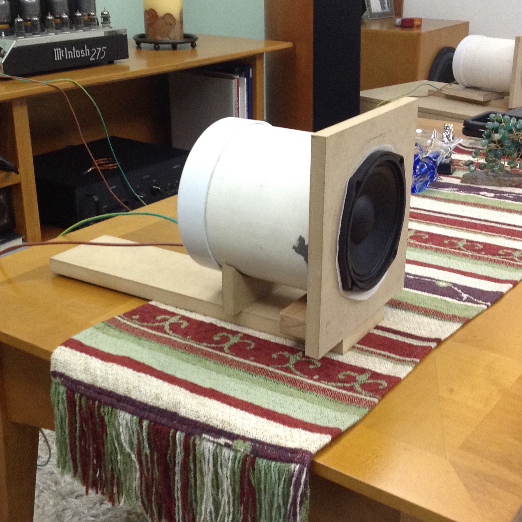

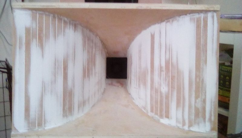

I started building something and got the rear chambers done. Built with 6" PVC pipe, lined with sonic barrier (to dampen vibrations), filled with fiberglass wool and 2" fiberglass panel on the back. One built as to annul the reactance, the other built longer so to try it per Scott's build (open back, stuffed). And I started breaking in the drivers yesterday. Initially sounded like crap. An hour later they were sounding good.
I'm hoping to cut the pieces for a rectangular tractrix out of foam today to try out will reduced effort 😱

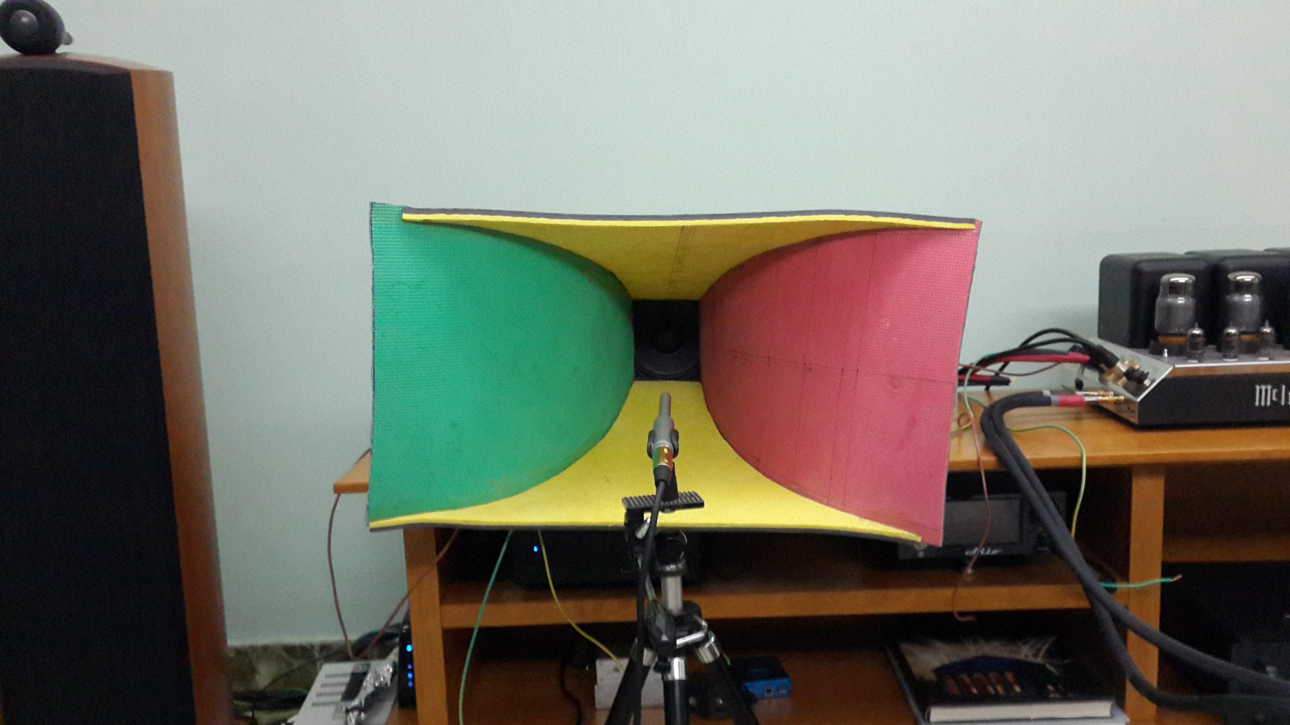

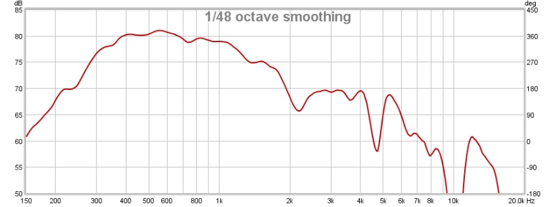

I built a rectangular tractrix based on Hornresp output, with 2:1 width:height aspect ratio. I did in with foam to make a quick an easy build...but looks aren't exactly tops 🙂

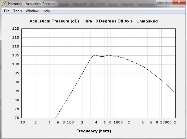

I took a quick measurement on-axis, at the mouth edge, FDW @ 10 cycles. While the loading at 350-400Hz is what I was shooting for, beyond 1100Hz is a bit underwhelming...I was hoping to cross this one over at 2500Hz...
Hornresp was predicting better performance above 1kHz - see attachment.
Feedback from experienced users, please?
