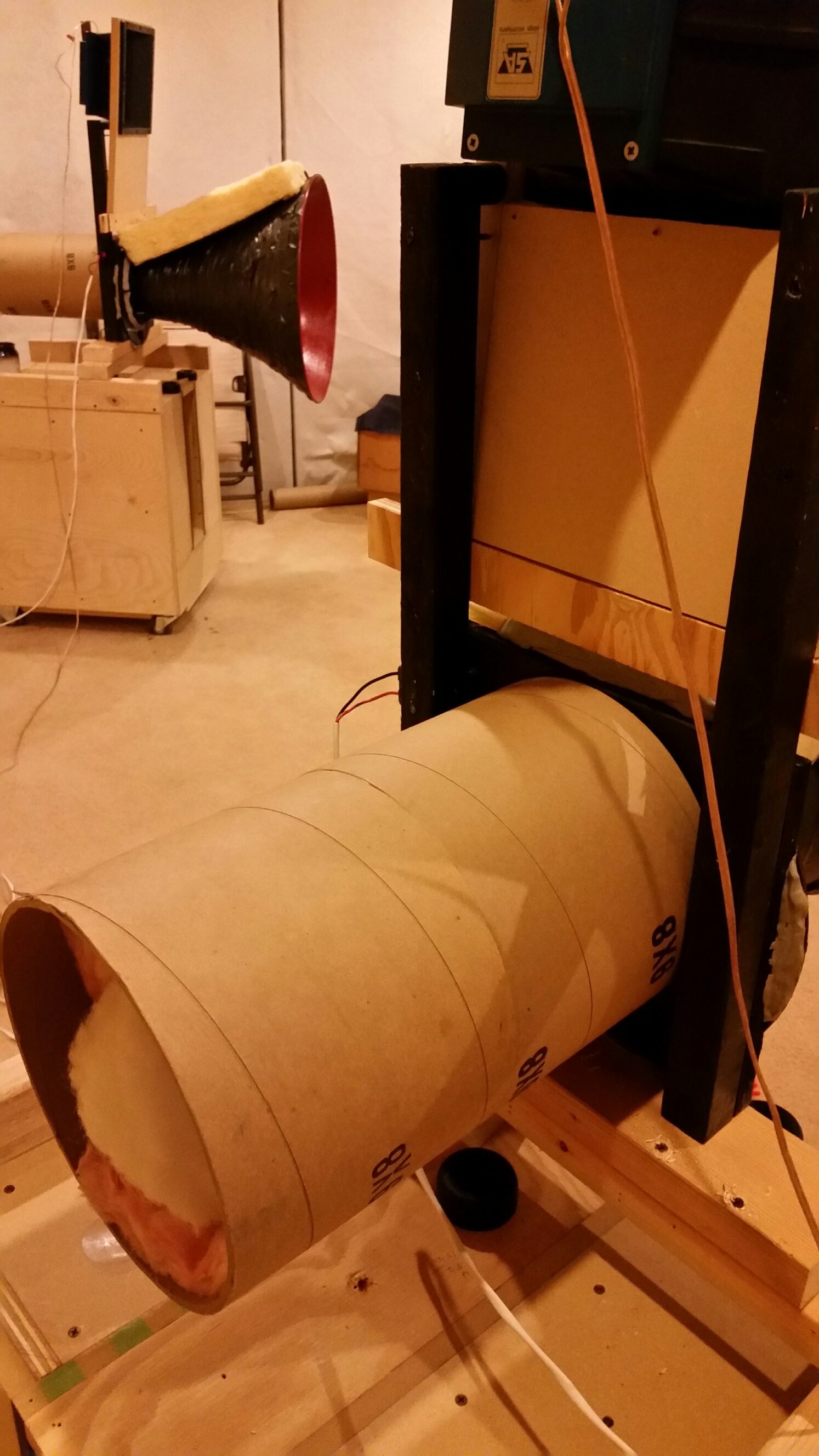

There are three ways to go with a straight axis horn. 1 ) Make the back chamber sealed.
That is what I'm going with. Thanks for the other clarifications.
Correct. For the time being my drafted system includes a pair of 10" woofers per side, each in its sealed box, running from 80Hz to the xo pint of the midrange horn, which as of now is 350/400Hz. Lately I've been further intrigued by replacing that with a midbass horn with its own driver, but let's not get into that here/now.As the topic of the thread is about constructing a mid-range horn I assume there would be some sort of bass cabinet used in addition to the system. It is my opinion in this case, that the speaker chamber for the mid horn should be sealed. An educated guess tells me the speaker chamber for the Faital driver is going to be quite small, so venting is not only unnecessary, but out of the question unless the vent is just a hole.
I am going with a sealed rear chamber. The rear chamber that sets the electrical impedance peak 10Hz above fc si 1.3 liter (or 79 cubic inches). Small indeed. I should have dummy chambers built out of 6" PVC pipes done this week. Lined with fiberglass.

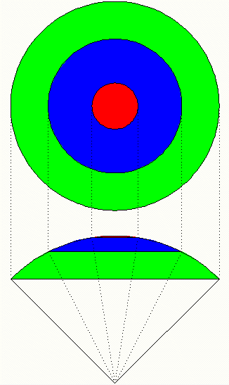

... to illustrate the spatial significance of an on-axis measurement on a round horn.

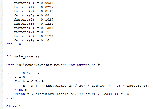

This is a routine I used to use, showing the weighting I applied to angular measurements from 0 to 90 degrees (for combining into a power response).a bad measurement at only one location is not the end of the world (I think this is what AllenB is getting at).
This is showing wider measurement angles being geometrically more significant, in that they represent a larger area of the wavefront.. On the other hand the wider angles may also show lower pressures so that the angle most representative of the nature of the power response is most likely an intermediate angle.

Checking that I understand / thinking 'out loud'
on-axis (the 0-10 degree region) is 0.00349 / 1 of the total area of the hemisphere
The 10-90 degree region is thus 1-0.00349 or 99.651% of the area of the hemisphere that a driver is firing into, hence matters a bunch (technical term) more than the on-axis
The power calculation is multiplying the area of each region by its relative SPL
They do. Diffraction effects are widely spread, but with a round horn they tend to focus when on axis, as may standing waves whereas a less regular shape may promote a wider but less intense focus. Fortunately, good optimum listening angles are found elsewhere with a round conical.Mind you, the conical horns sound better than they measure - <snip> It just happens to be the location spec sheets use most often.
Essentially. Looking back I may have used 0-5, then 5-15, 15-25 etc. At the time of that screen shot they were out by 0.4% but the point remains the same.
- on-axis (the 0-10 degree region) is 0.00349 / 1 of the total area of the hemisphere
- The 10-90 degree region is thus 1-0.00349 or 99.651% of the area of the hemisphere that a driver is firing into, hence matters a bunch (technical term) more than the on-axis
- The power calculation is multiplying the area of each region by its relative SPL
As for the power response yes that's correct, but also taking into account that power is 10*log(magnitude) and pressure is 20*log(magnitude).

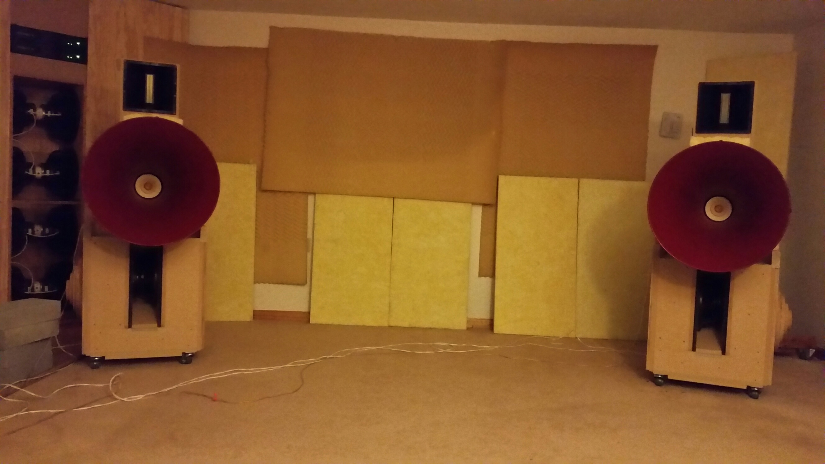

I realize it might look like it shouldn't work, but, it does, and sounds marvelous ! Mid range horn to tweeter @ 6kHz, down to mid bass @ 250Hz. I love this sound. The only thing I might try, is to horn loaded the mid bass slot exit. As far as lobbing is concerned, I don't hear any. Please note the acoustic "pillow" I have placed on top of the red horn to absorb any possible reflections from the tweeter, even though it is largely directional, I figured it couldn't hurt.

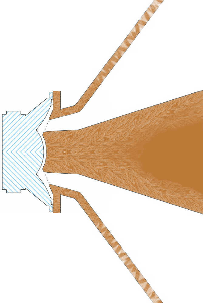

This was just a pic I found in a quick search, to illustrate the idea. I don't think you'd need to go that big. The horns I was using in the above link had 30*45cm mouths. I've extended them a little since then, but they are still light and petite compared to that multicell.
Here's another illustration of the TPL-on-huge-phase-plug idea (modified pic from centauriaudio.com.au). Only a little bit crazier than a normal big DIY horn 🙂
