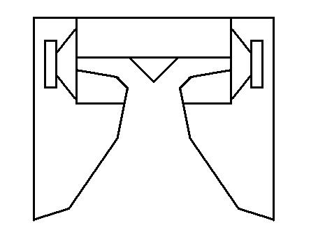

Not to derail this thread in any way, but my goals are somewhat similar to yours. My target response is ~80hz (not as critical but lower is better) up to 500hz (more critical). Length of horn is my enemy more than size of mouth (to a point). However, I'd rather not make too many shortcuts in proper designing.
Thus the solution I have been tinkering with is 2 12pe32's mounted on either side of the "throat" rather than the apex so that I can atleast avoid the additional length of the backchamber. The wasted space behind the shadow of the mouth fits the backchamber. I just need to figure out how to use hornresp for this, or akabak and play around and see what size I can live with.

That type of horn is modeled as an "offset horn" in Hornresp.Thus the solution I have been tinkering with is 2 12pe32's mounted on either side of the "throat" rather than the apex so that I can atleast avoid the additional length of the backchamber. I just need to figure out how to use hornresp for this, or akabak and play around and see what size I can live with.
80 Hz response will require around 3.5 feet (just over a meter) horn length, going with a combination ported/horn you could cut that length in half and still get plenty of 80 Hz response.

The drivers need to be as close as can be to the beginning of the horn in such a design. Maybe fig 11. can help you out getting there. http://patentimages.storage.googleapis.com/US7506721B2/US07506721-20090324-D00004.png

Two 12PE32 woofers per horn is a lot of output. A pair of Eminence Delta-Pro 8B will give you more than enough output and can be wired in parallel for a nominal 8 ohm load. I don't recommend an offset driver arrangement over the bandwidth you're looking for. A standard front loaded horn will have smoother frequency response and fewer phase issues. If you are looking to shorten the horn, then I would fold it like the attached graphic. I would not fold the horn like the linked image in Post #155. It leads to rougher frequency response.
Caused by the extra bend, just at the start of the throat?
