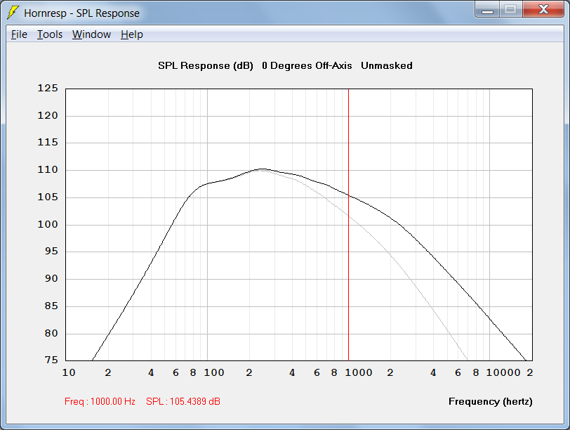

This tractrix horn seems to be alright. I've not really done anything with the back chamber or the throat area, but here is what I have so far:
Above 80Hz it's just over 106dB, and then as you can see on the graph it rises and falls to about 101dB at 1kHz...
Hornresp upper response assumes the cone acts as a piston.Above 80Hz it's just over 106dB, and then as you can see on the graph it rises and falls to about 101dB at 1kHz...
Actual response will be higher (with peaks) in the upper end.
The Alpha 8 Xmax is 3.2mm, not 5.
I've been trying to find a way of changing the Xmax in hornresp, but it doesn't seem to be available. What other values should I change to correct that?
Hi unaHm,
You are looking at the constant directivity (power) response. For finite single-segment horns you can use Tools > Directivity > Response to calculate the pressure response. The on-axis SPL at 1 kHz then rises to a little over 105 dB. The increase is due to directional "beaming" at higher frequencies. The pattern below shows the directivity at 1 kHz when radiating into a solid angle of 0.5 x Pi steradians, as given in your example.
Kind regards,
David

Hi unaHm,
Kind regards,
David

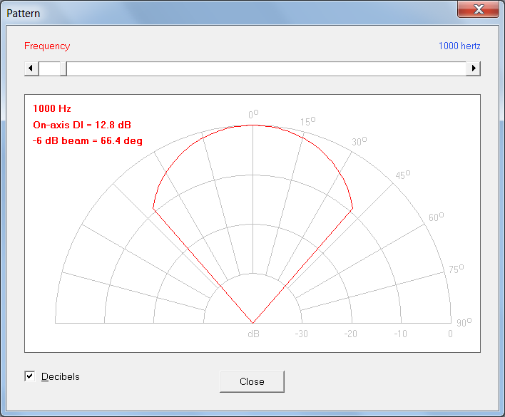

David,
Thanks for your response, and for HornResp! 🙂
Would you consider the beaming effect of this horn to be 'bad'?
