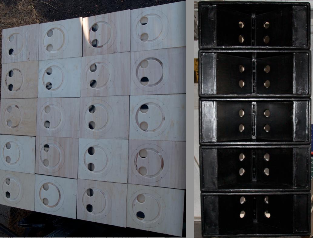

Art,
That's a very nice set of unity/synergy horns! 🙂

They are actually Paraline horns, Synergy and Unity horn throats are the size of the compression driver exit.Art,

Interesting. It's the first time outside of Patrick Bateman's threads that I've seen an implementation of the Paraline. Very cool!
