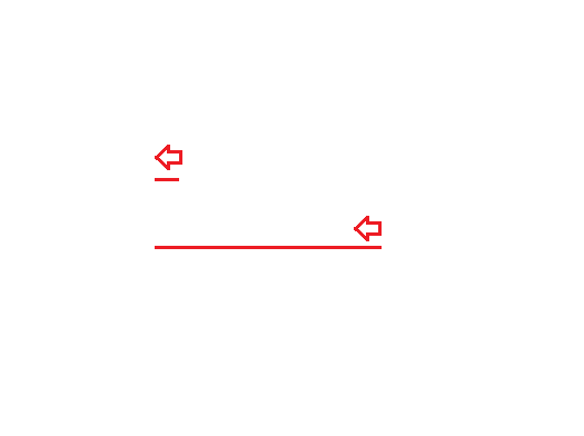

The reason for folding, for me at least is time alignment. Something like this:
That's not time aligned - you have to look at the path length down the middle 😕 of the folded horn IE the that line drawn is wrong
So it's not aprox. where the voice coils are at? As in Klipsch La Scala, woofer and midrange +- alligned, tweeter 15 inch forward misaligned?
Wikipedia's page on it seems to refer to the 'acoustic centre' of the speaker, rather than the voice coils themselves:
Wikipedia - Loudspeaker time alignment
With horns, would it be that the mouths are time aligned? From what I've read, the virtual 'point source' of each horn is meant to be the horn's mouth, so as long as those are on the same plane would that time alignment be correct?
Then again, a lot of the professional horn systems I've seen (on YouTube) are physically staggered, so that theory doesn't seem to pan out.

Pooh's post in #83 is correct in general, horn path length will determine "time of flight" from the diaphragm to the mouth.With horns, would it be that the mouths are time aligned? From what I've read, the virtual 'point source' of each horn is meant to be the horn's mouth, so as long as those are on the same plane would that time alignment be correct?
In addition, crossover poles add to the delay time, and LF generally is lagging HF, so measurement is required to determine actual time alignment.
Thanks, very helpfull, i could not find any info about folded basmid horns with regards of time alignment. I understand measurements will be needed to exactly time align. But having a good "design" in the first place will make this easier. So if i understand it correctly the woofer in a Klipsch la Scala is a bit behind the mid in time, due to extra path length?
@ Josh K, i am targeting 50 -500 Hz in a folded horn. I am a bit of topic hijjacker....Topicstarter unaHm wants to get as low as possible with a compression driver/ cone. 150Hz and up. Our "problems" look alike.
Yes, it is behind in time, but happens to be in phase at the crossover frequency.So if i understand it correctly the woofer in a Klipsch la Scala is a bit behind the mid in time, due to extra path length?
Since we tend to hear the first arrival as louder (Haas effect), the La Scala mid and high frequency tends to sound "forward" or "bright" (or "harsh") compared to a time aligned system.
I keep going until i get this 🙂
Horn B is 1 meter behind in time compared to horn A? Same length, only difference is the fold. Just for the argument, don't mind the paint skills. Or extreme bends in B.
Assuming "B" was the same 150 centimeter path length as "A" (looks about 30 cm longer to me) when placed one meter behind "A" it would lag by about 2.88 milliseconds in time, the time it takes for sound to travel one meter (assuming 1130 feet per second and my math is correct 🙂 )I keep going until i get this 🙂
One meter is the wavelength of about 348 Hz, so it would be possible to be "in phase", but lagging by one wavelength at a crossover of that frequency.
Without using a digital delay, to time align "A" and "B", the mouths should be aligned, assuming the acoustical path length is the same.
That said, depending on horn design, the apparent acoustical source can vary with frequency, so one would need to choose the frequency that time alignment was most critical for the application.
