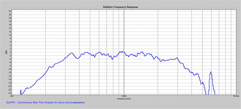

The mid horn is around 30 inches long, the back chambers are best tuned with a resistor, volt meter and signal generator - start big and add mass inside the chamber to the flare frequency - 10 percent. read Edgar's article on reactance annulling, I go 10 percent lower then he does - http://volvotreter.de/downloads/Edgar-Monolith-Horn.pdf
A good cone like the B&C will have lower IM distortion then a compression driver. It is critical to align the voice coil with the bass and treble drivers. acone normally will have better tone and when aligned properly will have a bit more realism for strings and brass.

Not really this is at 5 feet in room no back chamber, factory phase plug, no eq or crossover driven by PP 6BQ5. The back chamber brings the bottom up a bit but it sounds better without one 1/48 th smoothing - sounds very real
