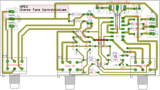

Dear sir,
I am planning to build this tone control pcb. I wanted ask you where can i put volume control pot? at the input or at the output of the tone control? and what is the value of the volume control pot ? I would be using the 10k pot version of your pcb given elsewhere in the thread.
regards
prasi
Use 10k pot at the output of the circuit.

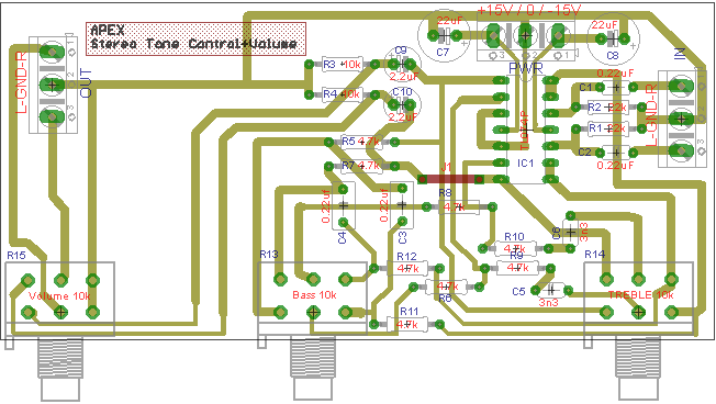

Dear Mile sir,
I attaching your stereo tone control pcb with 10k pots for bass and treble and also including the volume control pot. can you please check it and tell me if there are any errors?
regards
prasi
Yes it is ok this time, regards

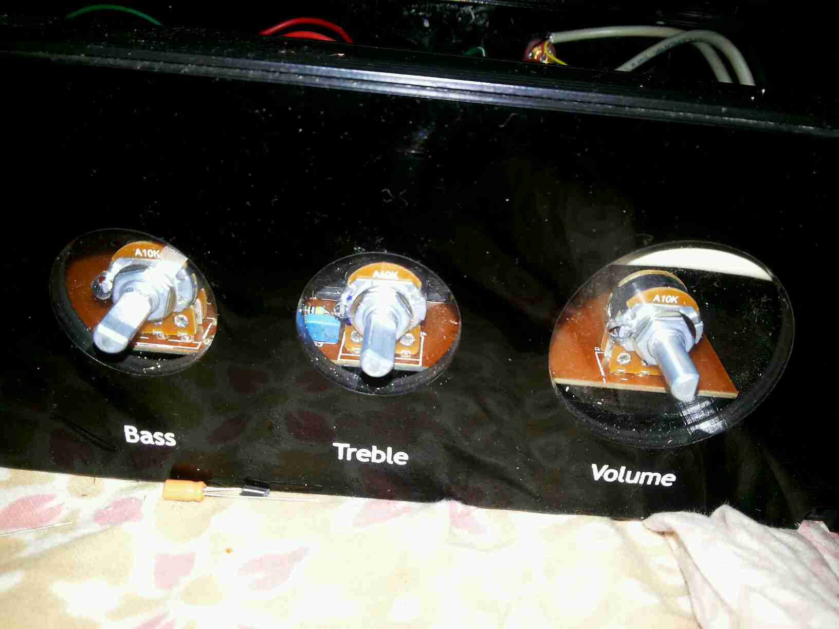

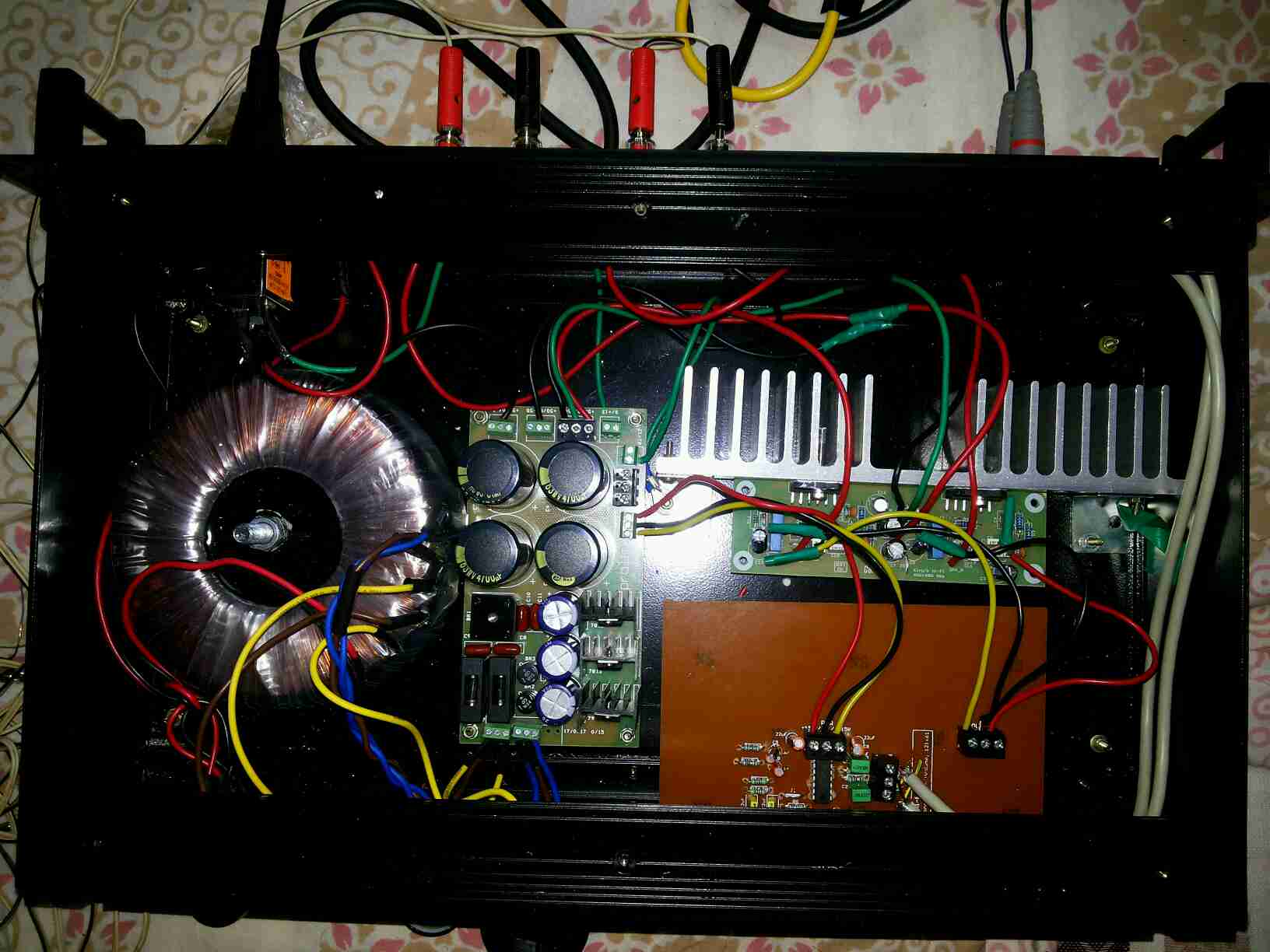

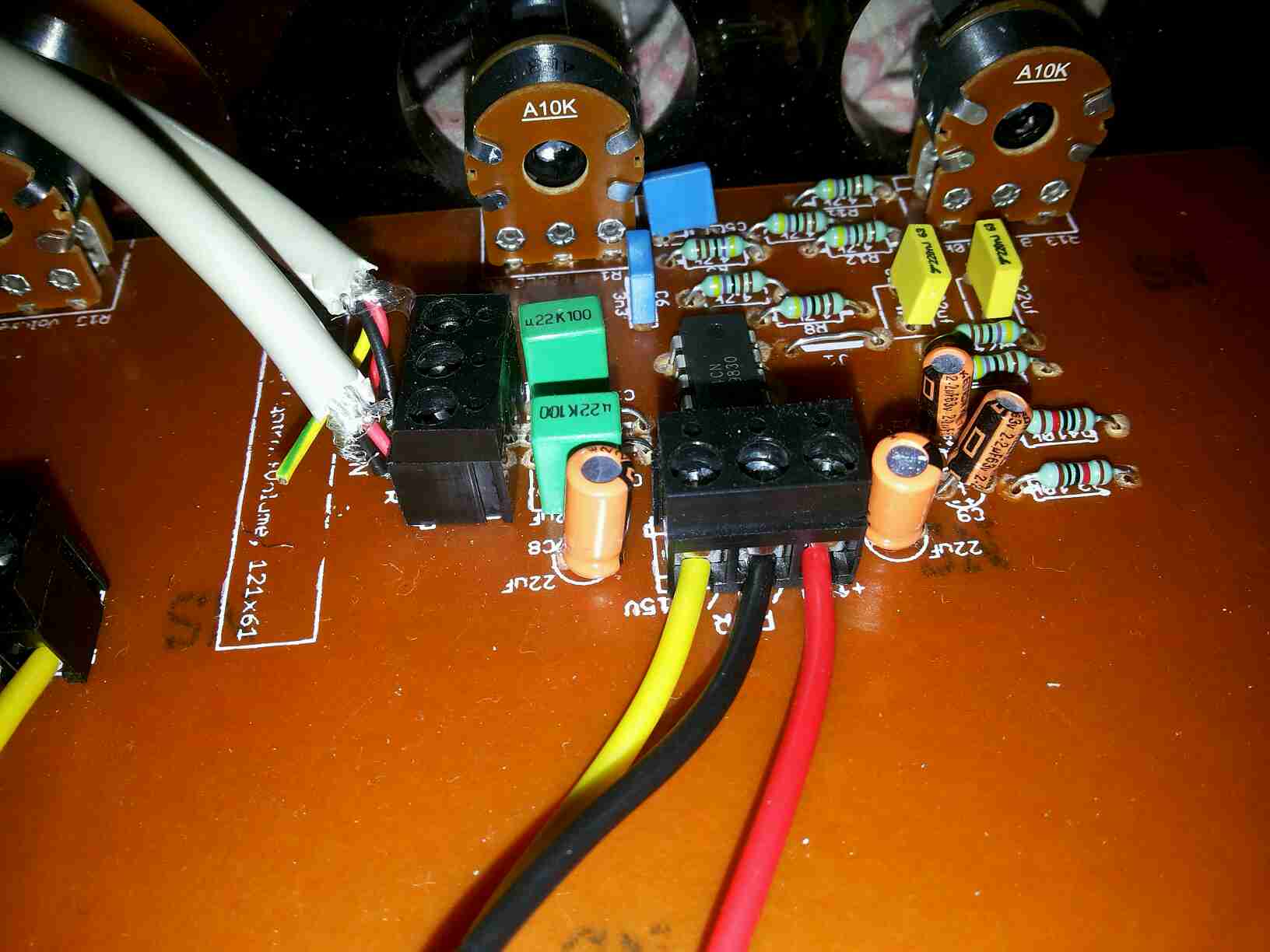

hi rohin,
pl find attached the photos of tone control and the amp. PS ground is connected to the tone control ground which in turn is connected to the signal ground through a trace as per the design in post #505. I have checked and rechecked all wiring and it is ok. dont know whats wrong.😕

you have to ground your amp chassis well.i don't think that A10 k good for that. use B10 k there is difference in a and b.lin and log tone are different.some time bad ground design of pcb cause this problem.may you fix it soon.did you check resistance some time they bad too.tone body earth is different from pcb desing you have to earth it with wire.your work is clean and good.

Hi all,
Just when i had lost all hope of ever completing my first ever diy integrated amp, Eureka!. Something clicked .
this moment happened when i was pondering the events of building this amp and where i might have done wrong. when i had just used the volume control on the i/p of the amp, sound was very nice. then i etched my tone control pcb with thermal toner transfer method and soldered on all the components. unknown to me, PCB track on the supply input (because the tracks pass so close to each other along the center of TL074) was shorted and when switched on the amp, there was a thump sound (uncharacteristic, because I know this apex gainclone is thump free due to the zener diode on mute pin!). I just ignored this to my peril, and since the pcb was not working, i got it screen printed from someone and went on to build my second tone control pcb. when i assembled everything and switched on, everything was working except that the sound was distorted especially at low volume levels and at higher volumes it was not so apparent.
It must have so happened that the uncharacteristic thump that i heard with my first home etched pcb was actually the woofer being blown / torn and at higher volumes the tweeter took over and overpowered the woofer distortion. swhishhhh!. fortunately the speakers were commercial and not so hi-fi.
when just i had lost all hope of ever completing the project,(believe me i tried everything; changed caps, TL074 i/c's by dozen, grounding schemes, and as rohin suggested, grounding of volume/tone pots and what not!!, i was even planning to import TL074 i/c from RS components UK!), i just tried on with another speaker that i had lying around and voila, the sweet sound started pouring out of it.
thus problem resolved!, even as i am writing this, my favourite song is playing on a wonderful amp built my me and my home made hi-fi speakers.
