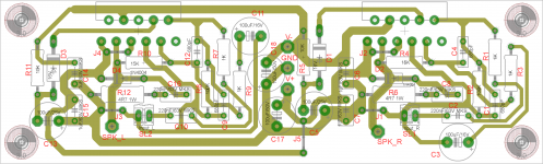

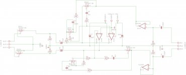

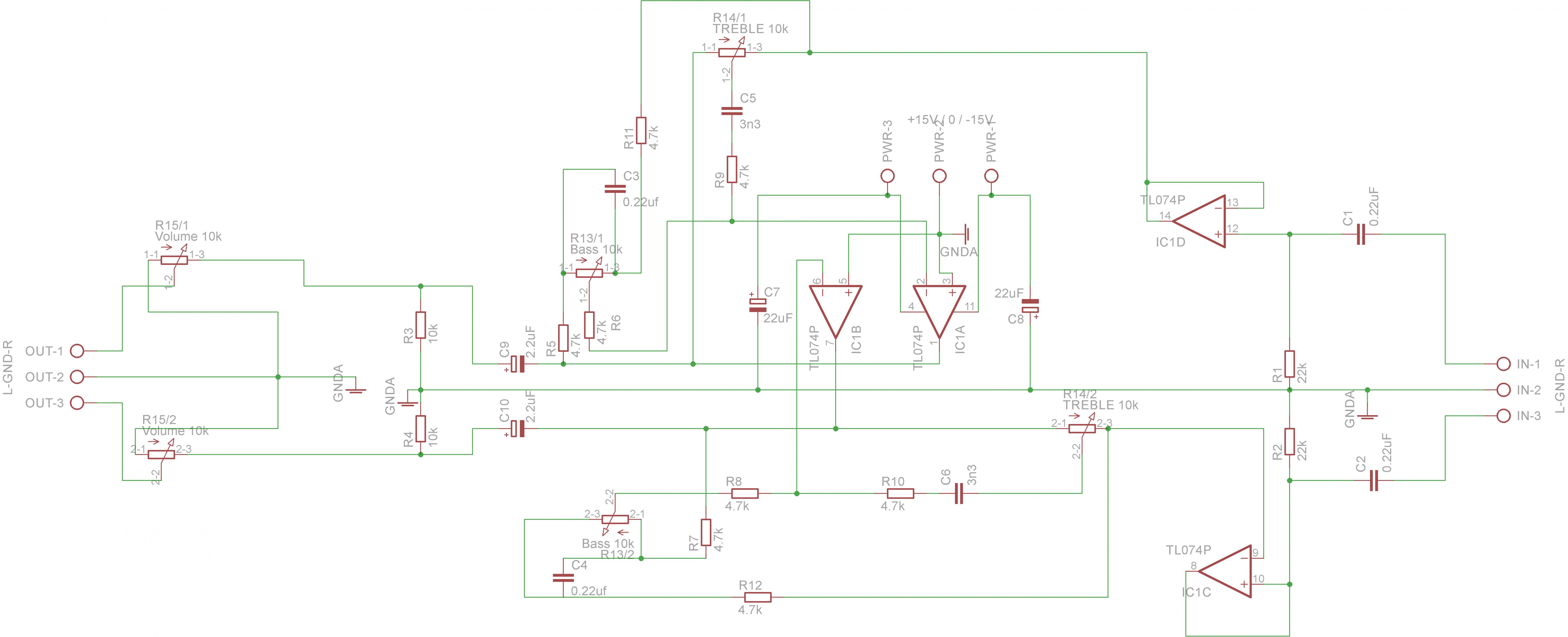

Dear Mr. Andrew,

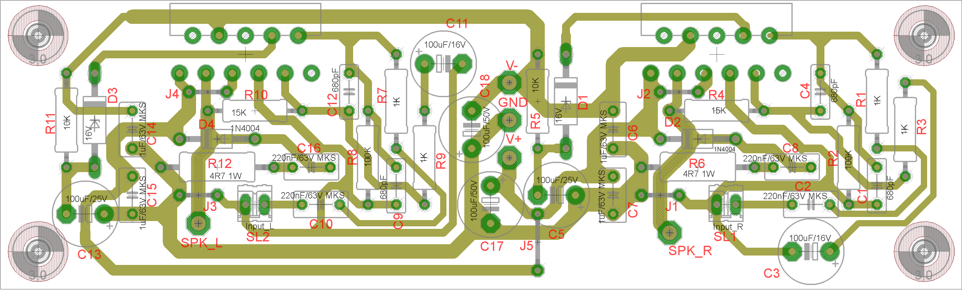

Schematic for tone control is not available , only the layout. its from Apex audio. I have modified it to include the volume pot. its available in post # 505.
the amplifier pcb is again by apexaudio and the link is http://www.diyaudio.com/forums/chip-amps/162099-lm3886-schematics-pcb.html. The PCB layout is as per the attached image designed by Bimo.
reg
Prasi

1. The amp has been tested by bimo also.
2. Speakers used are Diy floor standing with f3 of 40hz. I am using same speakers to compare commercial amp and Diy apex gainclone amp. Comercial amp sound is more open and deeper bass and sound is not harsh on ears.
3. Toroid 300va transformer used.
4. All caps are imported ones by epcos and chemicon in the amp. Tone control caps are local.
5. Hopefully I have done everything correctly. Volume bass and treble pots are working as intended.
Anyway let's see. I am also building kelvin amp. Hopefully its sound is better.
Reg
Prasi

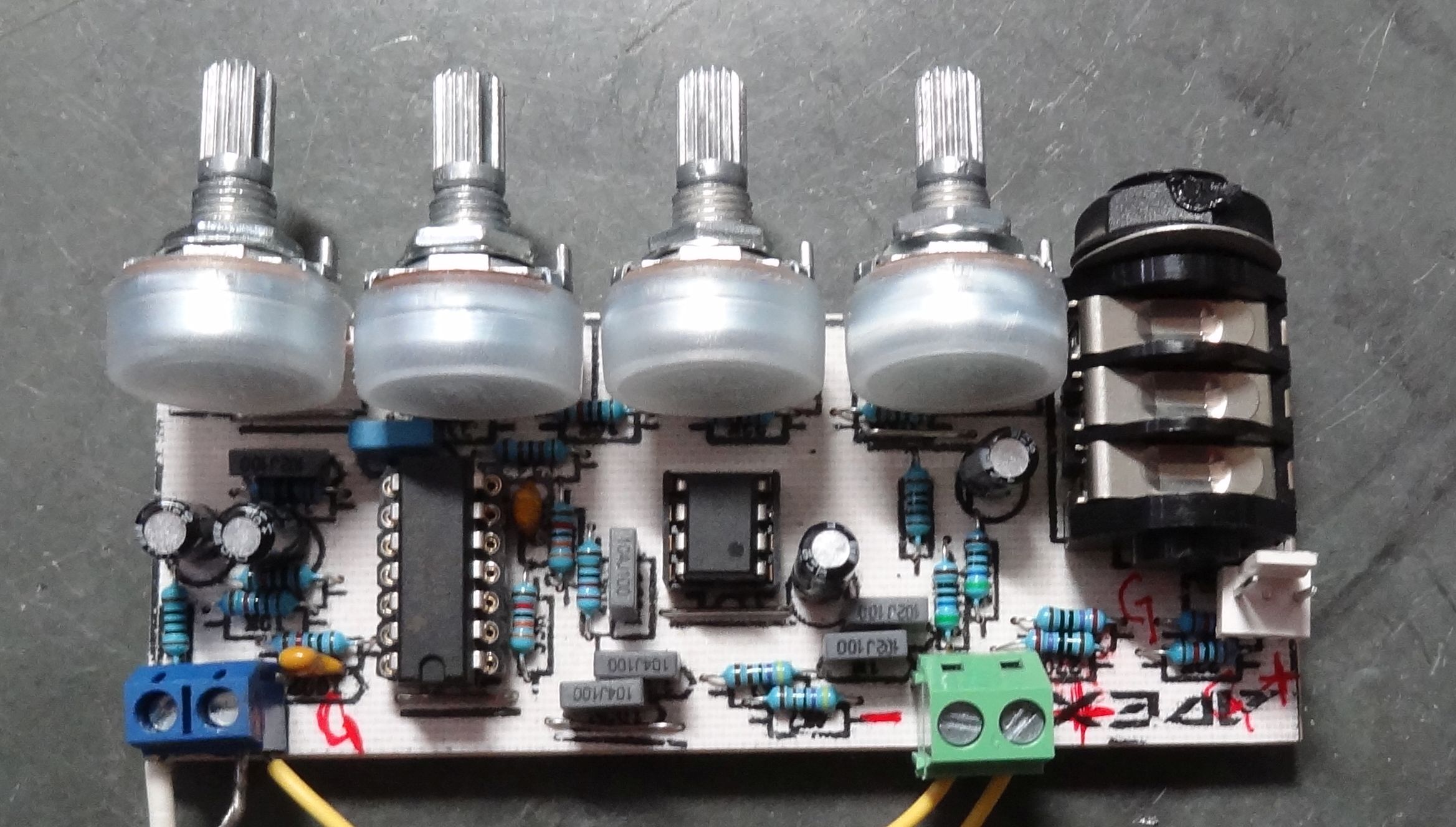

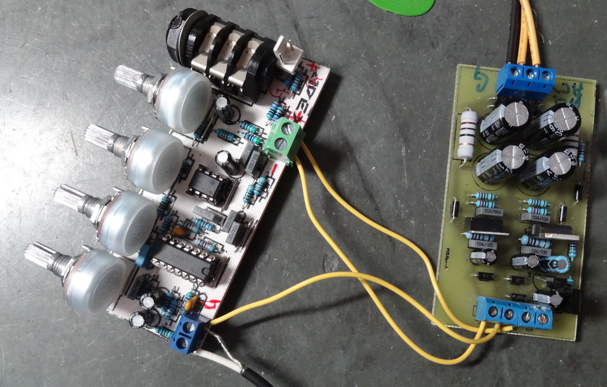

The parts came in so I finished one of the little Tone Preamp channels. Works pretty well. I haven't tried a mic yet but I did plug a guitar into it. Nice range on the tone controls. I powered it with a little ESP P05. Puts out +-15vdc with a 12.6-0-12.6vac transformer.
Blessings, Terry

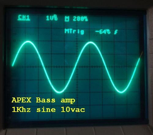

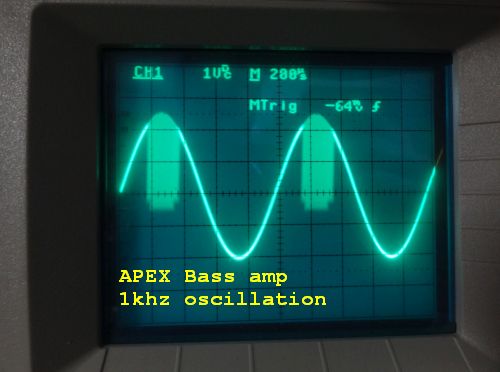

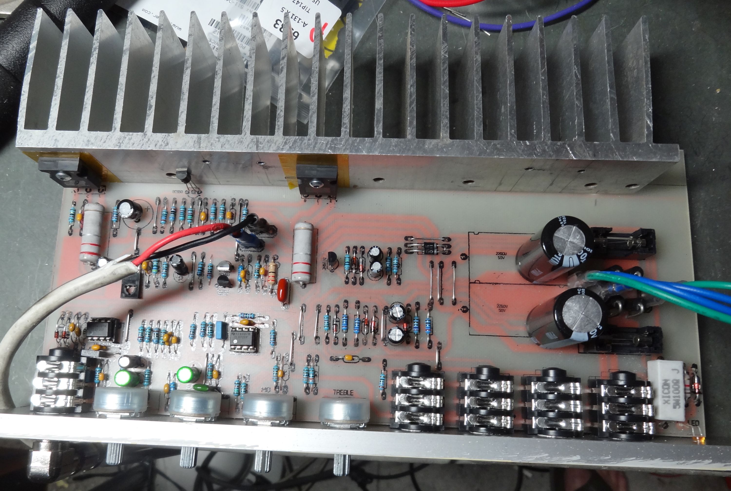

Hi Mile,
I have the bass amp playing. There are a couple of issues that you may be able to help with. One is that just before it clips I see oscillation on the top of the sine wave. That happens at about 15Vac on the output into an 8ohm load. You can see the attached photo. Another thing is that I am getting 1.8mV across the 0R22 emitter resistors. That is only about 8mA bias. I haven't tried geting the amp to warm up at all but at 8mA it probably won't develop much heat. I haven't played any music through it, only sine waves. The muting circuit works fine with a J111 installed for the jfet. I'm using a 100VA 22-0-22vac transformer. I get +-32vdc unloaded and it drops to about +-28vdc under load. Any suggestions are welcome.
Blessings, Terry

Nice work, measure voltage on 16V zeners, replace 4x2k7 with 2k2 to get 16V on zeners... increase value of 10pF and 15pF caps for compensations.
