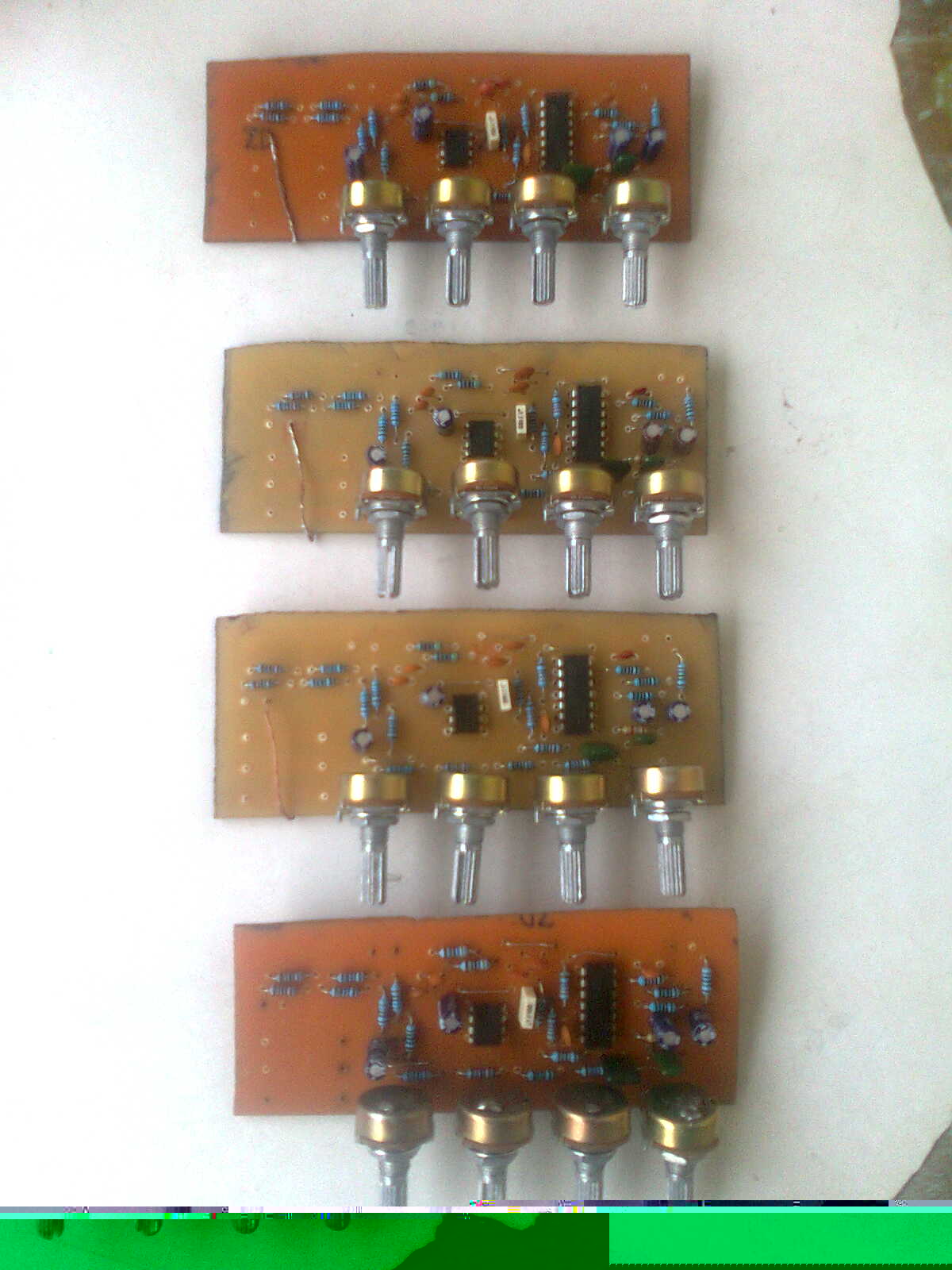

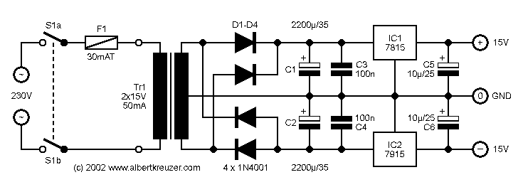

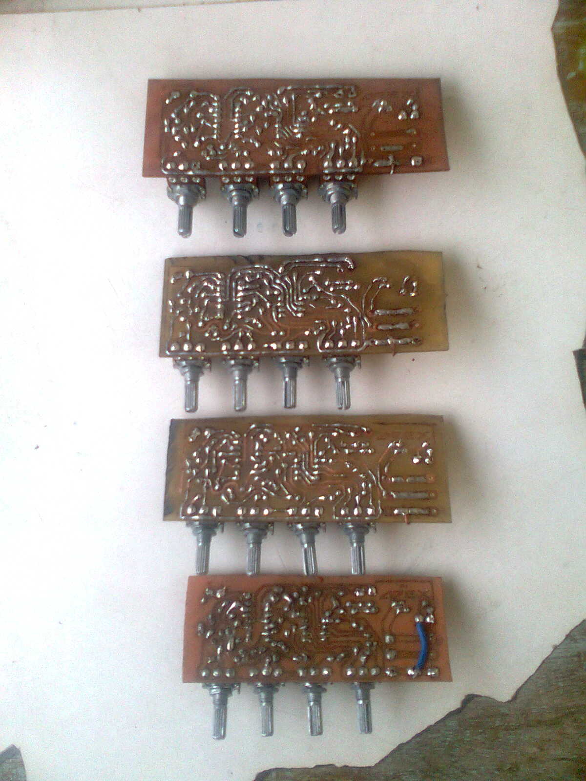

Hi apex. I have made apex ml3 pcb. This is the result. Quality is good enough. But i had a little hum, but when i touched the casing of my amp, hum was disappear. Can you give me any advice for it. How to wiring apex ml3 correctly? I just used simple regulated power supply. Thank you very much.
You must grounded your case (gnd from regulated psu connect to amp case)

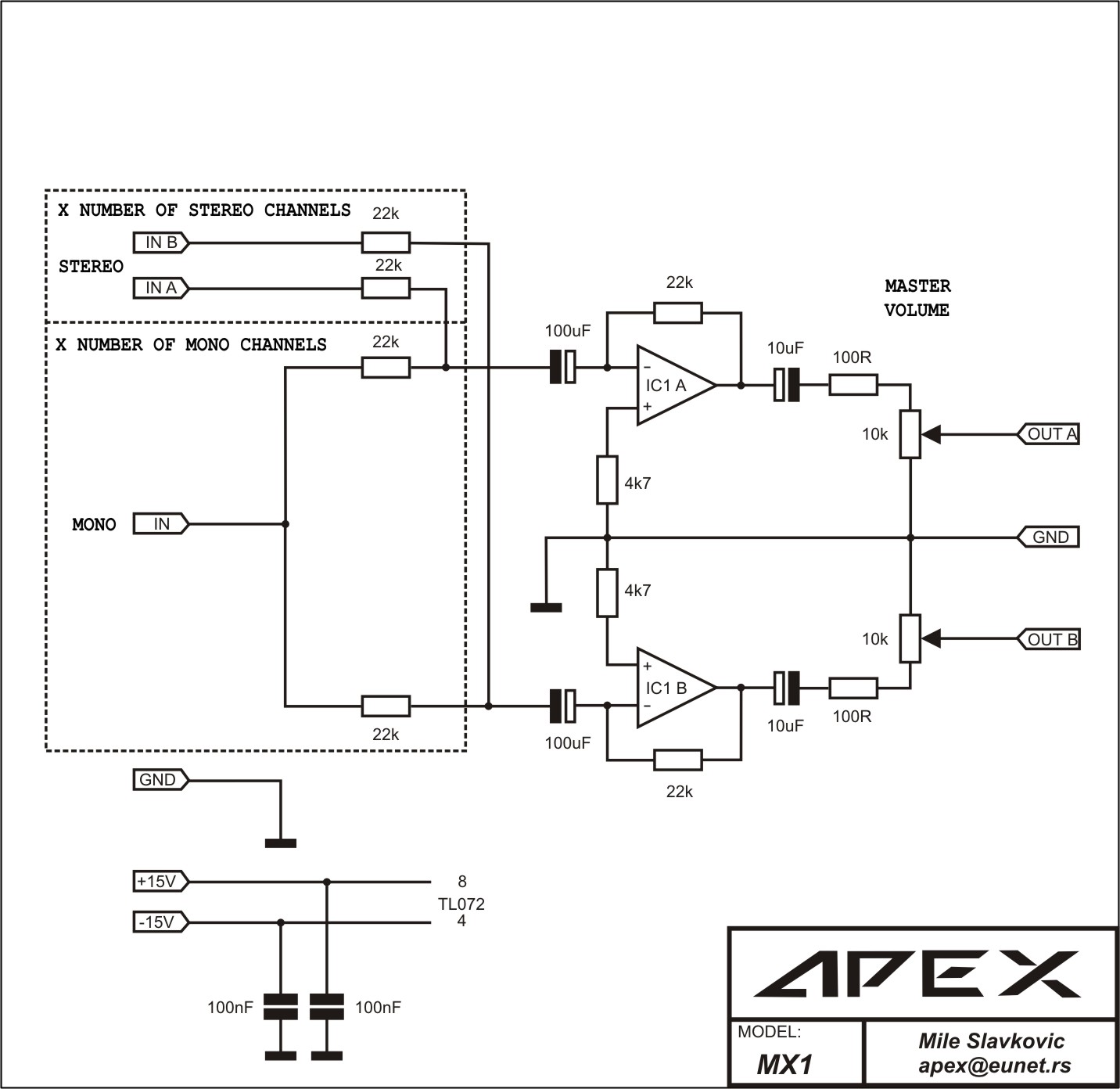

please help how to put balance pot ,
i will use ML3 as multiple input maybe 4 or up ML3 and feed it to MX1,
i just hope your help of adding a balance pot to assign left/right to MX1 as master and ML3 as multiple input,

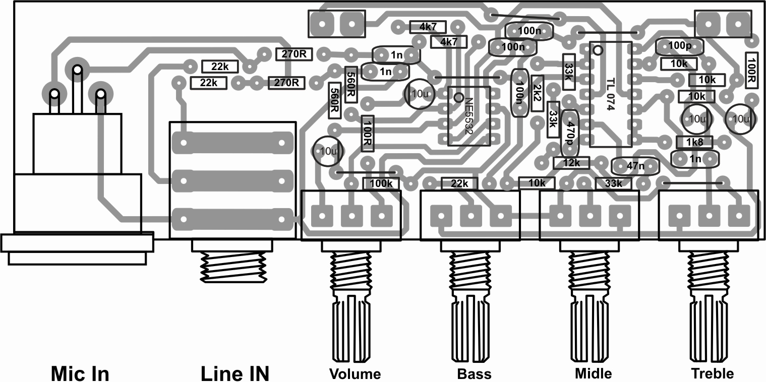

I was make a new layout of Your tone control with add a XLR con for mic input...I got a plan to make 4 ch mixer with 2 mono input and 1 stereo input but I don't know how to add effect and another block like master and balanced output...
Can You help me to make my simple mixer??
Regards
