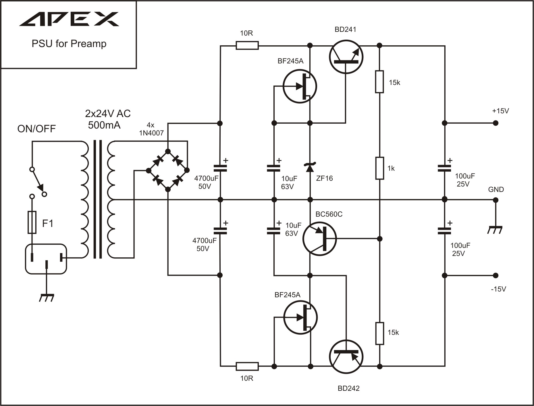

Any substitution for BF245 Sir??PSU for preamps and active x-overs, with different zener output voltage can be +/-12V, +/-18V...

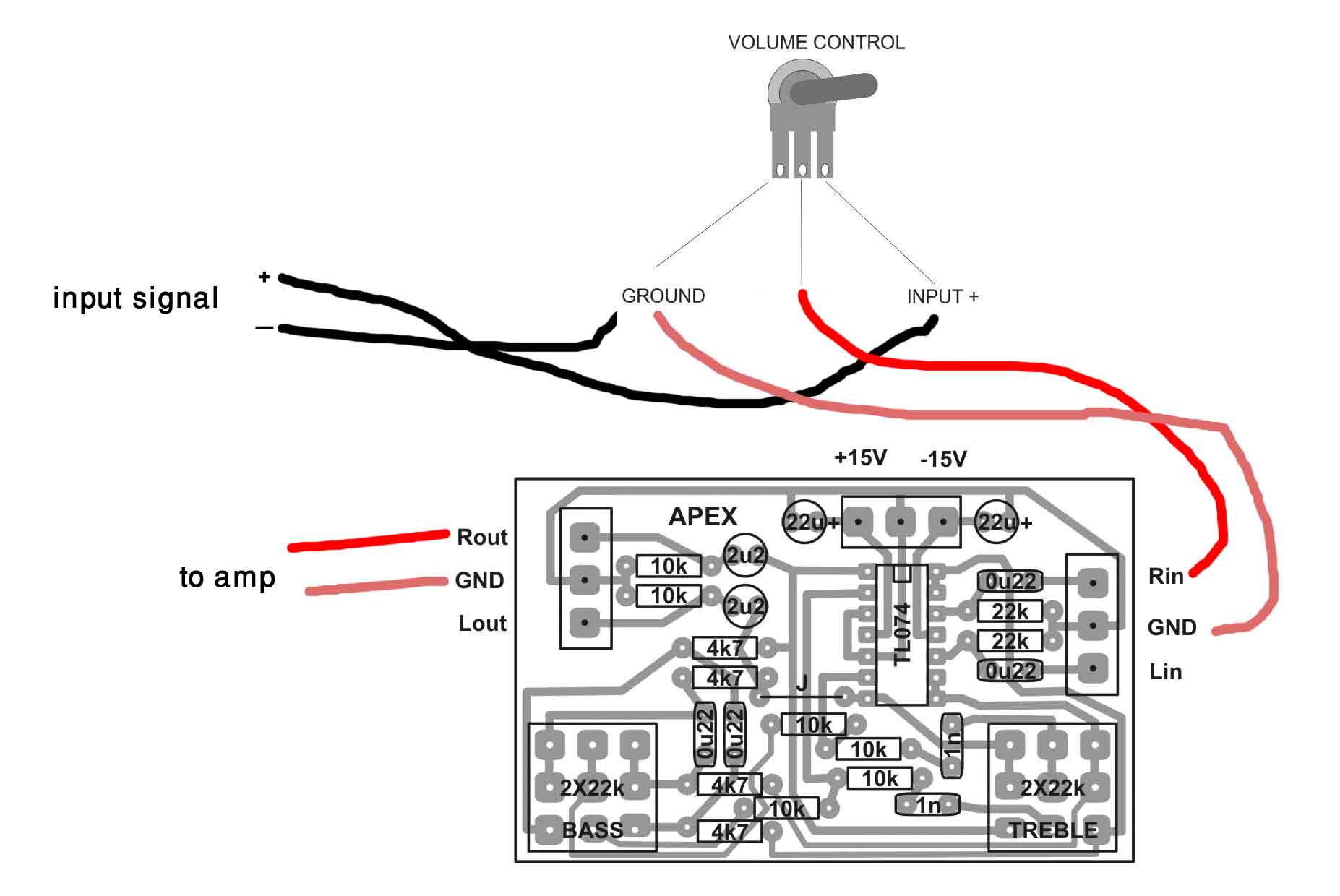

Mr. Mile, can you mirror your layout ML3???It's correct,
Regards
Because I make layout PCB with metode iron..
Regards
Use 2SK246, 2SK49...

help me with this ML3
Hi man i know its a bit late to quote this but ml3 that i have made is generating some noise when the vol is open.
espesialy it gets worse when i connect the mic to it.
what coul be the problem.
u know when mics coil is connected the noise is loud and when its not connected the noise is lower but suffering again. what to do man????🙁
