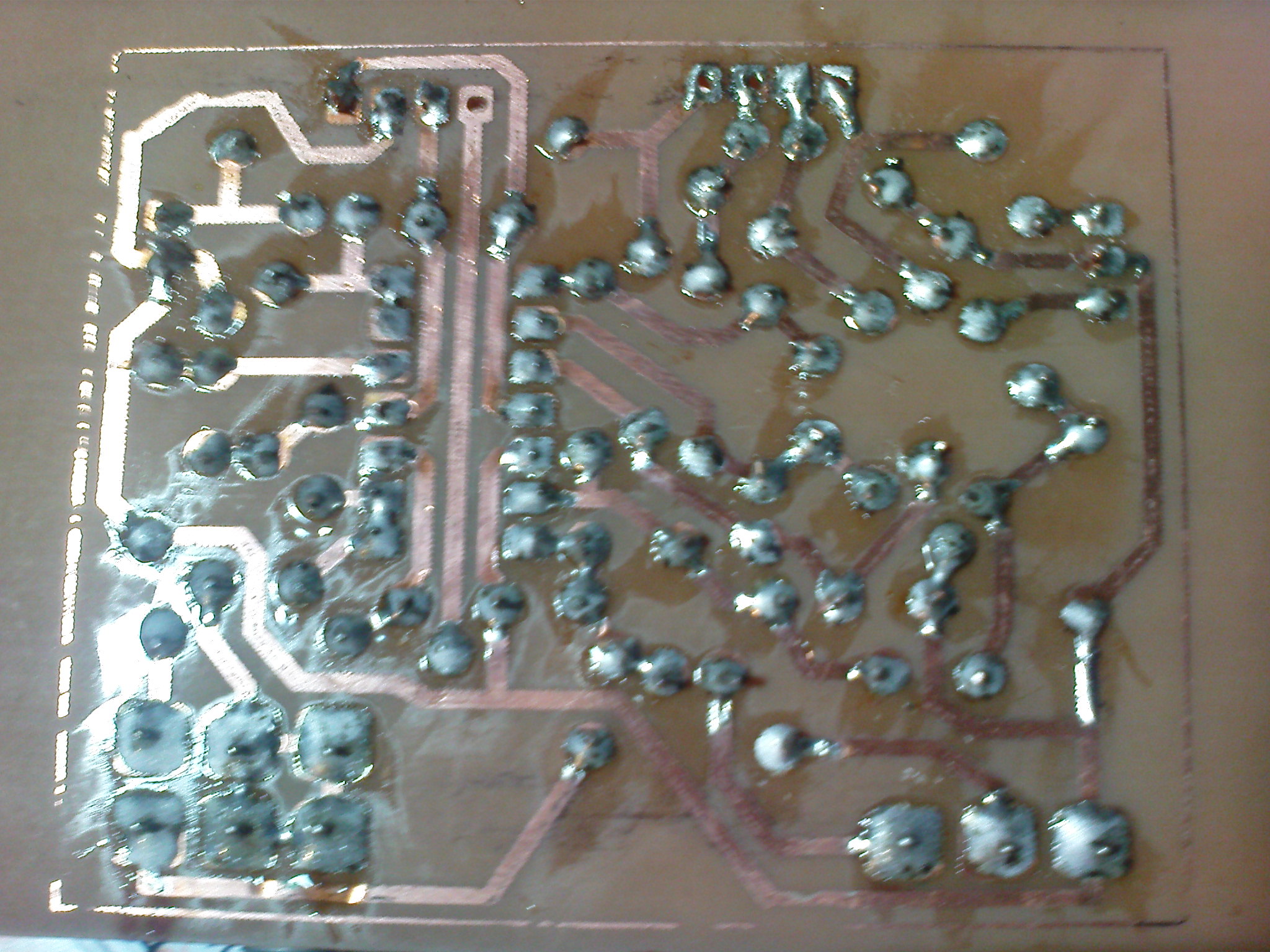

thank you Mile I build this one and its very good for sub I test it with dual TDA stereo as I build before the result was great and sub is shaking the room, here the PCB with PSU I used for it.PCB size: 60x50mm
top:
button:
power supply from 35v:
but I still have question about two things what is AUTO used for?
and speaker input I didn't use it just use the line in again when I can use them?

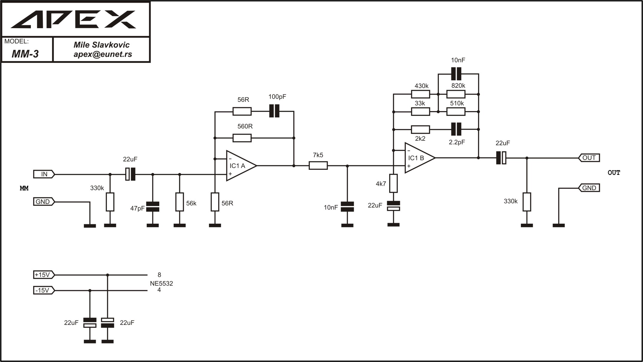

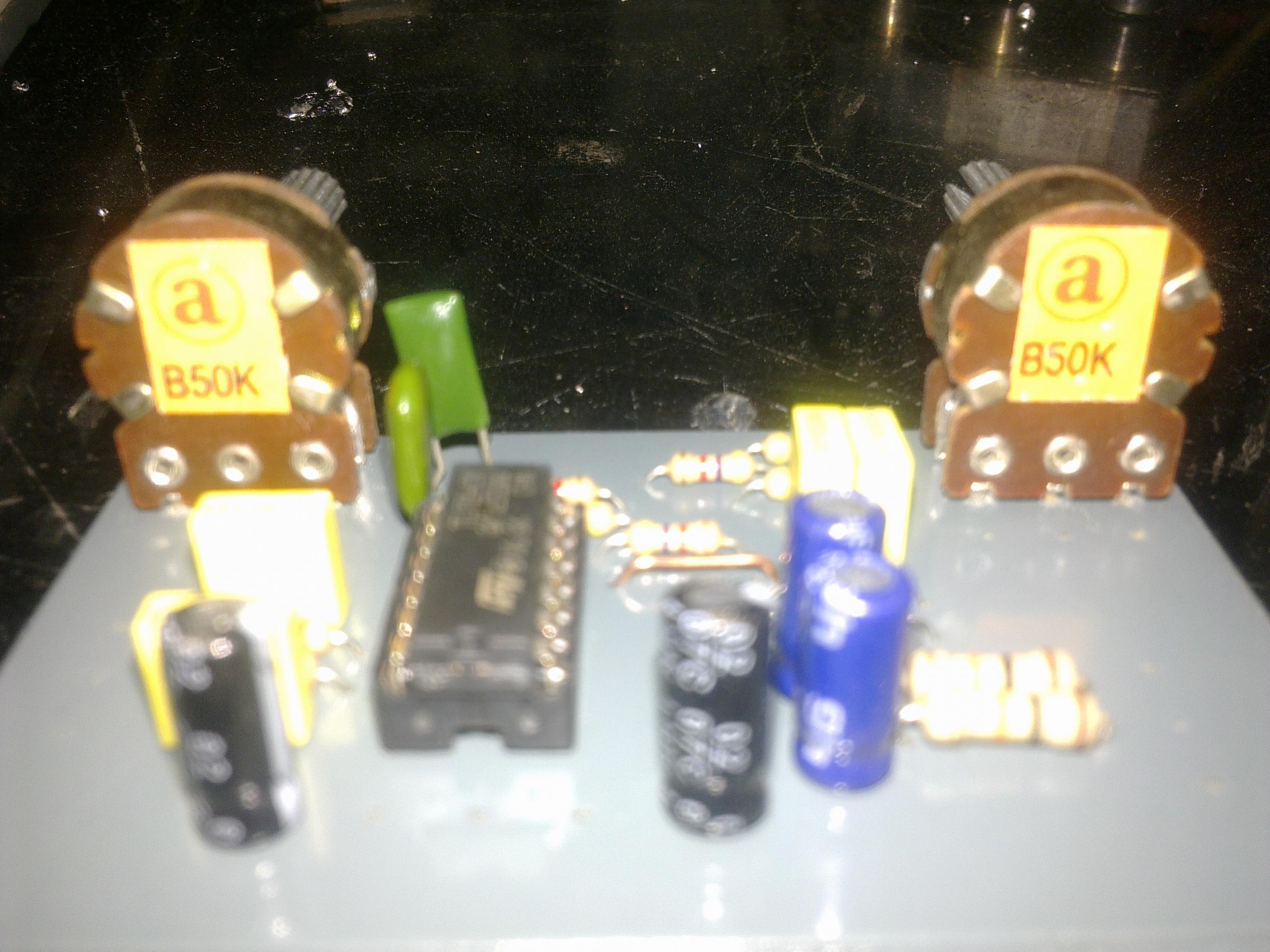

ASK TONE CONTROLL MR APEX

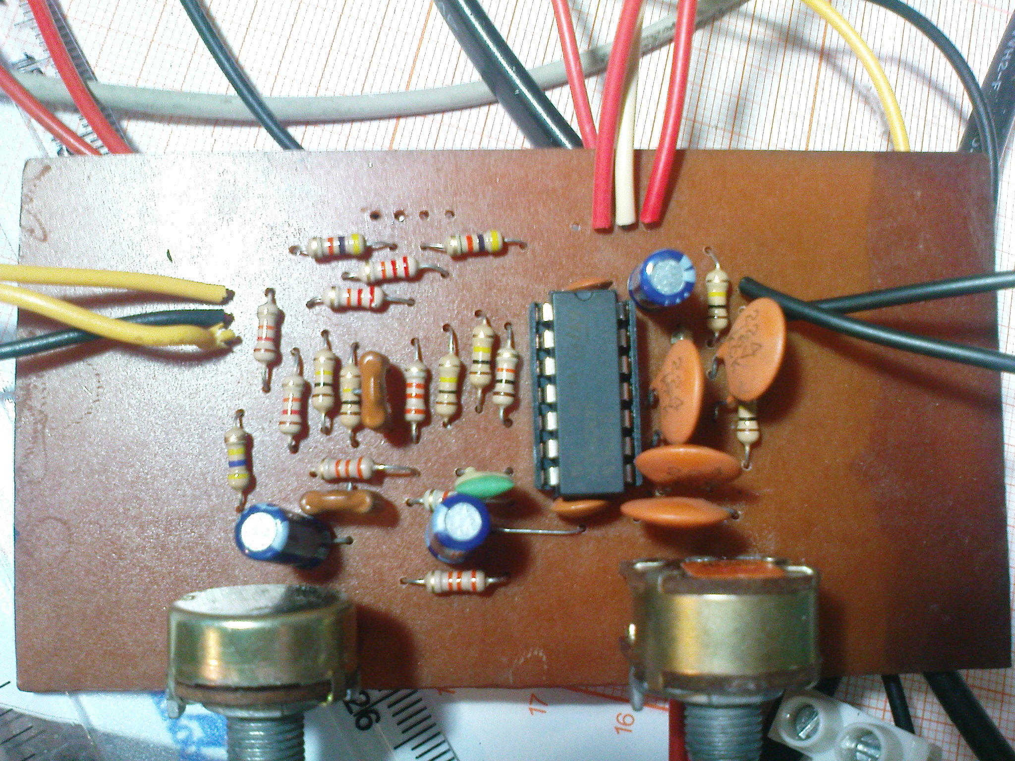

I've assemble tone with potensio 2x50K controll apex.
I heard the high voice is not good but if in a low voice I feel pretty catchy.
I question whether the components that I use have to be replaced?
help me Mr. APEX.

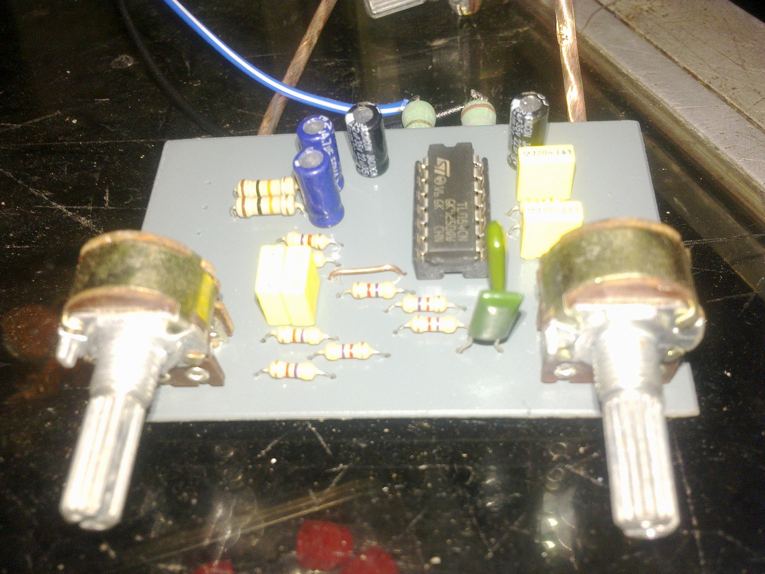

help me Mr. APEX.
greeting
The following picture
Use 1nF instead 3.3nF.
