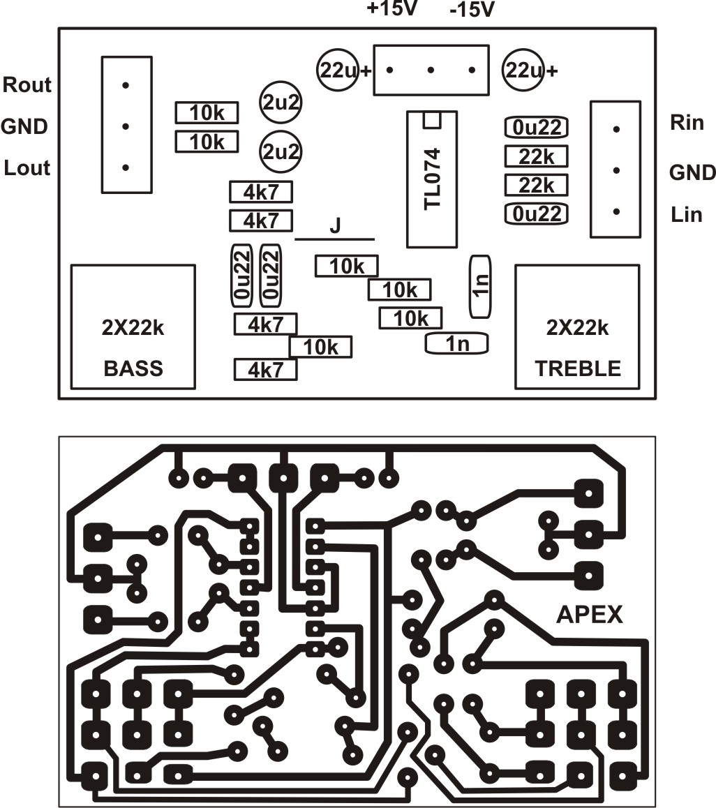

PCB Layout
Hey buddy care to share the Layout of this for toner transferring, Also wheres the original schematic for this preamp, never seen this APEX preamp before, I might have missed it. thank you 🙂

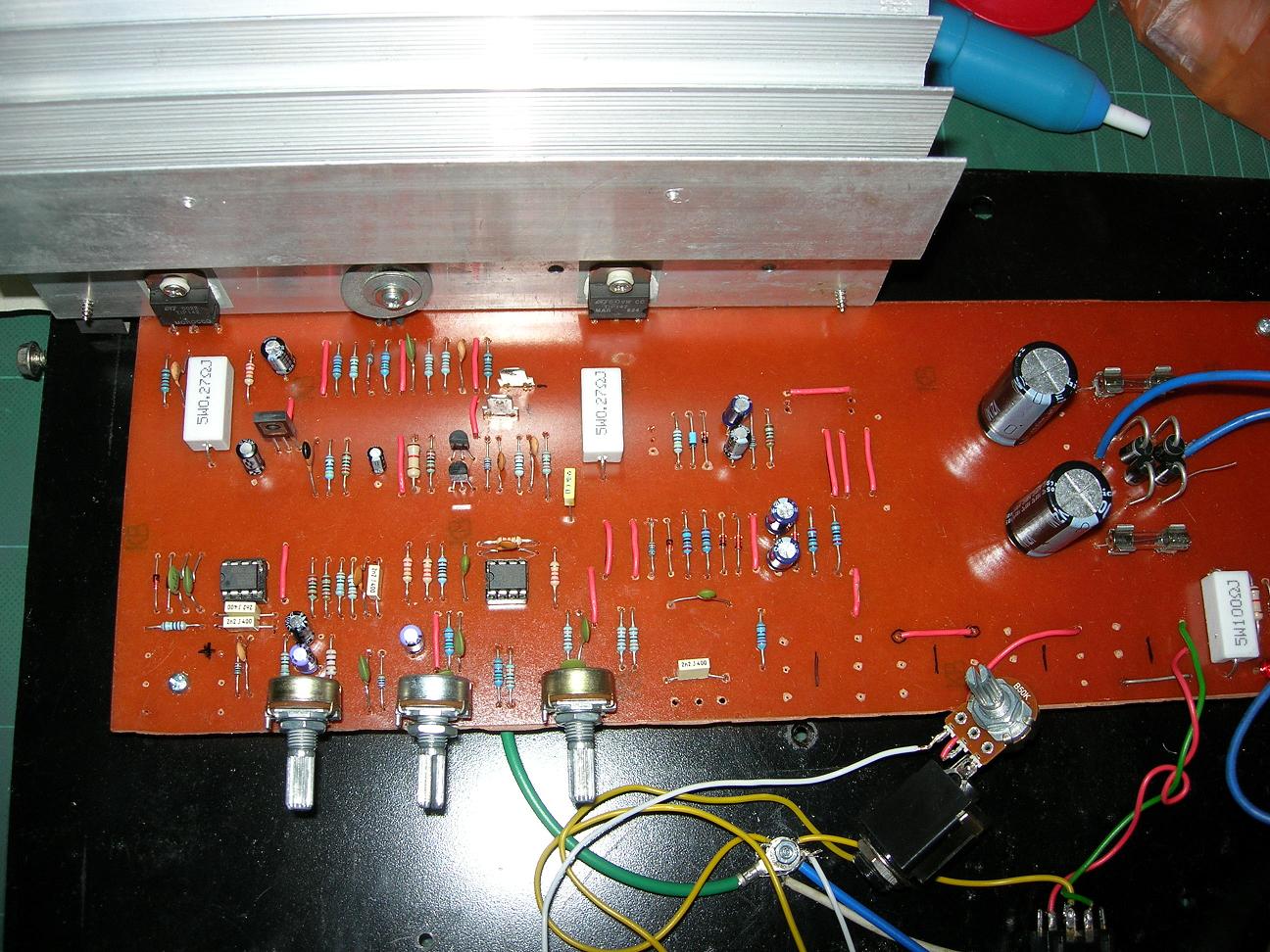

Miles,
I managed to put together the board for your 100W guitar amp.
Well almost completion.
Please advice, 2SK246 can be used insted 2N5638?
Thank you.......Raj
Use J309, J310... 2SK246 different pins, amp can work without 'mute' fet,
Regards
Regards
Miles,
I have already tried using 2SK246(pins rotated). Firing up there is no mute on or off.
I still hear thumb. I have taken off the FET.
Now the amp itself works but signal input at preamp side, I have no gain. With volume at full opened, I hear very low noise.
Therefore connected to amp input with 50K pot at C14, the amp works good.
Very good bass.
Please tell me what to check at the preamp side.
Raj
Miles,
Very good bass.
Raj

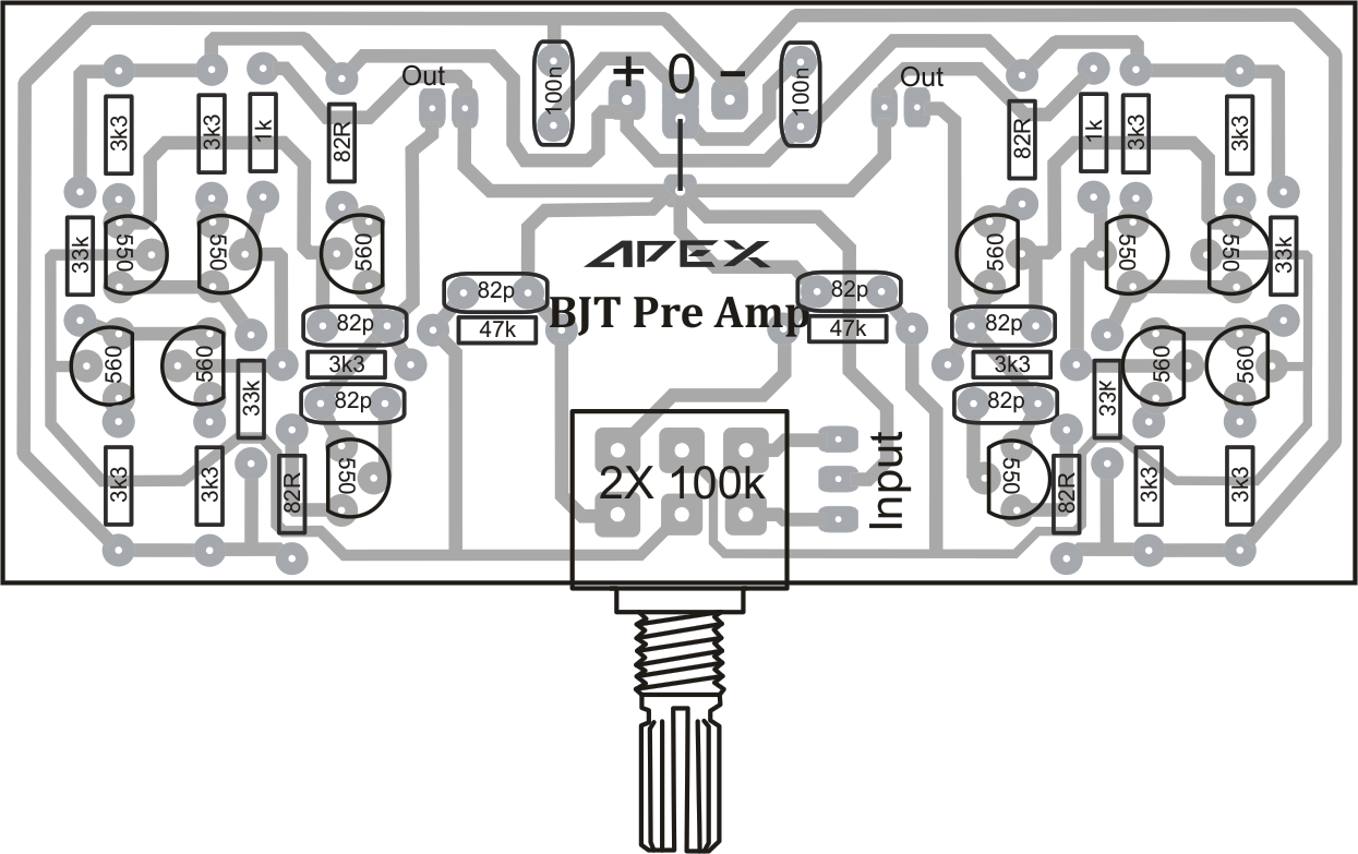

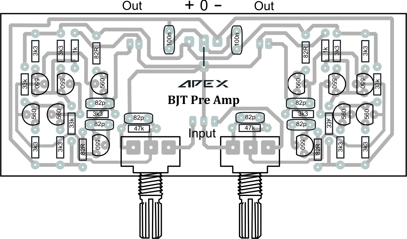

Is this correct sir???
Can i use this for AX14 or LM3886??
What the minimum voltage for this pre amp?
Regards
Connect from base of outputs BC550 to colector of inputs BC560 missing !
You can use this preamp with any amp.
Preamp can work with +/-12V minimum with 18k instead 33k, but use +/-24V.
Regards
Can you post pictures?
Regards
Miles,
Pic attached.
1)For now I am playing direct input to amp via 50K pot, at C14. Good bass.
Please tell me if any changes needed as above. Is 50K pot or 10K.
What is the bias for each transistors (40mA?)
2) As for the preamp part, hope can be solved.
Raj

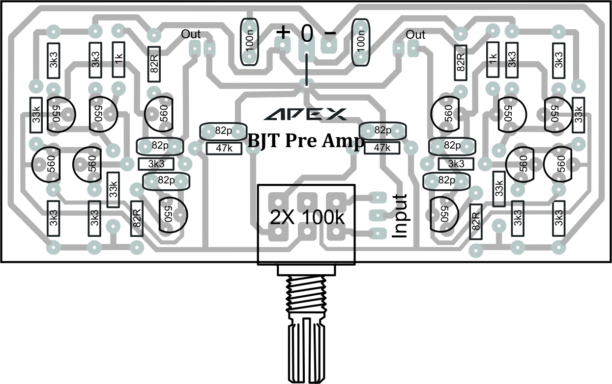

Is this correct now??Connect from base of outputs BC550 to colector of inputs BC560 missing !
