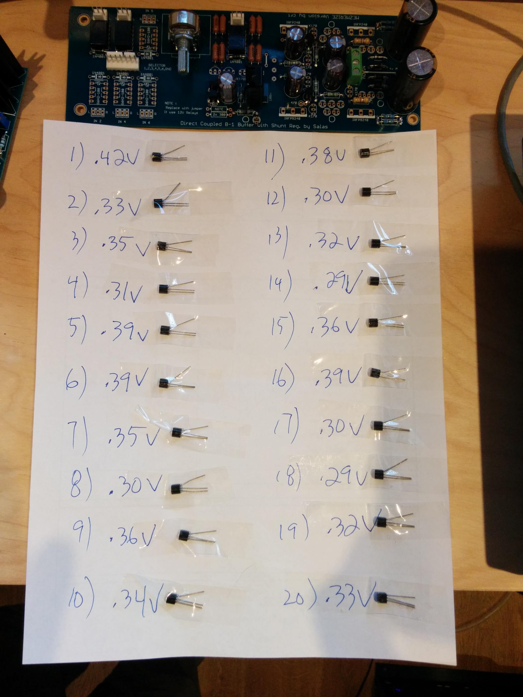

I followed Andrew T's Jfet Idss matching method below.. My results below..
The mesmerize Jfet states matching -up to 5mV DC offset-
First time I've done this matching..It would appear that my 20 fets look closely matched in the medium Idss range..
Any comments?
I use DVM to take all my measurements. I don't trust ammeters.
A 9V pp3 and a 100r resistor is great for batching jFETs.
use a croc clip or inline socket to short together the G & S.
Apply +ve battery to 100r. Connect 100r to Drain of NjFET
Apply -ve to G+S
A low Idss jFET that draws ~0.5mA will drop ~50mV across the resistor leaving Vds @~8.95V
Pq ~ 0.0005A * 8.95V ~ 4.5mW
Do the same for a medium Idss NjFET. If Idss ~5mA then the Vds ~8.5V and Pq ~45mW
Do the same for a high Idss NjFET. If Idss ~40mA then Vds ~9-[0.04*100] ~5V
A 40mA jFET will not pass 40mA @ 5Vds. Maybe 35mA. Let's assume that figure of current passing.
Vds~5.5V Pq~190mW That is going to fairly quickly raise Tj.
If you want to rough batch completely unknown jFETs then consider replacing the 100r with 200r and measure the Vdrop to read off Idss.
Thereafter, I believe pair matching using comparison of DUT to REF to be the only reliable method for us poorly resourced amateurs.

Looks like you have two sets of four devices that will work well: .35, .35, .36, .36 and .32, .32, .33, .33
Salas had a specific recommendation for where to place higher/lower ones that I am not remembering right now.
Edit: I found a note I made a little while ago from Salas: (from right to left on board) lower values in the middle, higher values on the outsides, highest values on left. My set of 4 jFets measures7.55mA (inner pair) and 7.57mA (outer pair) and results in offset measurements of less than 1.0mV from the DCB1.

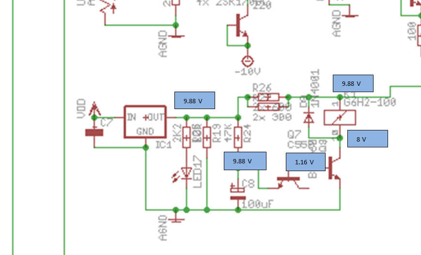

Mute relay not switching
Hi everybody. I guess I have a problem with my just finished Mezmerize. When I connect power I cannot hear the mute relay switching; it is indeed not switching.
I had a look at the voltages in the circuit feeding the relay and they look like this.
The voltage at the output of the 7812 seems too low. Can this be the reason?
Is there anything else you guys suggest to check?
Thanks to all
