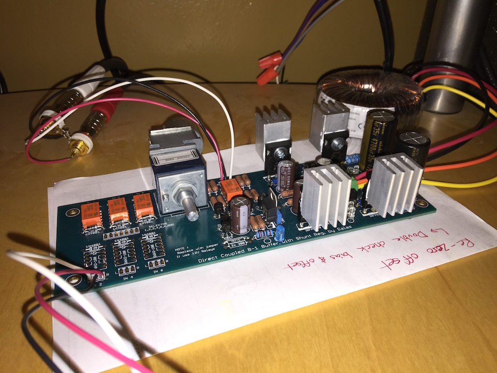

I mounted resistor under PCB - maybe its even better for "cooling"?
Ummm I cant check temperature and I suppose organoleptic checking wouldnt be enough as 40- 50C could be hot for finger🙂
Both pair of MOSFETS get hot equally or I could get bigger heatsink for some pair? Im asking because I got bigger heatsinks but only 2 pcs🙂
If mounting the resistors on top they get better air circulation. All will be judged by how comfortable temperatures they develop in the end. So try as they are and see. First MOSFETS near the big electrolytics can get hotter than the next ones if the raw DC voltage goes higher than 20V across those main capacitors. Depending on how high are the transformer secondaries.
if use the sink like that ..why you use High power mosfet ,...just use small type 1-2 Amp
The MOSFETS used have a capacity for high hot-rod but they remain the same type in cooler DCB1 uses to have consistency of characteristics between all DCB1s. They can also run at about 60mA without sinking at all due to they are large (as in Zibra's original config) for simplest of construction and implementation with still very good SQ.
Friend of mine boughts these radiators at local electronic shop as I told him to buy 5W/C(?) - saw your recomendation for it in other post if I remember correct. They sell him such small ones 😉
I found little bigger that suit first pair of MOSFETS better.
how long does it take for MOSFETS to get their biggest temperature? DCB1 running ca. 10-15 minutes and radiators on both pairs are only warm - could grab all and keep my fingers on it.
I also bougt 22R resistors so current is a little bit smaller...😉)

Current is the main thing. Temperature actually makes them less conductive. So a balance between sinks size and comfortable temperature for their reliability and for all inbox components long life is the goal.

Since you can still grab them after say 30 minutes, no worries.

So what does hot-rodding the Mez do exactly? Does it increase gain at all? I am running a DL-103R, Pearl 2, Mez and Cornwalls and on some vinyl, I could use a little more gain. Also, based on the previous pictures, I am guessing these sinks aren't sufficient for hot-rodding?
FWIW: I tried increasing the gain on the Pearl 2 and got distortion. If I place a cheap Denon 10dB SUT in front of it, the levels are about perfect, but I prefer not to use a SUT.
Has not to do with the signal itself but with allowing the shunt PSUs to run better. No effect on gain either. A buffer is a unity gain circuit no matter even if golden electrons will run on its supply rails. Side effect is bit nicer DCB1 as the long term subjective testimonials insist. Those sinks in your picture maybe sufficient for 150mA. I.e. a 12R 3W single current set resistor per side.
