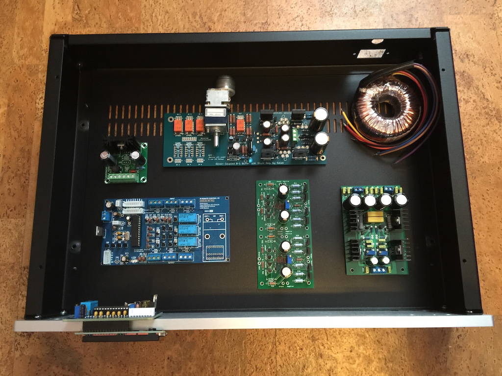

Chassis arrived today! Woo-hoo ... no more bare PCB and transformer sitting on my audio rack! 😛
As you can see, there is a lot more than a Mesmerize in here. The blue PCB is a remote volume and input selector with LCD display that I will use to control the relays and Alps pot on the Mesmerize. The other 2 PCB's on the bottom right are a Marsh headphone amp and a CCS-fed shunt regulator for it.
The last piece of the puzzle is a logic circuit controlled by the headphone jack's switch that controls relays for the HA power supply and the preamp output to switch between OUT and headphone so it mutes the RCA outs when the phones are plugged in.

Craig, very nice layout. One of my next projects is to get my DCB1 into a chassis and I'm looking at a similar approach to yours. I want to build in a remote volume and input selector. Whose remote board did you use? I'm looking at various ones like the MV04 on ebay that provide both a knob on the outside of the chassis and remote capability.
Eric
Eric
I used the Analog Metric Kit but ONLY to control my Alps Blue Velvet and the relays on the Mezmerize board. The Analog Metric utilizes an Alps pot that uses the same motor as the Blue Velvet but is a lower quality pot. The relays are active low just like the Mezmerize, so compatible there as well with the audio signal never needing to leave the Mezmerize PCB. If you want a knob also, just add a shaft extension to the pot.
