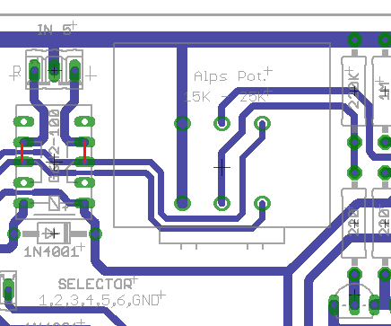

There are no problems if I use LED 1.9V? Unfortunately I've already soldered! :-(
If used 8.3ohm resistor i get a 230ma hot-rodded version, if 9.6ohm 200ma, right?
Is there any problem for all other board component if a use 8.3ohm resistor? Any suggestion for using this value?
Thank you
Of course you can use them 8.3 on both sides. Sinking the MOSFETS is needed at this current level and it can also be the chassis floor (use insulation pads). Not really hot yet, each MOSFET runs at about 2W. The 3W resistors can hold on their own just put them a bit high on the board for air to can pass around them. About 0.5W will burn in each of them. Because the dissipation is constant they will feel a bit more than just warm nonetheless.
*Why I wrote use 9.6 on (+) and 8.3 on (-) section if you had both is because many times the negative (IRF9240) side tends to run a little lower CCS due to usually higher VGS reading in the NMOS batches. But its not an issue in DCB1, just feels prouder for nice readings.

What can I do??
My input is one and I don't connection Rotary Switch,have dependencies?
1.5mV is not the end of the world bad, pretty passable. But you could try trading places of the audio JFETs in that channel as I said. For the 0.1mV other channel do not bother.
Switch or input number has not to do with it. Just don't measure the output offset when some active device is connected on input.
Don't populate any input relay and use input five with jumpers as the short red lines.
