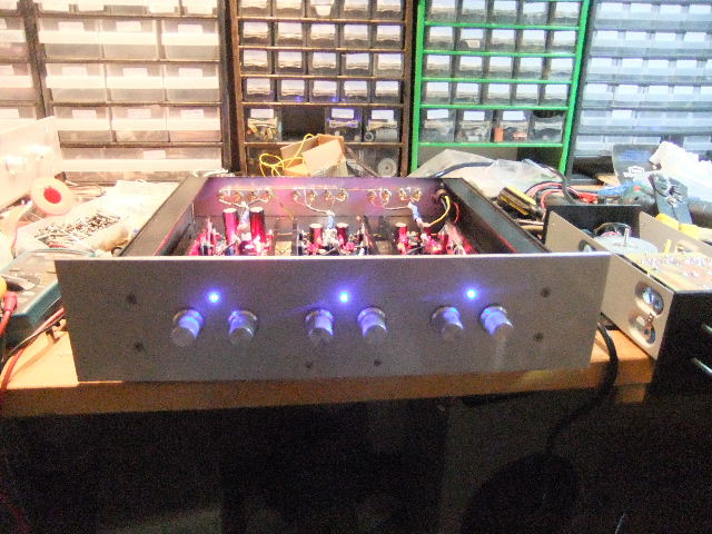

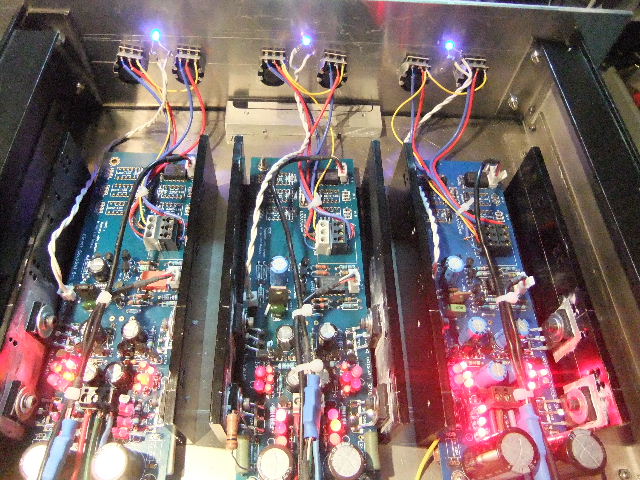

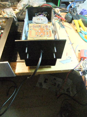

My Mezmerize building has come to a prelimenary end. It is hotroded with 10 ohm resitors. At this time I have not listen to it, but litening test is "ahead" and might show if there any benefits to change to a even "harder hotroding".
Power in seperate box woth a 50VA 2x15 V AC transformer and 72000uF.
Eivind Stillingen
