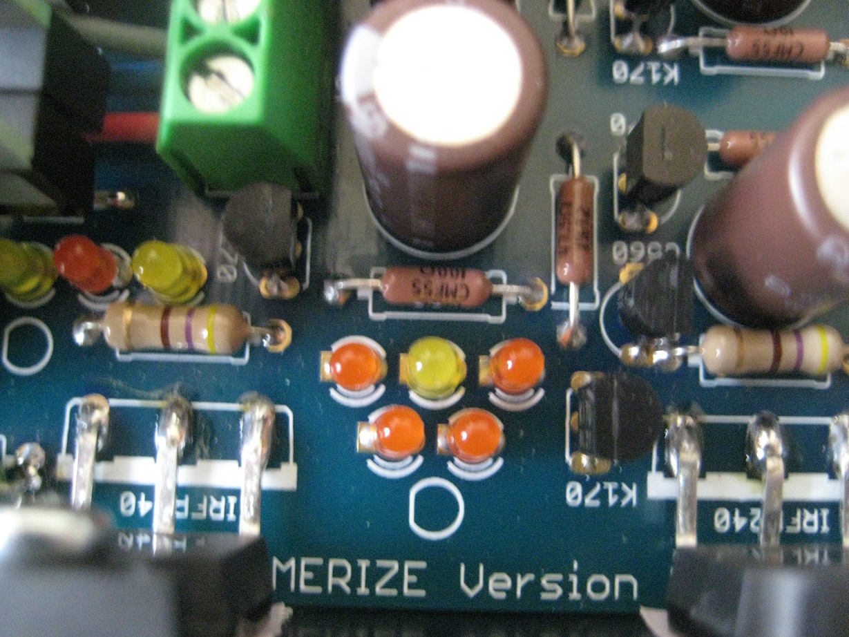

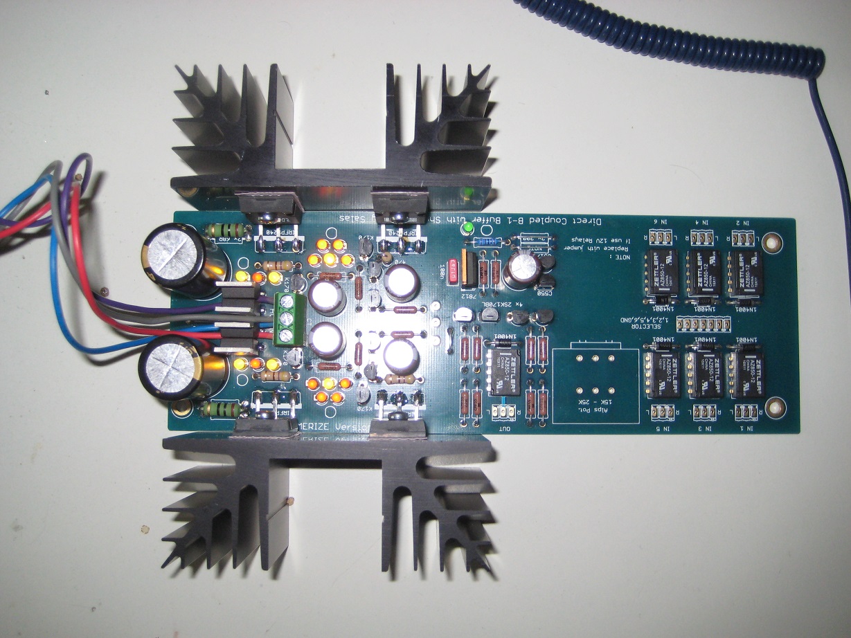

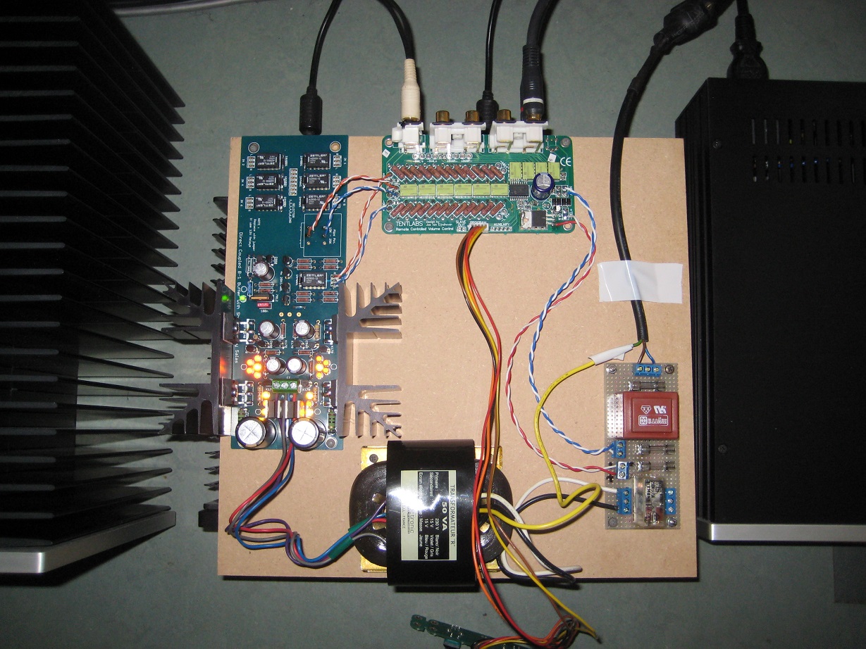

Some pictures of my build so far...
I tried to match every component to the best. Have a lot of 2SK170's so why not 😀
Also hot-rodded it a bit 🙂
I used matched JFets for the positive and negative shunts. Also matched all the LED's with their corresponding JFet in that position in the circuit.
For the four matched JFets in the buffer section I used for the left channel two 2sk170's with 7,67 and 7,68mA Idss with the same date code '2I' which gave me an offset of 0.0mV 🙂
For the right channel I used two JFets from different date codes with Idss of 7,82 and 7,83 but when warming up the offset seems to get worse, and it ended up to 3,5 mV. So I changed them for two JFets with the same date code of '1H' and Idss of 7,88 and 7,80mA which results in an offset of 0,4mV warmed up.
I can get a better matched pair, and so probably better offset, but then the difference in Idss for the left and right channel will be much larger.... but if that's a problem???
Oh, and I did the 'leg-trick'.
The results:
+ Vout= 9.88V and current through R1 ( 10 Ohm/2W) = 175mA
- Vout= 9.85V and current through R1 ( 10 Ohm/2W) = 178mA
Offset left: 0mV
Offset right: 0.4mV
Sound: Perfect! I can not hear a difference between this remote controlled DCB1 or a straight interlink 🙂

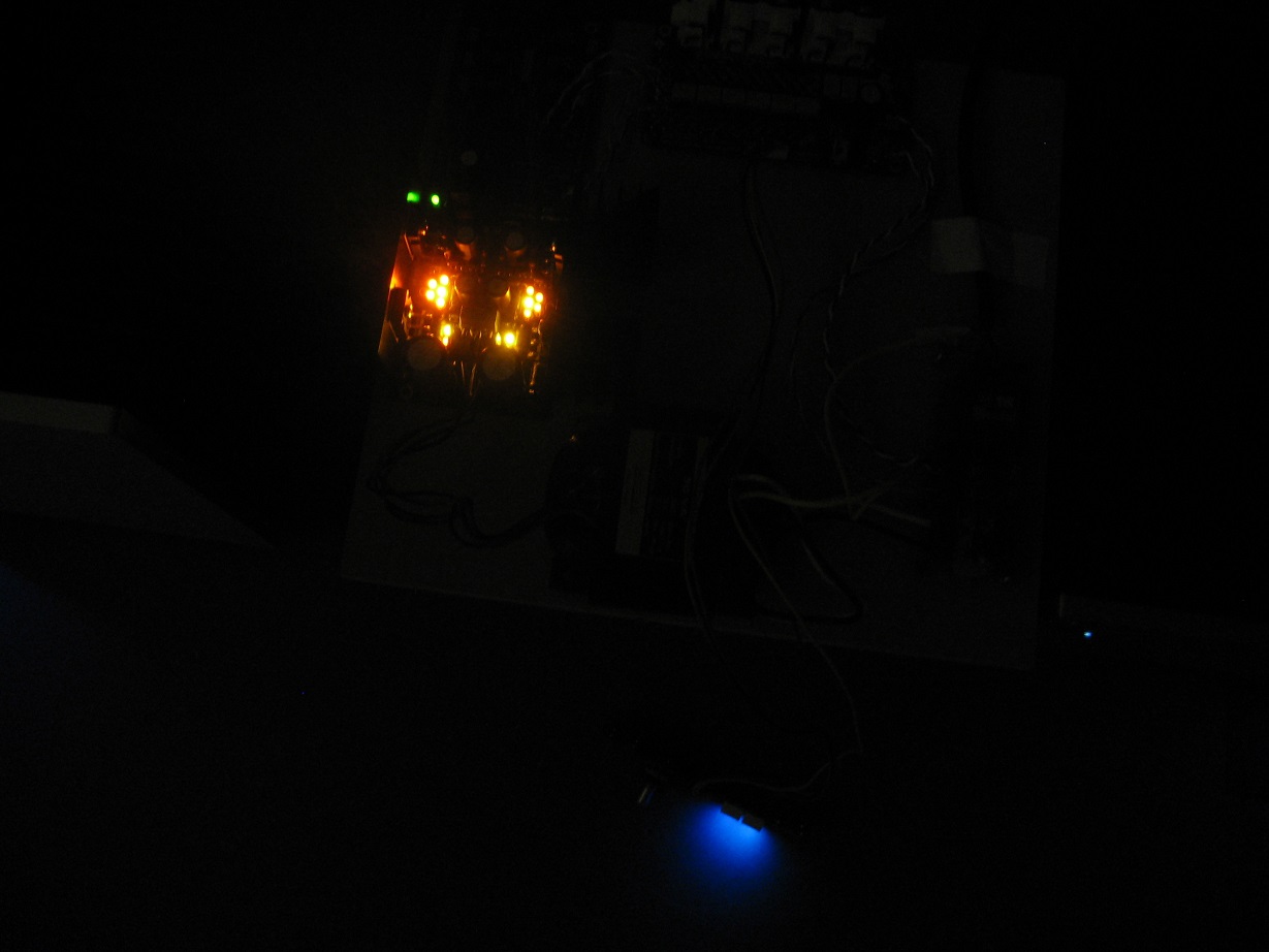

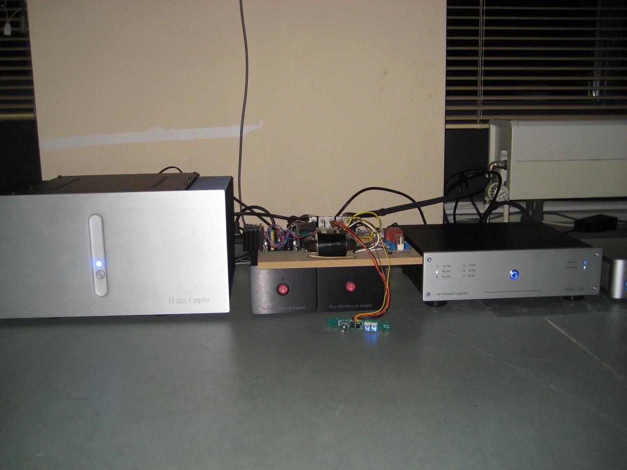

In the pictures you see the DCB1 between my DDAC1794 and my F5Tv3.
Nice thing is, because I used orange and yellow LED's, it is giving a nice tube filament like, glow in the dark 😛
@Salas; THANKS for all your effort and support !
I listened a few days to the not 'leg-tricked' version with around 0,5 Volt difference between + and -.
What should I have heard in difference? Some more second or third harmonics? Some warmer sound?
Asked by someone without 'golden ears' 😱 I don't hear it.....

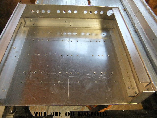

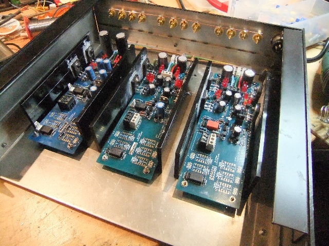

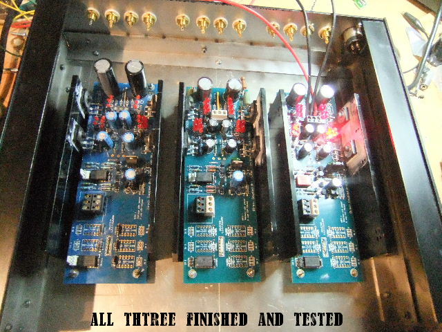

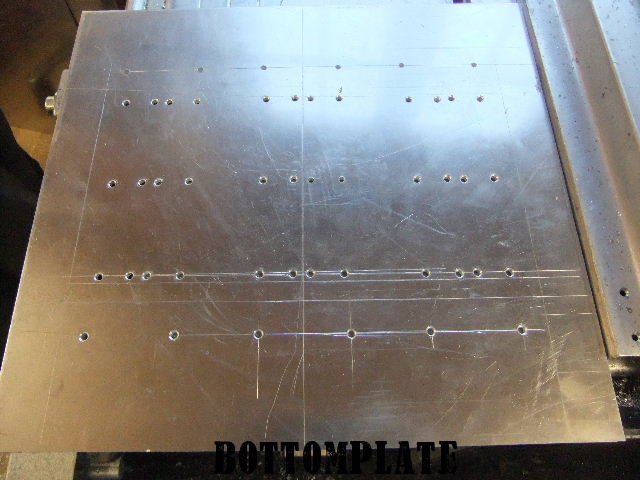

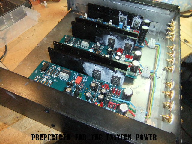

Here is the results of this week-ends building Mezmerize for six channels. This unit might, if the listening results will be what I hope for, "take the place" to my six channels Copland CVA 306 (tube) in my system. It will be hotrodet with a power in its own chassis(4x18000 uF/200VA trans.) I have ordered six attenuators (20 Kohm).
Eivind Stillingen
