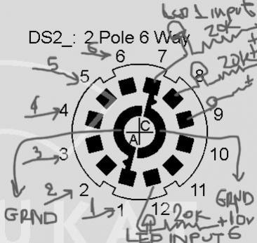

Actually it's still not clear to me as well how to connect the input selector. I have 7 pins. What do I have to connect to the common pole of the selector ?
There is text beside the pin row, SELECTOR 1,2,3,4,5,6,GND.
So the pin closest to the text is GND and connecting it to the 1,2,3,4,5,6 pins will drive the corresponding relay.
Hopefully this helps.
