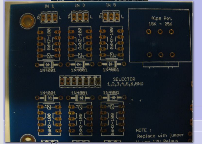

A couple of clarification points if I may to ensure I have read and understood the circuit/pcb.
From what I can see there is no seperate signal ground output as per many of the chip amps, but instead signal ground simply joins to the centre tap and thus grounds that way. Is this correct? (it appears to be from looking at the circuit board).
If also assume I don't have to populate all of the selector relays if I don't need them all, correct?
Finally, where it says GND at the selector text then I assume all the input ground wires go to this terminal connection. This would seem logical and make sense to me.
Another perhaps silly question, but one that is perplexing me, albeit I have come up with an answer in my own mind, but want to check.
The question is around how to wire the rotary switch for the relays.
With a non relay design then I'm comfortable with wiring the inputs to a rotary switch. However as the inputs from the RCA's are directly connected to the relays, the standard pole/way wiring will have to be different.
The solution as I see it is with the 2 pole/6 way switch is to have connections from each of pole A's "ways" connected to selector inputs 1-6, and have a ground wire from pole B connected the Grnd input of the selector.
Is that a sensible/working solution?

I understand what you're saying, but am confused how that translates to the Mezmerize board.
I've included an image of the area that is currently causing me confusion - the area on the board titled selector. How would I translate your explanation into wiring the rotary switch using the "selector" area on the board? Would I still need to take a feed from the 12V regulated relay supply (I'm using a 12V relay), connect that to pole A on the switch, and then run a wire from Way 1 to the input at selector 1, a wire from Way 2 to the input at selector 2, and so on?
If so, what is the purpose of GND in the Selector inputs? Each of the relays allows you to connect left and right "live" inputs from the RCA's, plus the "ground" from each of the RCA's. For example, IN 1 in the top left corner of the image has three through holes - one for the left input "live", one for the right input "live" and the third, middle one, connects to the centre tap connection via the PCB rails and a small jumper. This I have assumed is for the signal input grounds to go to earth.

Its all ready there for you. There is 12V supply on board -connected as it should, you do nothing- and there are 1...6 positions for the steps pins and gnd for the switch's output pin. Half a stereo switch does the trick.
