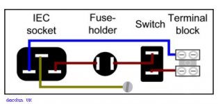

Re: fuses.
I have a couple "through hole" style fuses (slow blow). I have a IEC terminal at the back of my chassis.
Would you solder one end of each respective fuses to the appropriate IEC terminal and the other end of the fuses to the respective primaries of the trafo? So in other words fuses in between IEC and primaries. Anybody not use fuses on their DCB1?
I don't use nor add fuses to my DCB1.Re: fuses. ................. Anybody not use fuses on their DCB1?
I do fuse the primary feed to the transformer.
Being in the UK, my plug top is also fused and the distribution board has MCBs and RCCBs.
I don't consider that the DCB1 can gain any safety benefit by adding in some LV fuses.
Salas' reply is also to fuse the primary feed to the transformer.
