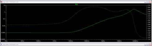

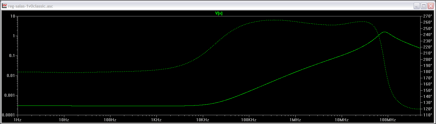

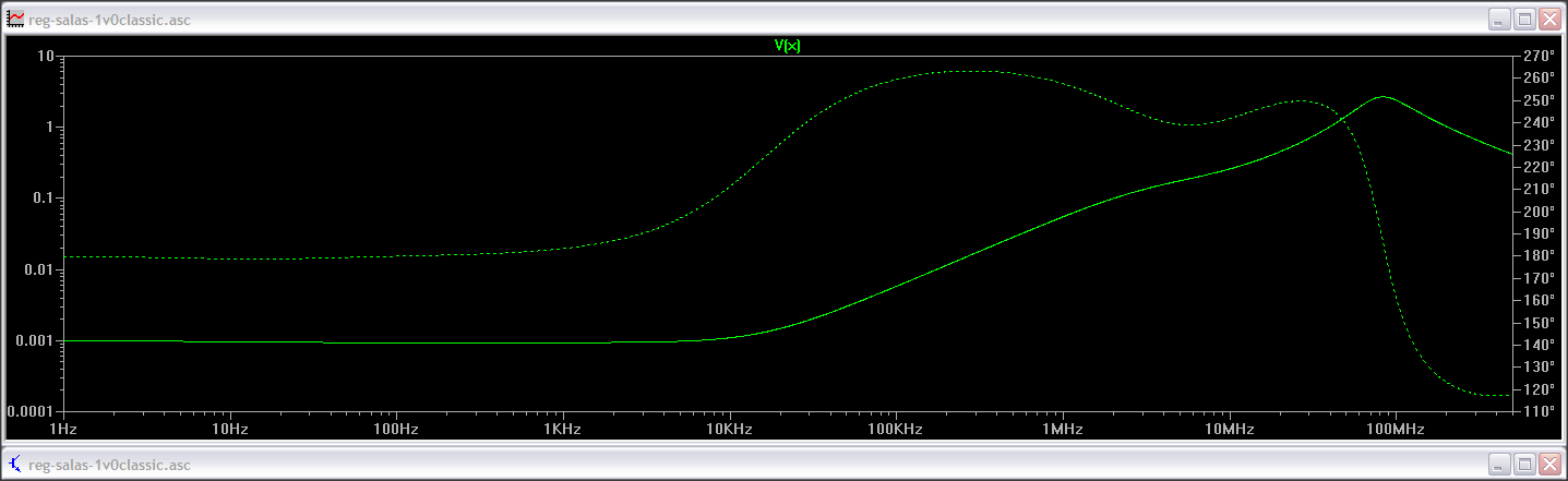

But the models can be weak up that high and the real MOSFETS behave much better in RF with more current...? For up to 1MHZ region I have seen AP results for the 1.1 PSU from Jack and they follow for sure. Actually, they had been a little better than the modeling itself. I used the same analysis method and library here.
