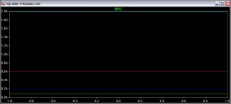

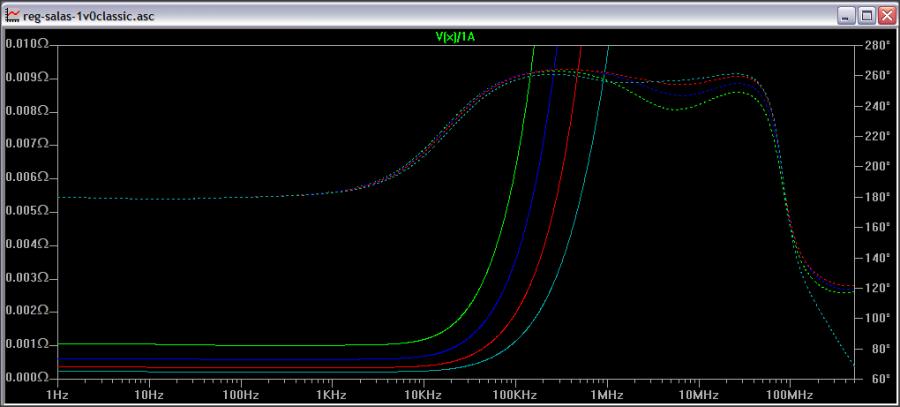

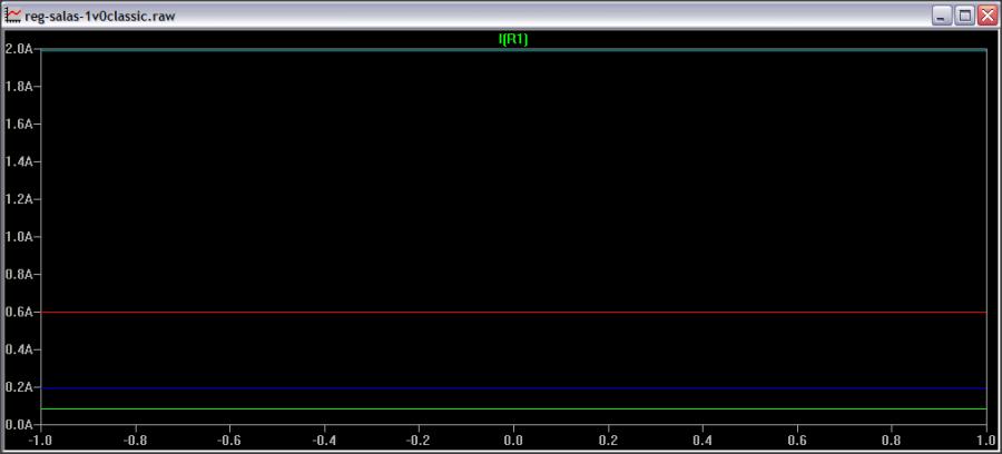

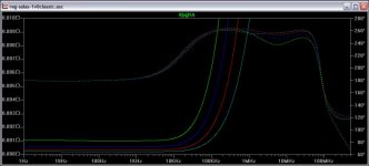

Here are a couple of LTSPICE screens I had made once about the PSU current levels and its Zo curves. Now, we can say that from 1 milliohm to 1/2 milliohm its no big deal. But another one may say, hey its double the damping factor to the load if you look at it differently. Blue line is the 200mA level. Then on it gets difficult to gain Zo. Still the HF knee progresses.

0.0005 from the 60mA to 200mA bias choice for instance? That one plotted tier at least all seem to report appreciating. Super rudimentary variation from the buffer to its load behavior I would suppose. Should have to do with listening to the PSU itself as it can be argued its in the signal path itself as the total current closes its loop?

But he can hear 60mA to 200mA? Its from 1mil to 1/2 mil again.
Then maybe it's not the change from 0.001ohms to 0.0005ohms in the audio frequency range that is affecting the performance of the Buffer.
Look at the impedance in the frequency ranges outside audio.
There the impedances are very much higher. Small changes in the very low Rs values around the audio frequencies may not affect the audio performance of the Buffer.
I suspect it's the tens of ohms change in impedance in the 20kHz to 10MHz that might be affecting the Buffer performance. That's where RF interference attenuation may well be affecting Buffer performance.
I am suggesting it's NOT the low impedance that is giving the change, it's the interferences that are being reduced by avoiding high Rs in the RF region that may be heard.
Simulation may be able to show this if the appropriate parasitics are included in the model.
It's here that decoupling of the Buffer's supplies may show the effects that are being heard.
