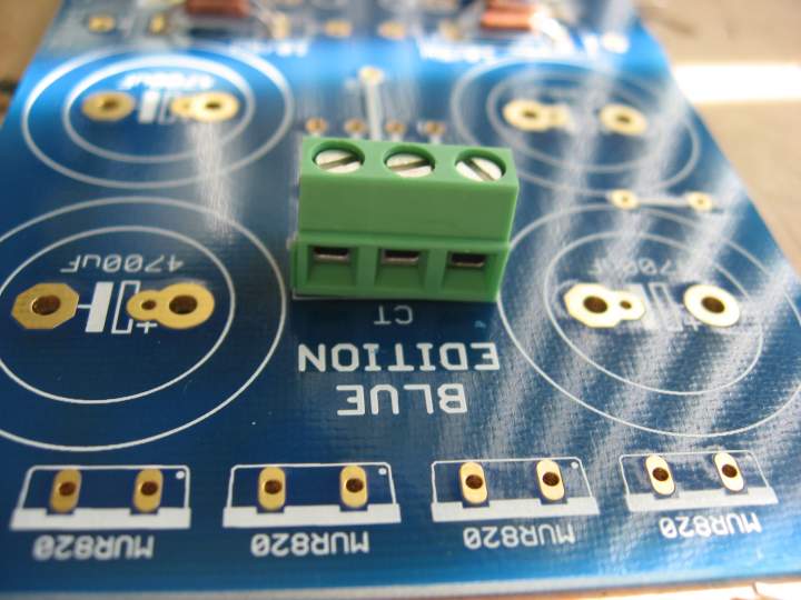

I purchased the Mesmerize board from DiyAudio store.
This board seems to have different main filtering cap size requirements than most of the "Blue" boards which are posted in this thread. ( I didn't see that before ordering) I'm referring to the 4700uF rated ones.
The BOM says Min. 35V, 22mm wide, with 10mm lead spacing.
This board requires ~20mm (Max?) measures 18mm wide and 7.5 lead spacing.
I'm having difficulties finding a high quality cap in the recommended value that fits this size format.
I'm sure others have run into this issue as well. Any suggestions would be greatly appreciated.
Would it be OK to just solder a couple of short legs on a snap in cap?
Heck, I'd even be OK with soldering them on the underside of the board. (may be my only choice)
The Hypno. has 4 caps the Mez has 2 caps. Is there any advantage to increasing the capacity from 4700uF to say 6800uf?
Thanks for the help.

The DIYA MEZ used the same gerber as the original Mez (mkII blue). If you got some good caps you wanna utilize be creative with their fit by all means. But use some elastic goo to bond them bases to PCB. If you gonna run it at high current, 6800uF is OK.

Hypnotize are different in PCB details indeed. Because geared up for even heavy hot rod, their filter caps are 4, can be fatter & snap in (2 pitches served), their CCS resistors positions are roomier.
Yummy that new cap. I would taste it if in your shoes. Nichicon has a line of such marketing caps that users seem to like, so it could be a decent good cap at the very least. See also FG series.

You could get a couple of FG 3300uF/25V for now that I saw in stock, until deep August dispatch for KA?
Just FYI, I used Panasonic FC 4700 uF 25V, and am happy with the result. About half the cost of the Nichicons, but many folks like the Nichicons in general. A higher-voltage part is usually a good idea, especially for electrolytic caps. At risk of heresy, I don't think the brand/type of filter caps makes a significant difference; but then, I guess if I really believed that I wouldn't have bought the Panasonic FC's (there are cheaper capacitors available). So that raises the question: What are the measurable properties of a capacitor that make it "good" in that application? I would assume that low ESR, low DF, and high temp rating are all good things to guide a choice. Other than dubious listening tests, are there any other objective criteria for selecting filter caps? (yeah, I know there are whole threads dedicated to that discussion)
The lower the DF & ESR, the lower high frequency impedance the better are the objective criteria. The smoothness of the paper's fibers used in the winding and some properties that the manufacturers know in the chemical its soaked with are their ''claims'' area. DNM (BHC) had slits on the foil and had some more objective explanations about eddy currents in their literature. http://www.youtube.com/watch?v=kU6NSh7hr7Q
