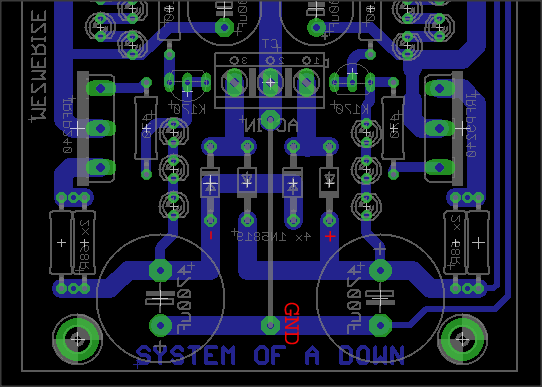

Is it possible to input DC into the Mezmerize board and increase the PS filtering? I have a separate good PS board, just curious.

If you will go directly to the filter caps positions you can feed DC there. Use some cap there at least 100uF to decouple the incoming DC wiring. Watch the polarities. You don't need to populate the diode positions or the Tx connector anymore of course.

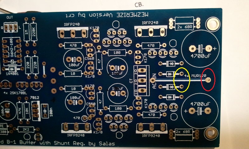

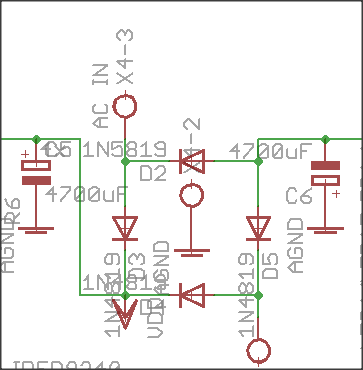

Thanks Salas,
Just to make it perfectly clear to me, 'cause I don't want to screw this up and I'm unsure of what I'm doing, please confirm this for me. Photo below.
1) The capacitors SHOULD be installed + / - as labeled on the board. (Caps are 4,700 uF 35V Nichicon Gold Tone)
2) The Red circle should be connected to the - negative DC input
3) A jumper installed across the Green oval , and the + Positive DC input should be connected here.
4) All jumpers on board (to connect -) should be installed.
Don't short AC-in jumper with + jumper at Green oval ( 8-0 )
Do I have this correct?
Thank you VERY much for your help.
Ron
1. Install 100uF 35V wiring decouple capacitors where the 4700uF are designated. If you want heavier local caps, your choice. White stripes are (-). Used to be a rock band duo also but that's OT.😀
2. You connect incoming GND wire from your other board raw supply there, see pics.
3. No new jumper in the specific area than the long white one. In double sided boards should be a via under the white ink also if you will do a continuity check with your DMM, but do reinforce it. All other printed jumpers ditto.

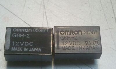

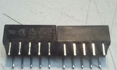

I've scrounged some Omron G6H2 relays from various sellers, Is there a way to tell if they are counterfeit?
Some have printing on the side others don't.
Got a guess?

For OMRON I am not experienced, may others will see and tell, but for NAIS I have got other made in Japan, other Made in Germany, the printing was not the same.

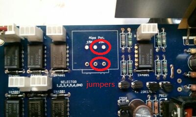

Salas,Thank you again for your help and sharing your time.
If I want to use a separate volume controller on a different board, can I jumper these two pair of outputs? I want to run the audio to a different board that has it's own attenuation.
Thank you for answering my strange questions.
Ron
Ron
Yes, you can continue the signal route there. You should get 220K input resistance if you will measure across an engaged input.
