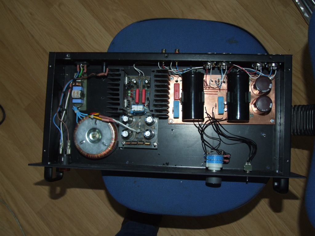

I used DALE 1% Metal Films in the signal path.
There was much more improvement to made with the caps.
I used Siemens 1.0uF MKP caps at the input and Oblligato 10uF PIOs at the output.
Again, the difference is subtle and definite snake oil territory.
You wont fit these caps on a Mesmorize board though. I used a homebrew clone of the original B1 board.
The resistors at the bottom right of the board are not in the signal path so I just used good quality 1% metal films there.
I can't find the original photo so I'll post it again - Apologies to the Moderators.
I eventually used the Mesmorise board as a Salas shunt reg with my homebrew Pass B1 boards.
