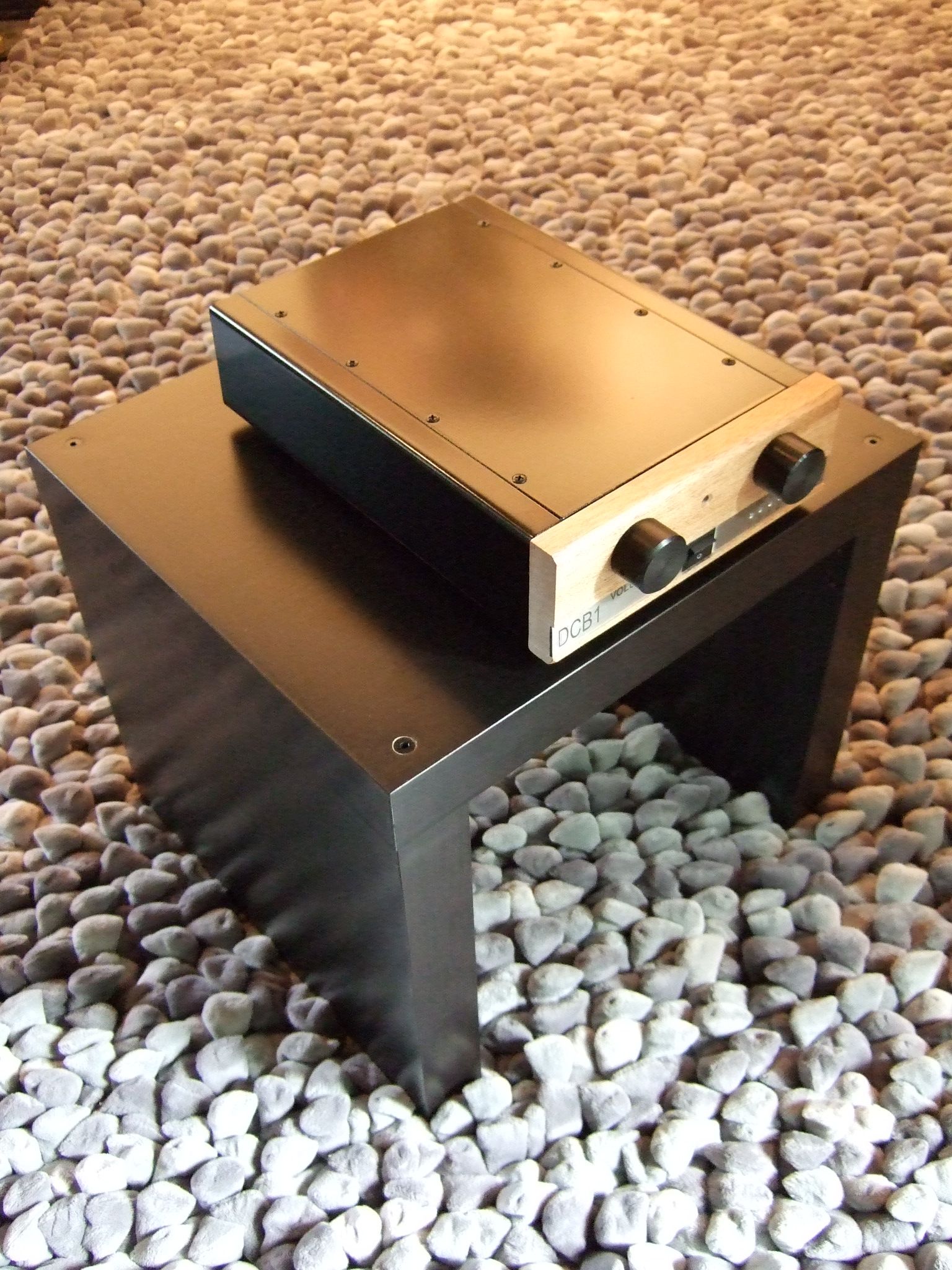

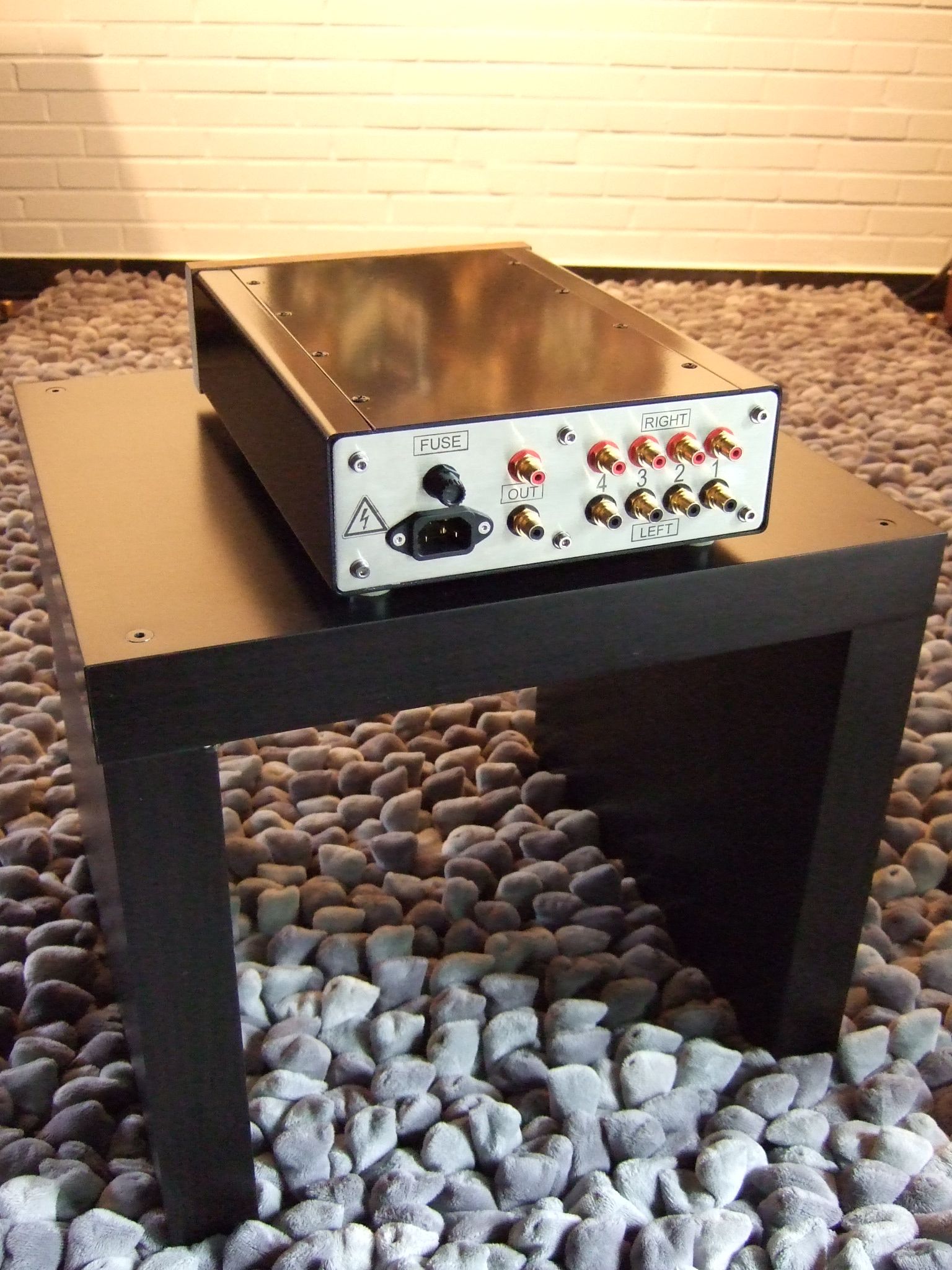

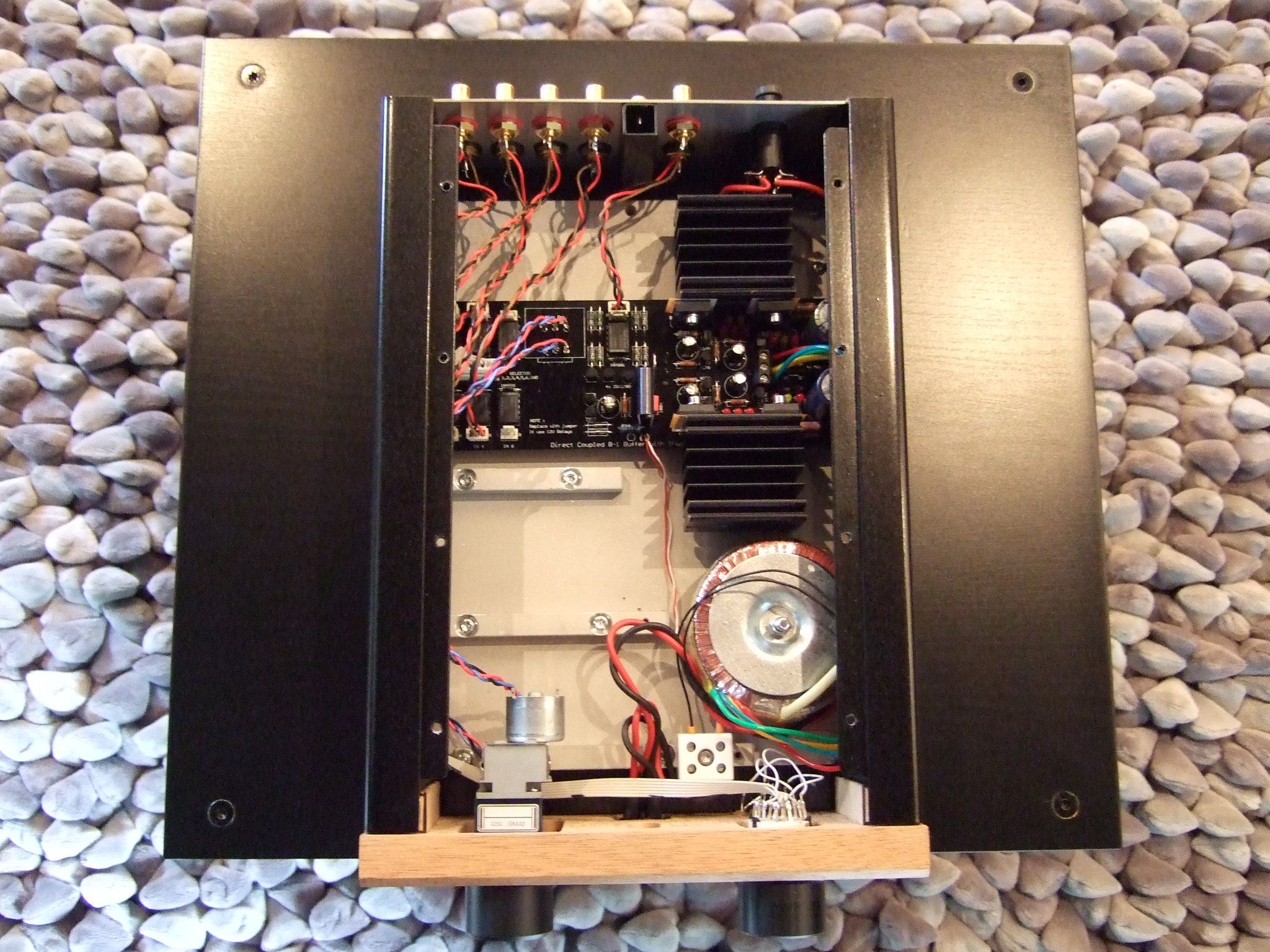

Here are some pictures of my nice sounding Mezmerize.
Unfortunately I forgot to mill some slots in the top plate for cooling.
But in my opinion it`s not realy warm inside (after 6 hours hearing 🙂.
The space inside where the aluminum bars are is for the remote control pcb.
Andreas
Andreas
Nicely finished but your heatsinks are doing virtually nothing the way you have them orientated.
You could cut 3/4 of the lenth of them away and they would be doing the same for your heat disipation.
Andreas
Since its not hot rodded and not warm it should be safe. Spot check the temp on the Mosfets with a thermocouple or thermometer gun at a point if feasible to have a clear evaluation. If nothing is over 60C locally its a pass.
Look back at post #501 to see how to mount the heatsinks more efficiently.
If you are only running at 100mA or so then it probably wont hurt as the MOS-FETs will be running fairly cool anyway.
With the 10R resistors in the photo the MOS-FETs don't really need any heatsink at all. I've just been experimenting with 3R0 and 4R7. At 3R0 even the 2E heatsinks that I used are barely sufficient and the MOS-FETs are running too hot for my liking - allbeit only about 55 Degrees C. I haven't tried the 4R7s yet as I'm enjoyiong it too much.
