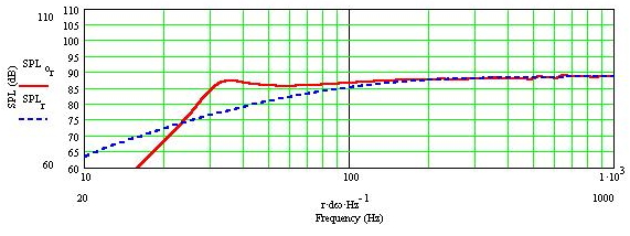

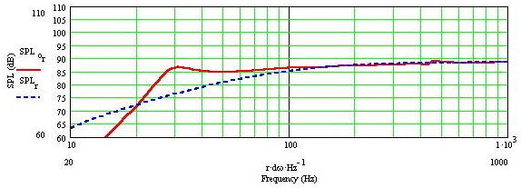

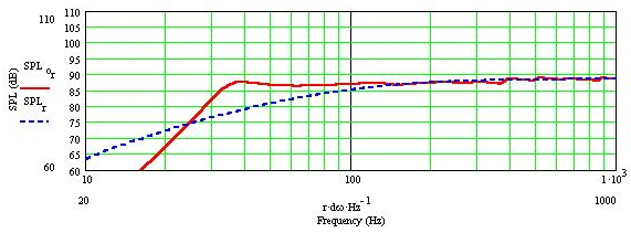

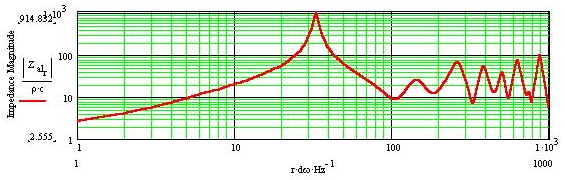

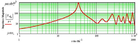

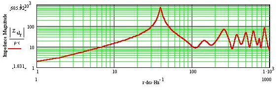

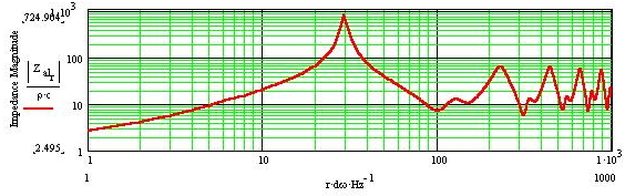

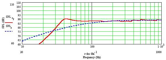

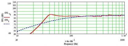

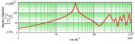

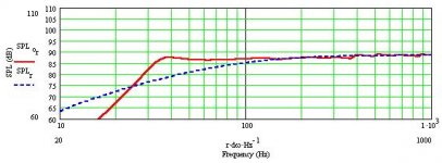

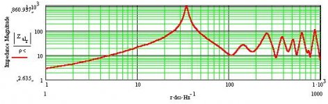

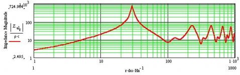

Tom,
I ran models for the dimensions you put in your PM, then for the ones in your DIYaudio post.
First two images are for L=54, Z(d)=24, S(0)=2x4, S(L)=7.5x9.5, D(p)=1.75, L(p)=1.5
Images 3 &4 are for L=60.5, Z(d)=29, S(0)=2x4, S(L)=8x10, D(p)=1.75, L(p)=3
From the impedance plots, you can see that the smaller box is tuned to about 39 Hz, where the larger box is tuned to about 29 Hz. For my taste, the smaller box is the better choice. Don’t know if BSC would be needed. I have used BSC on most of my builds, but sometimes it doesn’t seem to be necessary.
If the port chuffs, then you will need to enlarge the diameter and increase the length. My preference would have been for at least 2” diameter, but if it works for you, then it’s all good.
If you don’t like the 2 dB rise before cut-off, you can play w/ the box dimensions to lower the box Q.
Cheers, Jim

Thanks Jim!

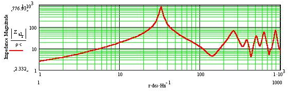

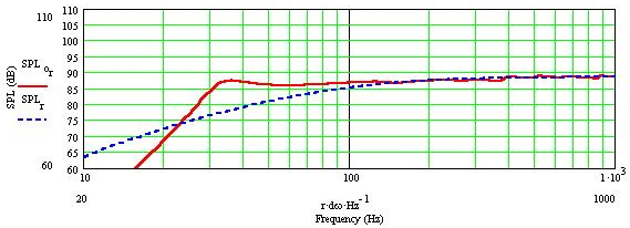

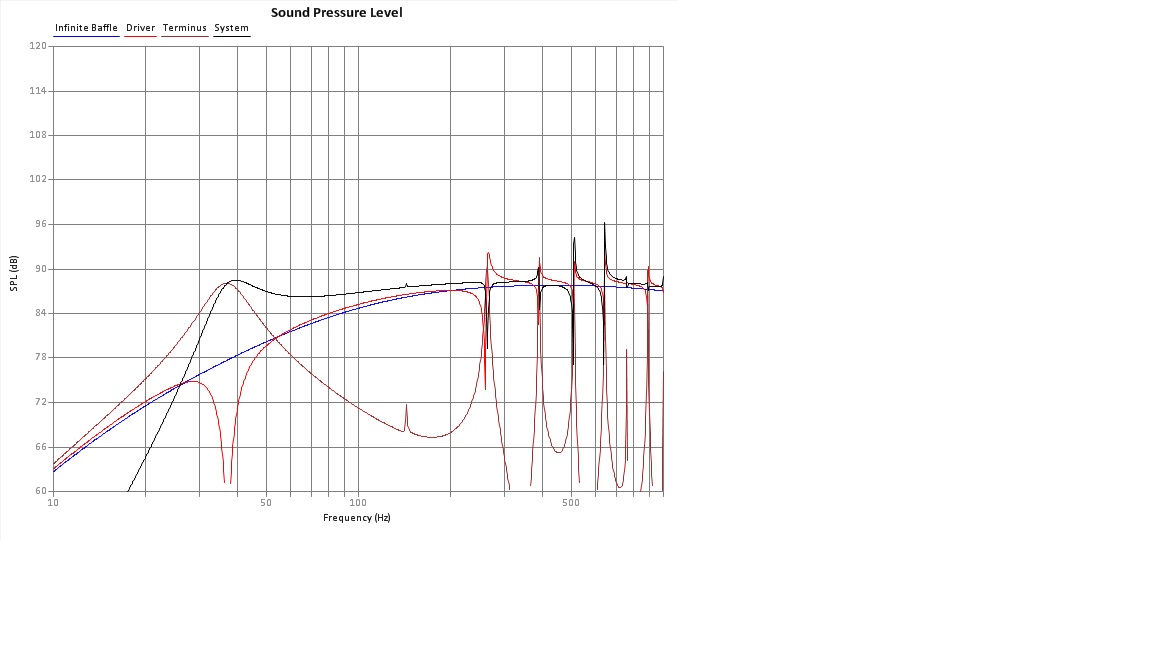

Here is what I got from Leonard Audio, with two chamber models to account for stuffing in only top half:
I agree with Jim, the bump before rolloff is not a good thing to have. Makes for what is perceived as "sluggish" bass.
In general I try to aim for as straight a response until roll off, even sometimes going for a slight downward slope.
It does not give the deepest extension, but a very clean bass response at the expense of a few Hz of extension.

Note that Jim's pictures are for smaller box first, larger box second, and mine are opposite.
Why a port diameter of 1.75"? I ordered port tubes of 4" x 2" but the actual ID was 1.75"!
I am happy that there is such good agreement between the Leonard Audio models and the Martin King models.
I am planning on building a pair of the second box. I learned a lot about building a Met with all those 3 degree angles so time spent building the first box was not wasted. If they turn out they will be at Burning Amp, November 12th.

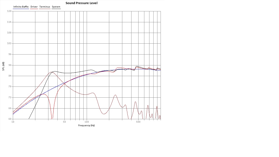

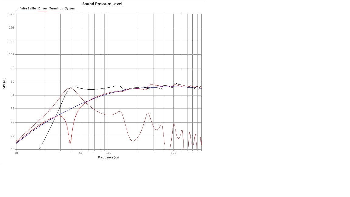

Something Interesting and Final Sanity Check
I continued to make some tweaks to the Leonard Audio model and ran across something interesting: Dropping the driver below the center of the line almost completely eliminates the first big peak. You can see this at the 160hz line in the picture. So is this a good idea or not?
Here are the inputs to the model. LL= 53", Top 2"x4", Bottom 7.5"x9.5", Driver @ 30.25", Vent 1.75"ID by 3", no stuffing (stuffing moderates the peaks).
5/8" Maple ply is in the basement, I'm ready to go!
Try placing the driver at 1/3 of the line length and 1/5 of the line length and check how this would affect the peaks in the response. (both of these should be from the top)
The current driver position is far from ideal from a practical point of view since it places the driver at a mere 23 inches from the floor

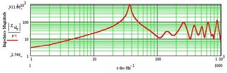

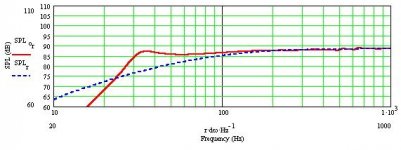

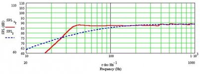

Tom,
Don’t move the driver further down from the top! Bad idea! Please begin by studying Martin King’s web site:
Quarter Wavelength Loudspeaker Design
I ran several sims for you. Images are as follows:
1&2: L=53; S(0)=2x4; S(L)=7.5x9.5; Z(d)=30.25; D(p)=1.75; L(p)=3
3&4: L=53; S(0)=2x4; S(L)=7.5x9.5; Z(d)=23; D(p)=1.75; L(p)=3
5&6: L=53; S(0)=2x4; S(L)=7x9; Z(d)=30.25; D(p)=1.75; L(p)=3
7&8: L=53; S(0)=2x4; S(L)=6x9; Z(d)=30.25; D(p)=1.75; L(p)=3
In the sims, I did not add series R, which would increase effective Q(ts) of the driver; if I were running the sims for myself, I would add 0.5R to account for speaker cables and connection resistance; exact value depends on your cables & connectors.
Look at how the bump before cut-off decreases with the reduction of V(b) in the last two cases. And I still might push the tuning up a bit higher as well; I might target 40 Hz region, then see how the bass looks relative to the lower mids. Again, no idea if BSC will be needed—depends on your room & speaker placement, among other things.
NOTE: I did not check to see if the driver will fit, i.e. clear the back panel; a supra baffle may be needed for the driver to fit; also check to see that the baffle or supra baffle is wide enough to hold the driver.
Please excuse any bluntness or errors, I'm just back from a bit of oral surgery & not in my 'happy place'.
Cheers, Jim

Thanks Jim, lots to think about.
The MJK model confirms that the 30.35" driver placement kills the bump at 160hz, but perhaps at the price of a hole, and maybe larger higher-order peaks. I think I will explore moving the driver up at bit, accepting a bit of a 160hz bump. A half inch shorter vent will shift the tuning into the low 40's. I have an extra vent tube, so I will cut it progressively shorter until I discover what "too short" is.
The driver won't fit in the box at 23" with the current design. In any event the main panels have been cut, so my only options are moving the driver up to 25" or so, and varying the line length by an inch either way.
