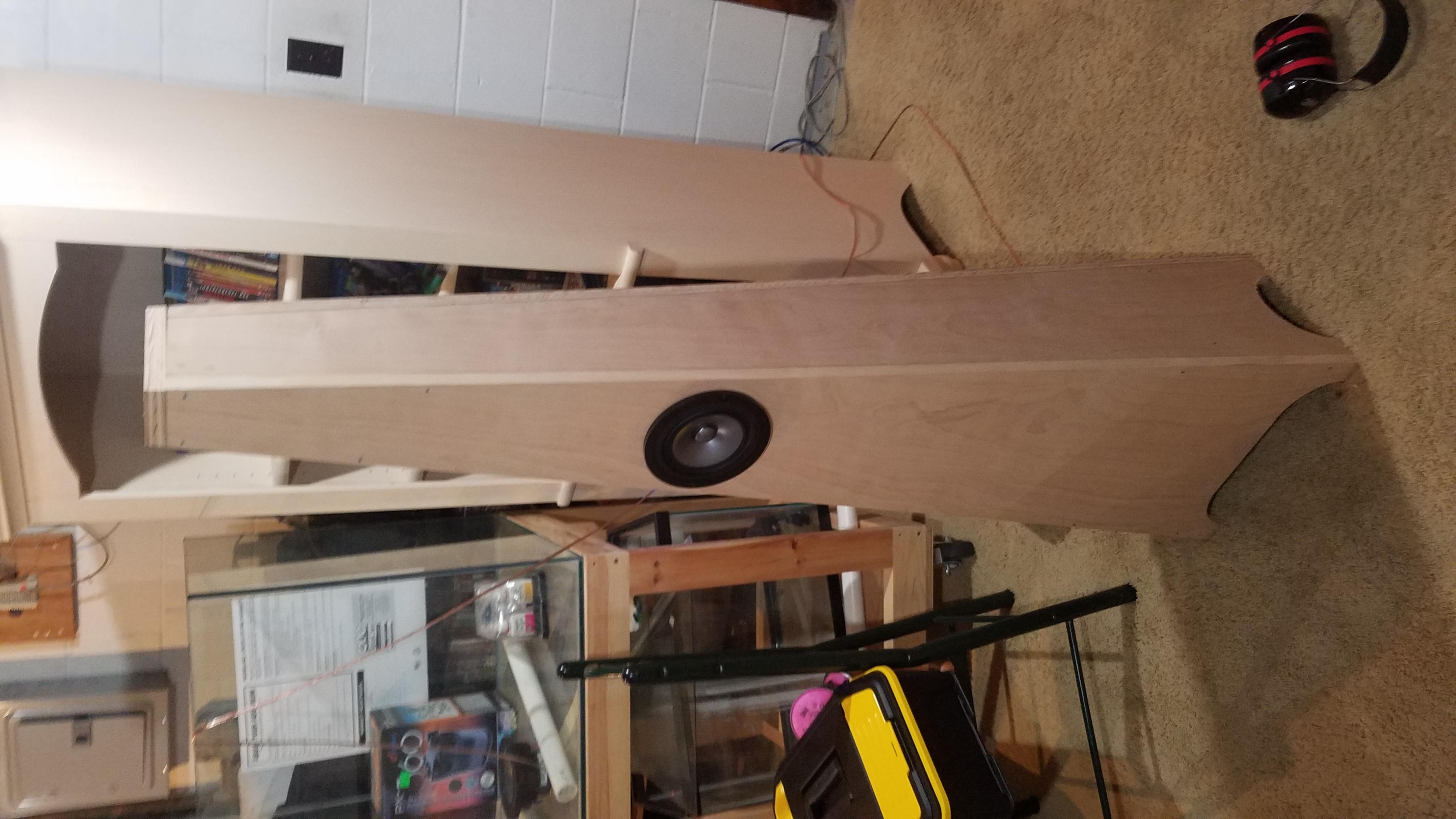

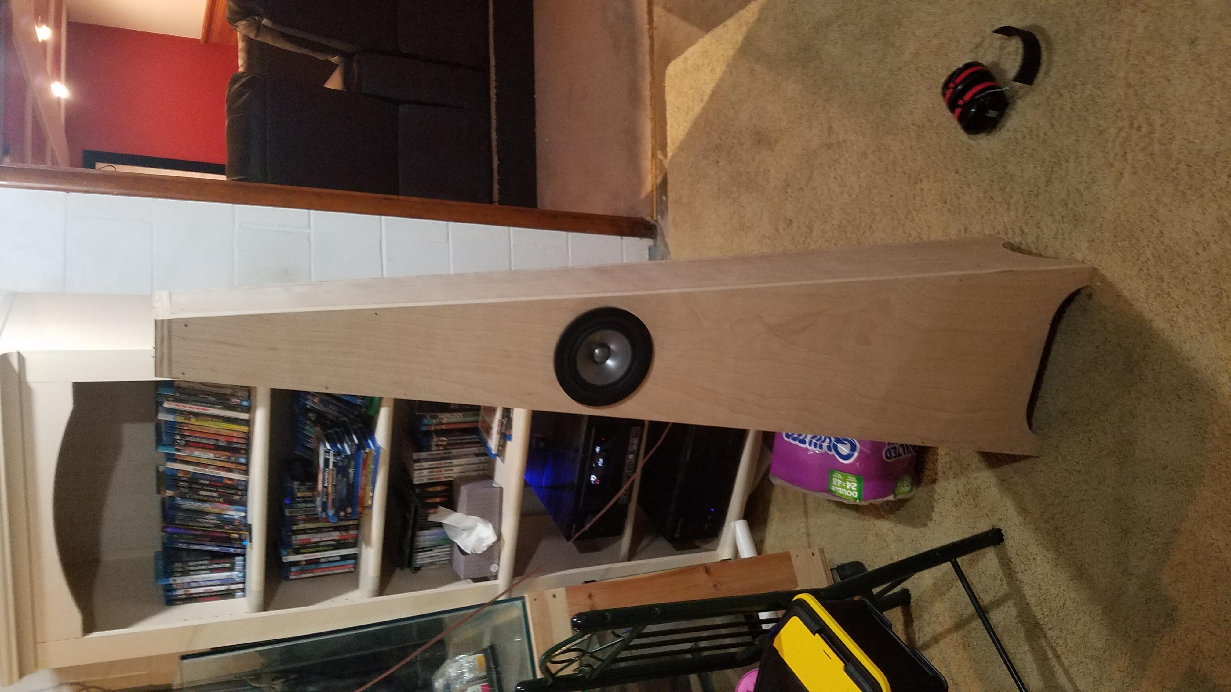

Here's some pics of the prototype.
No can see, get Google 403 error.
GM
GM
Until all the panels are sealed (oe glued) any comments or evaluation are probably premature.

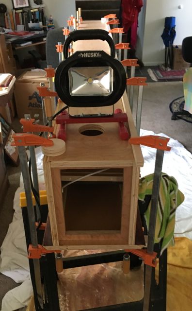

I do a dry fit-up before getting the glue out. Below is a photo from my BIB build showing the LED work light sitting on top of the the BIB. I shine the light into the cabinet to see if there are any light leaks. If there are light leaks, then either the clamps need repositioning or a sanding block needs to be used. (I use masking tape to mark where the clamps will be positioned when I do the glue-up.) Once there are no light leaks, then the glue should provide an air-tight seal.
Cheers, Jim

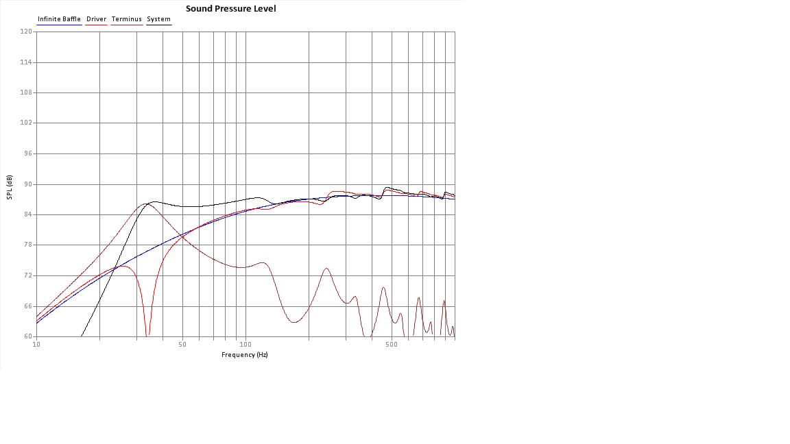

I built a single speaker prototype, not too happy with it. No mid-bass and muffled. Maybe I have too much stuffing?. Maybe it has too long a transmission line for this driver? I used Leonard Audio software to design it and here is what it predicted:
Leonard Audio Model
60.5" line length
Driver at 29"
Top 2"x4"
Bottom 8"x10"
Vent 1.75" ID by 3"
The model is divided into 3 sections:
Rear.0 Top half with stuffing
Rear.1 Bottom half, no stuffing
Rear.2 Vent
3.6
