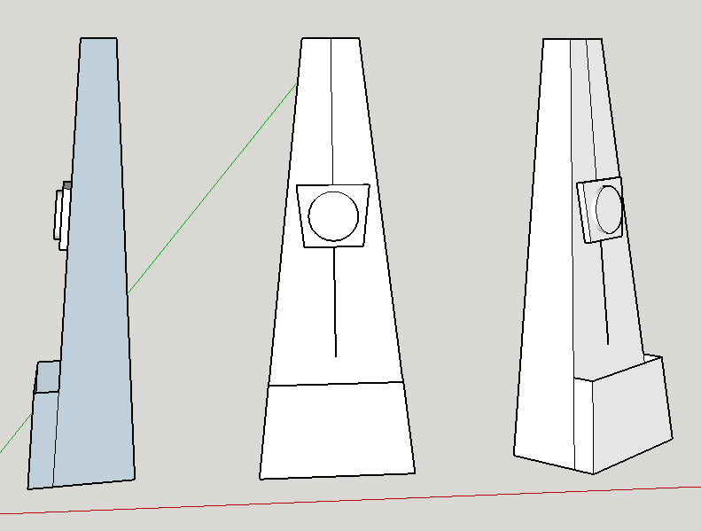

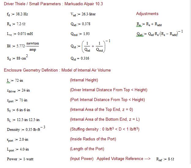

Version 3.0 hot off the presses w/sketchup mockup. Tuned to ~36hz. Idea here is to put the vent into the front panel and opening up the top (of the vent not the whole cabinet). Essentially, follow the shape of the front w/3" depth. Start area ~60"^2, end area ~45"^2, length 12". Overall the cabinet is 56" tall, base 10" x 20" (not counting the "port" which adds 3"), top is 7 3/8" x 4 3/8" keeps the same aspect ratio of the base. Also I kept the back 90 degree angle with the other three sides sloped. I've left the amp at 0.1 to hopefully allow for some room boom in the low end. So, theoretically, this could go against a wall. I've included sketchup files (just rename to *.skp)
*** note all measurements are internal.

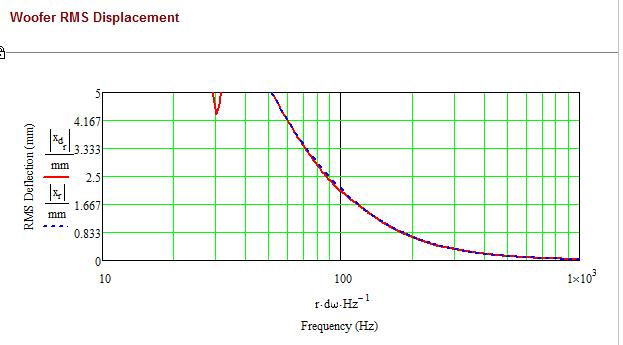

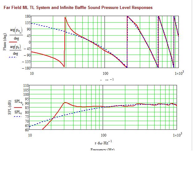

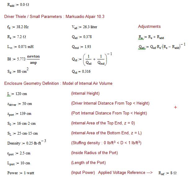

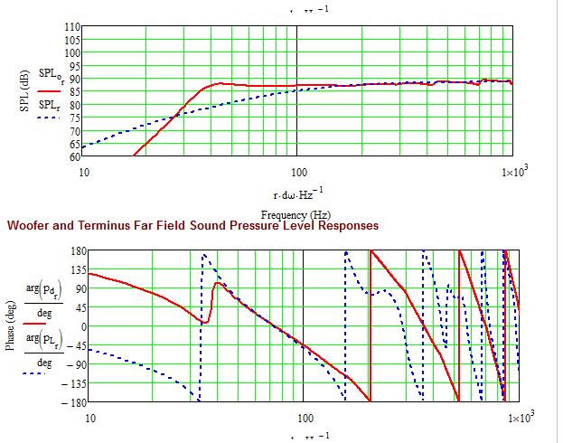

Count Sudoku, I have run your previous enclosure in Martin King's mathcad worksheet.
Check out the graphs below.
The last one represents the driver's excursion versus frequency at one watt (noting that excursion is RMS, meaning that to get actual excursion, multiply by 1.41)
the blue line is the driver in an infinite baffle, while the red line is the driver in the enclosure. As you can see, excursion control is minimal and over a relatively very narrow bandwidth.

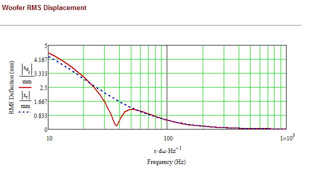

Thanks. Help me understand... on the woofer RMS, chart 1w@20hz the cone is moving ~4.23mm one way (assuming RMS 3mm*1.41). Xmax for the 10m is 7.5mm one way. So, at 1w, the cone is still well within its specs. What would the graph look like at say 16w? Also, what does the dip at 30hz mean? More control, or less?
Well, for every doubling of power, so goes excursion, ergo it increases exponentially, i.e. a doubling of power is = [10]log 2 = ~3 dB and 16 W = [10]log 16 = ~12 dB, so 12/3 = 4x increase = driver tears itself apart, letting all its smoke out 🙁.

ok now this is interesting.... i put the pensil 10 and it has nearly the same curve (without the dip at 30hz) as the giant metronome. so, how then does this speaker not destroy itself with even modest power in a normal enclosure? One possible explanation I can think of is perhaps the software is showing displacement as total movement in which case the danger zone would be around 10mm on the graph.
If there's no/not enough room, boundary gain to offset it, then you'll likely hear its VC bounce off the motor's back plate on dynamic transient peaks and likely burn up the VC on a sustained low note.

One possible explanation I can think of is perhaps the software is showing displacement as total movement.........
No, it's one way [Xmax] unless some other value is inputted. As I just posted/implied, it's about the recording's music power distribution, room gain, average Vs peak power SPL at the listening position.

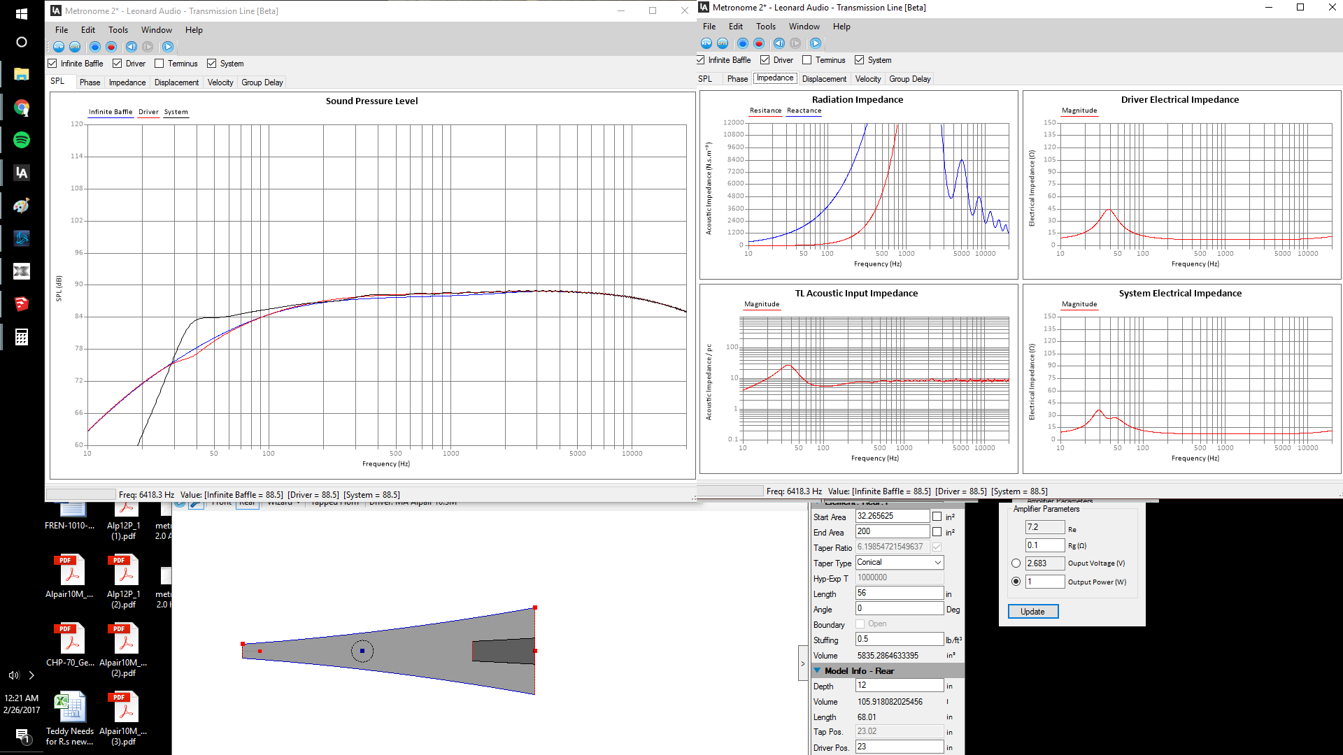

Here is my take on a metronome for the 10.3
I am sure it can still be refined.
As you can see, it ended up being quite smaller and shorter than the previous iterations.
