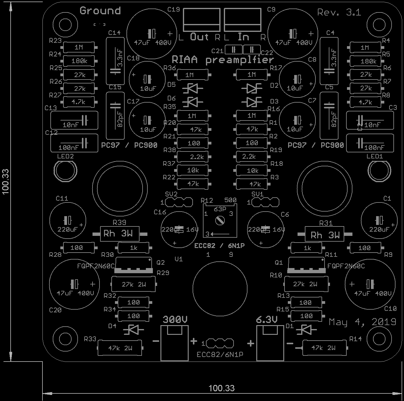

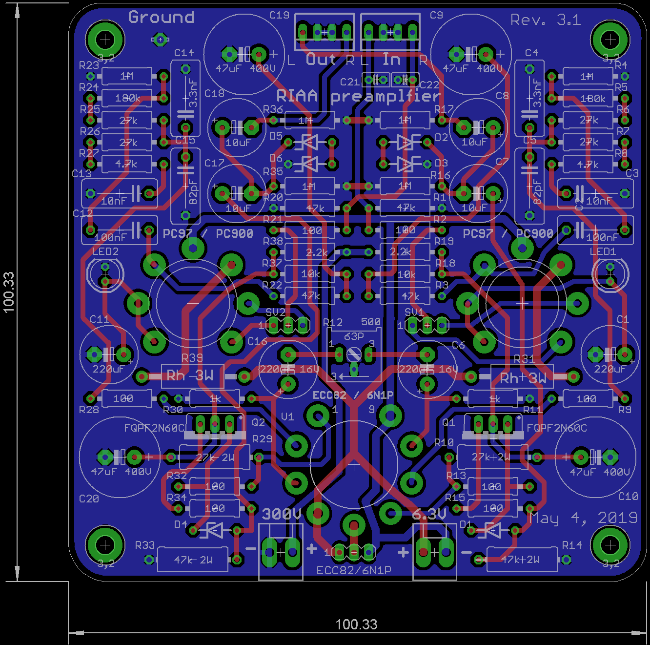

OK, finally I made the cosmetic change and I think the PCB is now ready for production if someone is interested to test it 🙂
May be Peter if you have a lot of PC900 you could make a kit with 1 PCB + 2 tubes ? 😀
I put the last version below, it is also possible to use a smaller MOSFET : the STU9HN65M2 This is what I am using in this RIAA preamplifier and in the Baby Huey amplifier, a very good device 🙂
Marc
Marc

I have some EC97 I'd like to use for this, so I would absolutely be interested in purchasing a stereo board set. Is that one audio pcb and one power supply pcb? Just the boards for me, I have parts...
If you are using EC97, EC900, 6HM5 or 6HA5 which are all 6.3 V heater, Rh the dropping voltage resistor must be by-passed, it is the best solution however these tube are not easily available and are often much more expensive than PC version 🙂
For PC97 4.5 V heater ( https://frank.pocnet.net/sheets/030/p/PC97.pdf ) Rh = 1.8 V / 0.3 A = 6 ohm, 5.6 or 6.8 ohm 3W will be OK
For PC900 3.9 V heater ( https://frank.pocnet.net/sheets/010/p/PC900.pdf ) Rh = 2.4 V / 0.3 A = 8 ohm, use 8.2 ohm 3W...

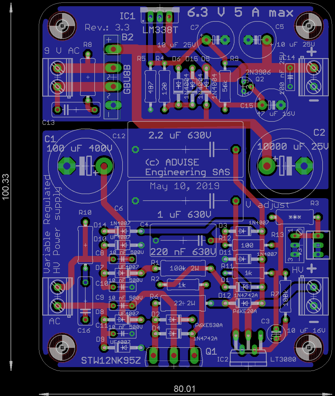

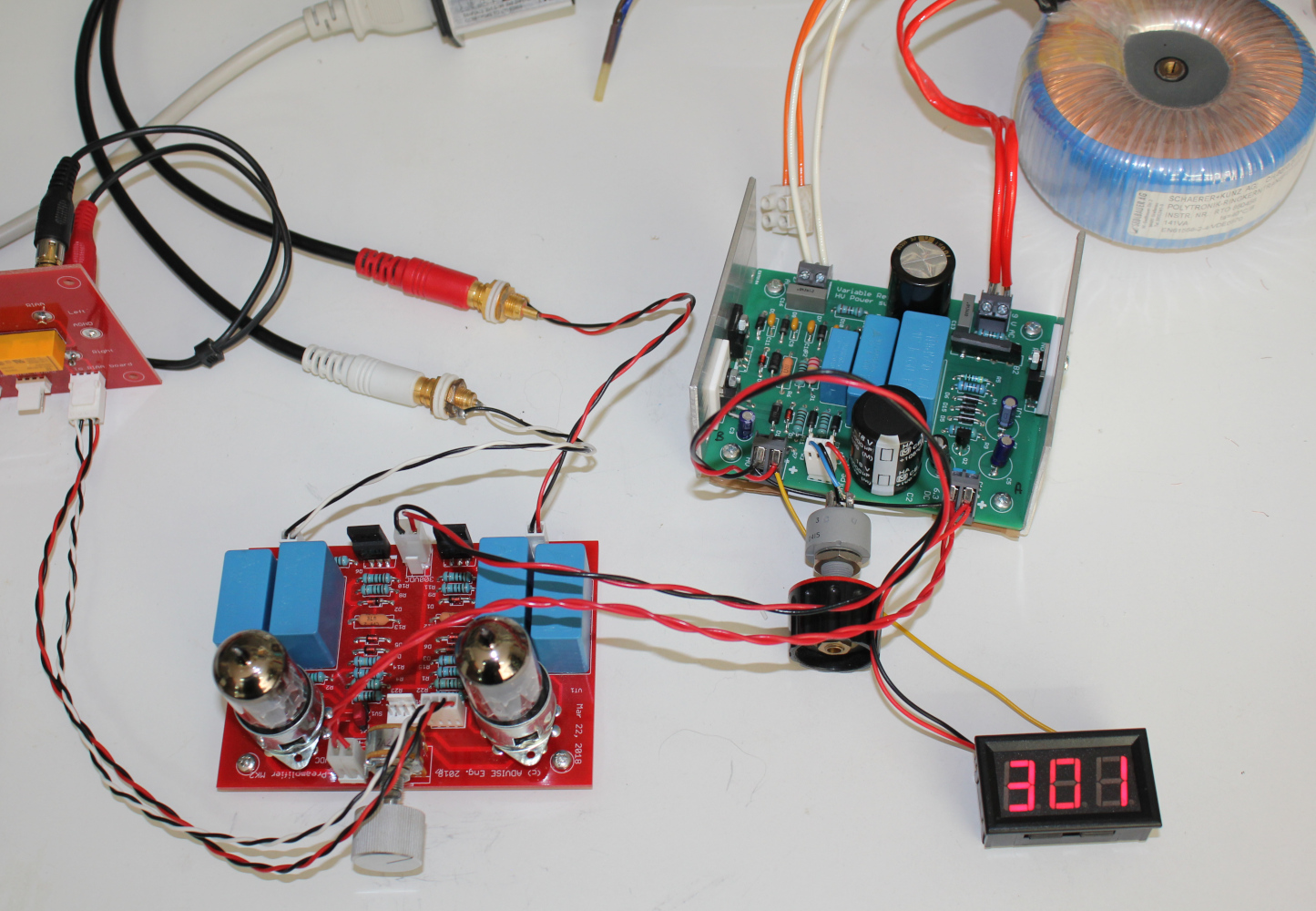

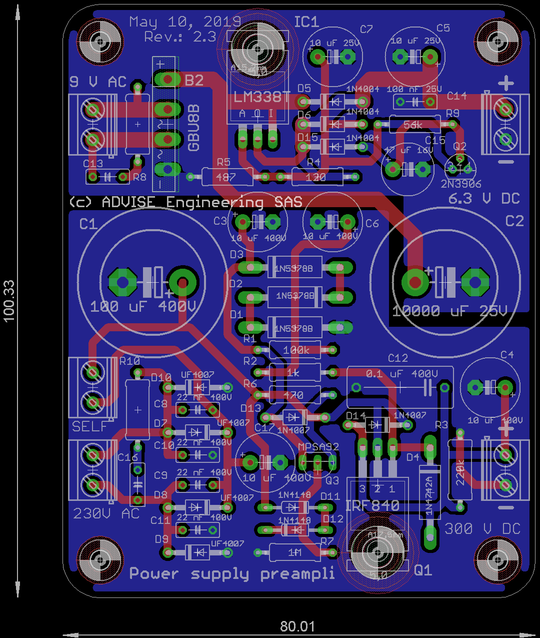

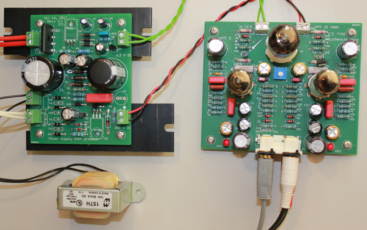

These are two possible power supply for the RIAA preamplifier or the Line preamplifier, both have been built and tested in different systems. I have no more original PCB therefor I made a refresh of these two design with several little improvements, if someone want to make a Group Buy I can send him the Gerber files ? But I am not sure that there will be enough interest, may be Prasi is reading this thread 😀
The first power supply use three 100 V Zener diodes for a fixed 300 V output with a common 115 V + 115 V (or 230 V) transformer, the second one can be adjusted with a on-board resistor and a trimmer (or an external pot). It use the old Maida high voltage concept with modern components which give very good result and low noise.
I have added two pictures of these power supply powering the RIAA preamp and a line preamp...
Marc
Marc
I had a plan to use SMPS , one generating 12V DC and one generating 250-300V for
plate. Building a RIAA using that as power would be a good test of this is feasible.
I am not sure that SMPS would be a good solution for the RIAA amplifier since the input sensitivity is only few mV and it is therefor very sensitive to switching noise 😕
