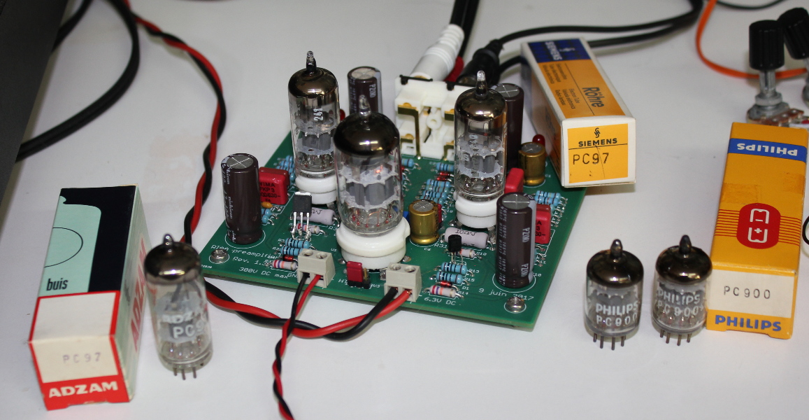

Hi Marc. The jumper looks incorrect for one channel. At least it would be if you are mirroring everything... This could be the source of your problems.
Ian
Ian
Hi Ian,
Thanks for the help, but if you look to post 37, you will see that the jumpers are not mirrored 🙁
I have done that to avoid error and on both channel jumpers should be on the same side and position 1-2 for the PC900 and 2-3 for the PC97... I checked on the PCB and pin 1 of the jumper goes to pin 1 of the tube !
We have to find an other cause for this problem unfortunately.
Marc
Marc

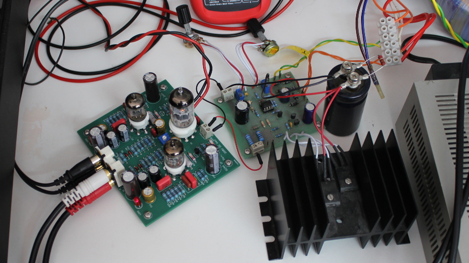

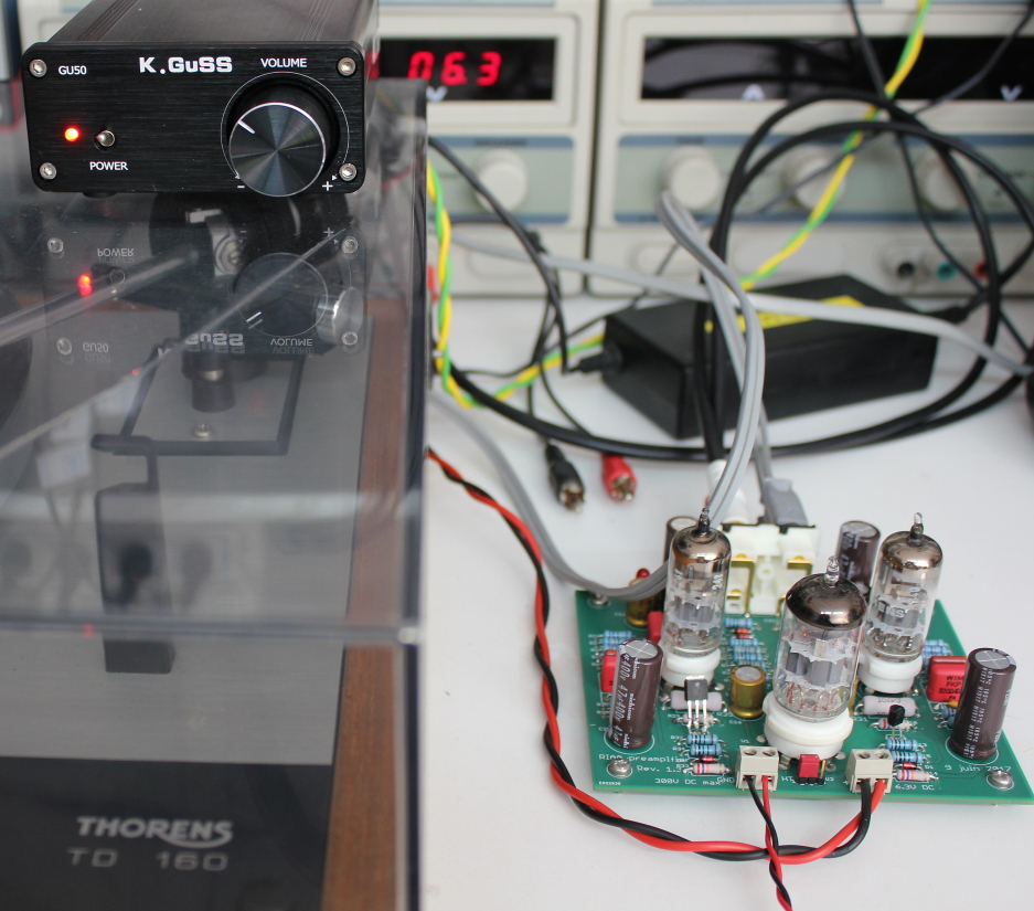

I have made a lot of progress on the test of this RIAA amplifier 🙂
I replaced the dead MOSFET with a STU9HN65M2, it's a brand new MOSFET from STmicro with Vds of 650 V, Id of 5.5 A, Rds of 0.82 ohm and Crss of only 0.85 pF ! It is available in IPAK package (like a DPAK with lead) I have soldered it on the lead of the dead TO92. For the test, I also replaced the old low end Thorens TD280 MK IV turn table with a much better Thorens TD160 and a Shure M95ED cartridge (third photo) ! What a huge difference, now I really like the result 🙂
I have used a variable power supply for the test (first photo) and at the beginning I was using only 150 V DC to limit the power dissipation in the MOSFET but later I have increased the voltage to 250 V, still not the specified 300 V but the MOSFET temperature is already 60°C on the STQ3N45K3-AP and... 80°C on the tab of the STU9HN65M2 😱
Anyway, I have listened many LP all the day while I was working on other things (including the new EL34 / 6CA7 Baby Huey) and I was very happy with the result 🙂 I have also tested PC97 version, and we should not forget to change the red jumpers because it will make a big moise in the speakers, guess why I know that ? You can see on the second photo different tubes and the 252 V on the voltmeter on the last photo.
This RIAA amplifier is now playing very good and the only problem was the power dissipation of the MOSFET (and my bad old turn table which gave me a lot of noise...). I will continue to try to improve it with other TO220 MOSFET that I have received in the mean time...

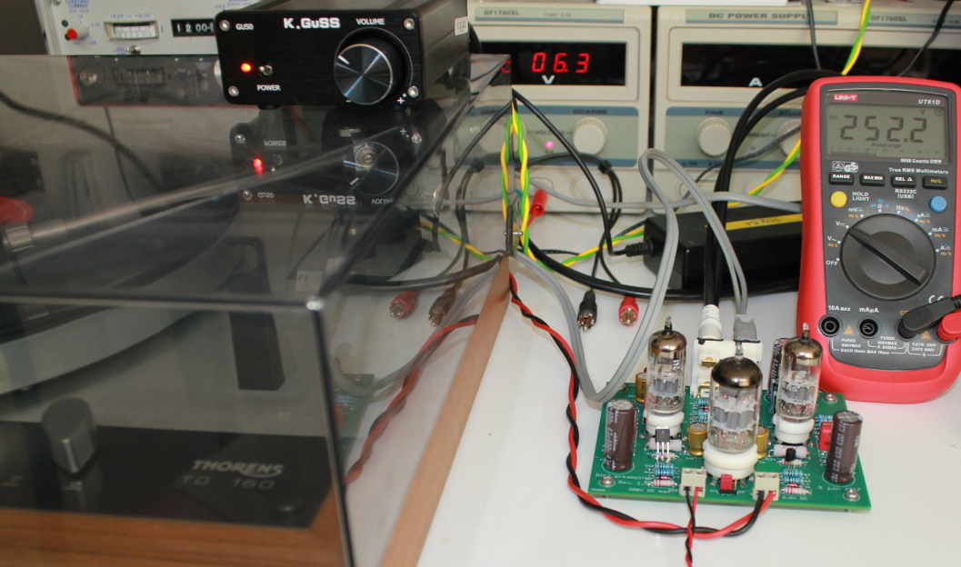

Thank you Merlin, it is the result of your nice schema with your suggestion for the MOSFET output, I only made the PCB and I like to design them, not only for the functionality, but also for an aesthetic symmetric look and as compact as possible 🙂
Now I run the RIAA preamp at 275 V, I even made a test at 300 V but the STU9HN65M2 tab was at 102°C and I didn't want to do that too long 😡
The preamp is doing very well, with the Thorens TD160 and a Shure M95ED cartridge I have played some old "Clear Crystal Record" Direct to Disk Recording and the sound is excellent :

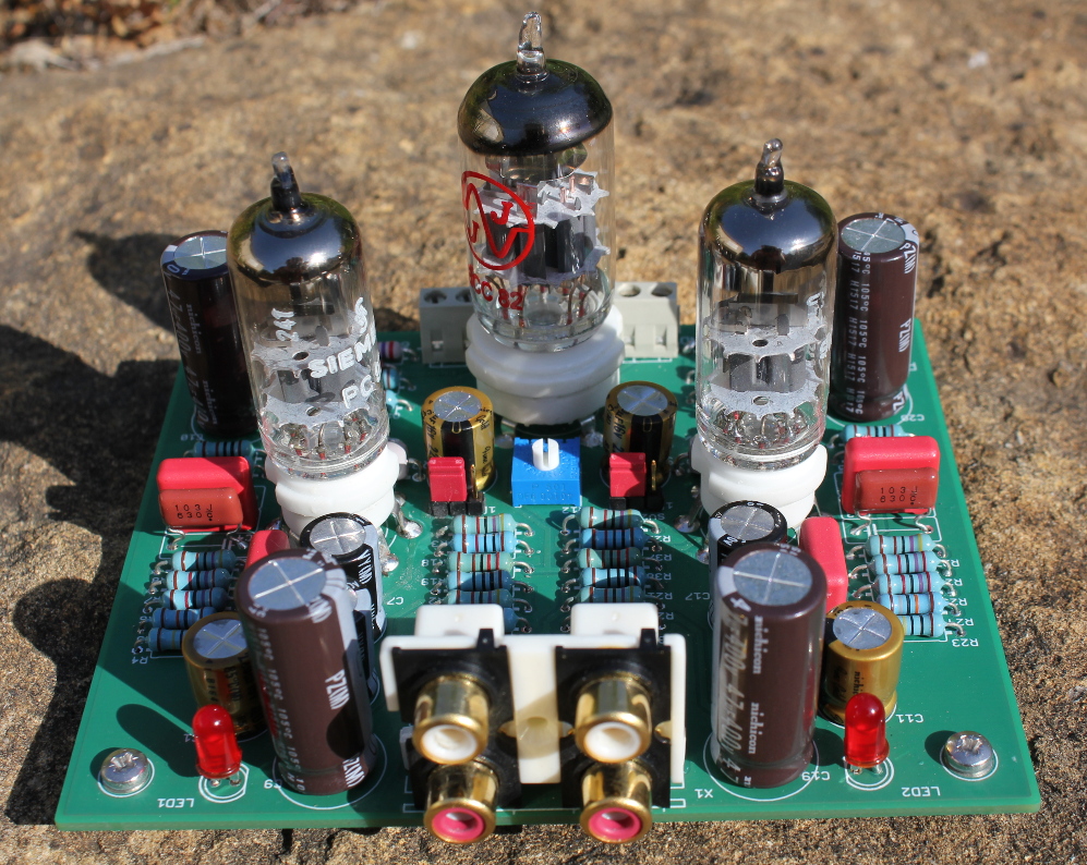

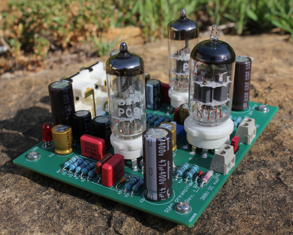

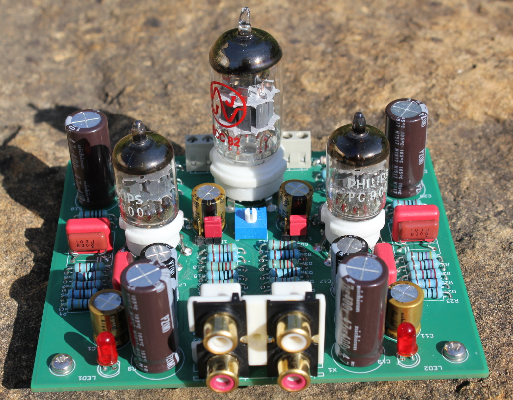

I have tested two PC97 ( Siemens and ADZAM) and one PC900 (Philips) and I didn't found a significant difference between them 😱 Both sound very good 🙂
As you can see on the Siemens and on the Philips photos, the two red jumpers are in different locations to accommodate the different pinout of the tubes... Now I still need to test a bigger TO220 MOSFET to have a lower junction temperature and I also have to design the power supply PCB. Finally I need to find a nice enclosure to put everything in a box.

can you heat sink the STU9HN65M2 ? I always heat sink source followers, (if possible).
It should be possible to heat sink STU9HN65M2. even a small heat sink will help. I have some small ones that fit T-220 that help bring down the temperature a bit. Maybe this won't work on your pcb though....
Alternatively, you could simply run less current through the STU9HN65M2.... increase R14/R33 in your schematic.
Strange that your mostfet died.. you have a diode to protect the gate - maybe check it to see if it is not defective (!)

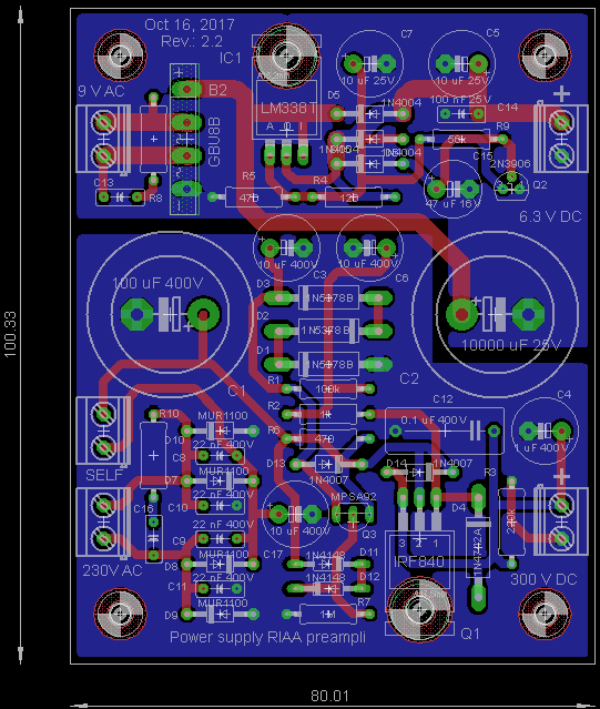

Hello,
Even if I have been very busy with the Group Buy for the Baby Huey EL34 amplifier, I have found the time to design a power supply PCB for the RIAA tubes preamp. This small module will give a 6.3 V DC regulated output for the tubes heaters and a 300 V DC high voltage stabilized for the tubes plates. I am waiting for some PCB soon and I will post photos and comments when this small power supply will be tested.

Looking at the schematic, i asked myself, why D1 D2 D3 and not simply a resistor ? After all Q3 is a CCS giving a well determined votage over a resistor.And by varying it you can adjust the output voltage.
Also why a D14 , there is an inverse diode in Q1.
Mona
Mona
You are correct on all counts, but it doesn't really matter. Personally I would have placed C3 in parallel with D11-12 instead of across D1-3, but meh, the circuit will work well anyway.
