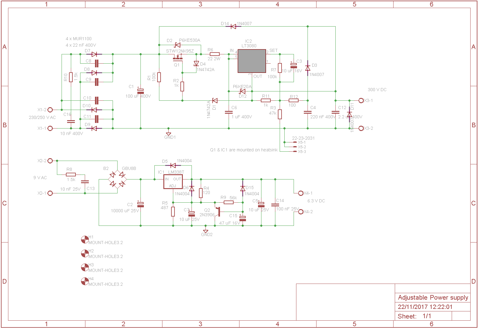

Hi Merlin,
Nice to see you again, the RIAA amp is doing very well, the only problem was the temperature of the MOSFET, my fault, I should have used a bigger one like a TO220 using the chassis as a heat-sink ! One question, if I increase the 27k source resistor to 47k to reduce power dissipation, did you think that there will be enough current to drive correctly the output ?
I have continued to work on the power supply with a new version based on the Maida architecture with a MOSFET like in your book, but I have decided to use a more up to date regulator LT3080 recommended by Tom in the 21 century Maida regulator... Don't worry about pin names in the LT3080, I have used an other device library, but the pin number is right (I hope 🙂), this version should have an even better noise floor...
I will test the stabilized version first before to decide if I build the regulated one.
Regarding availability of PCB for the RIAA amplifier, I have not yet finished the Baby Huey GB and that was a very time consuming job 😀 I like to share audio exoerience but I have to find the time, may be later if there is enough interest ? For the power supply, I prefer also to test them before I can offer them, may be I will make a combined offer : 1 RIAA amplifier PCB + 1 power supply PCB...

If the current in the MOSFET is 5mA you can drive anything you're likely to encounter. But even if the current is as low as 2mA I wouldn't wet myself. Tube buffers often run at this level and people don't seem to notice. 😱One question, if I increase the 27k source resistor to 47k to reduce power dissipation, did you think that there will be enough current to drive correctly the output ?

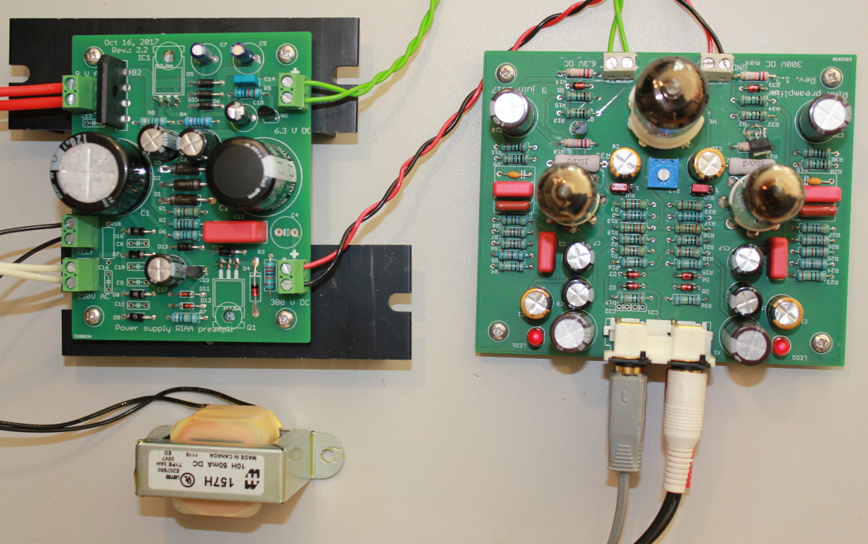

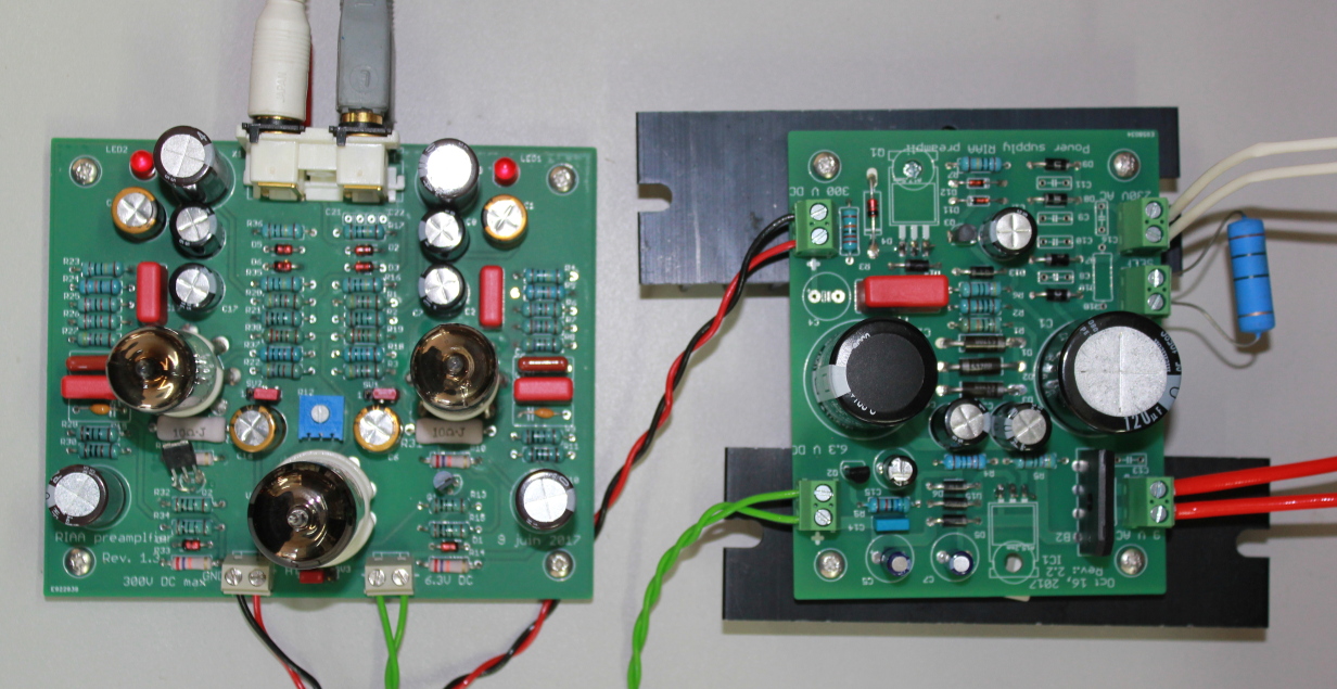

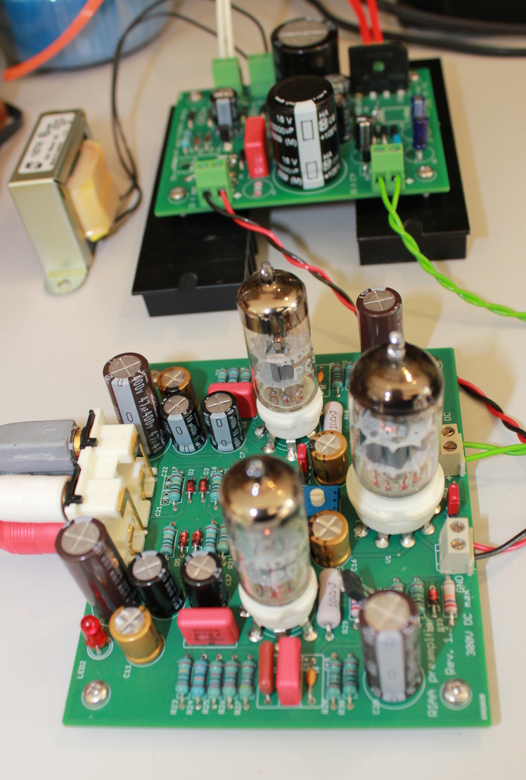

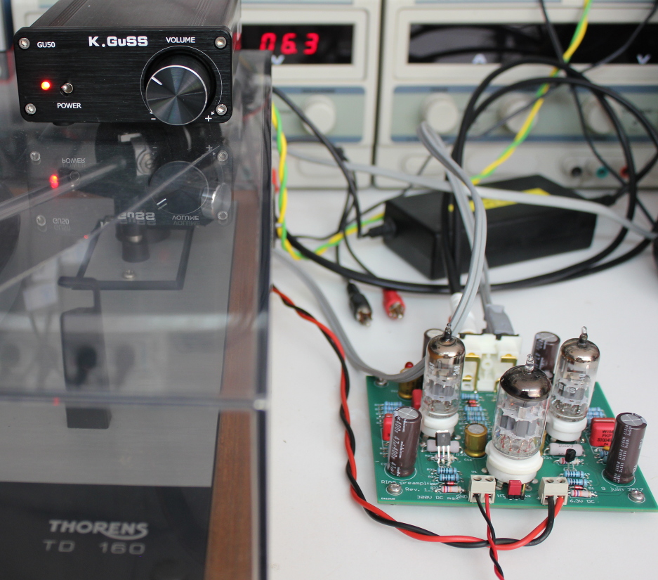

I have been quite busy with the Baby Huey EL34 GB and my little back problem didn't allow me to spend as much time in my lab that I wanted, but I am back and I finished the first power supply and made some tests with it.
The result is very good, this power supply is a good complement to the RIAA preampli, at the beginning I tested the power supply with a simple 10 ohms power resistor and later with a 10 H choke, both version are very close, I could not hear a real difference between them, in principle the choke version should be better... The heatsinks are not definitive, I need to make a dedicated one witch will also be used for the fixation of the module.
I still make the test with my old Thorens TD160 with the Shure M95 ED. The power transformer is a toroïdal custom made in Switzerland many years ago with 250 V 300 mA, 9 V 8 A and 50 V 50 mA (total power about 140 W), it is also used for my 6CA7 Baby Huey amplifier, for the RIAA preampli it's an overkill but since I have 5 of these transformers I use them always🙂
I have added some photos and now I need to put everything in a nice box, not the easiest job for me 🙁

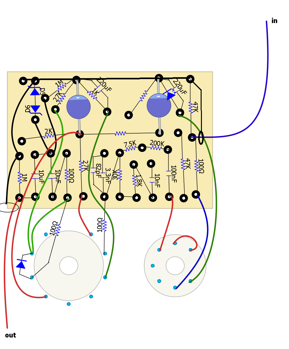

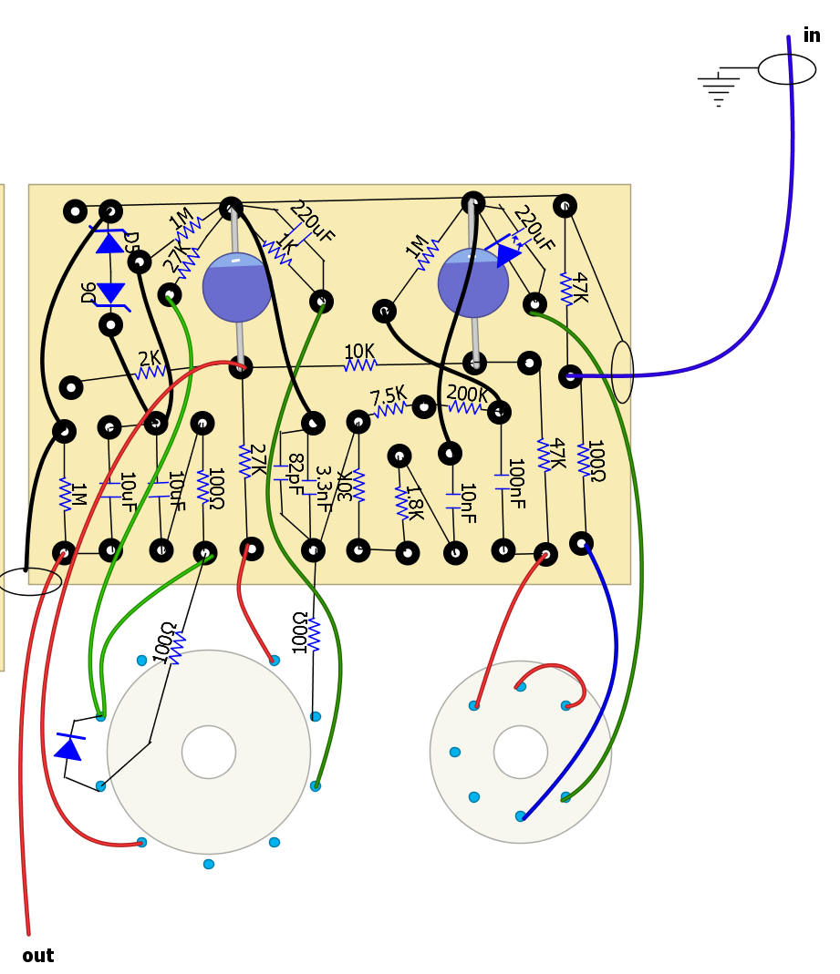

Hi please let me know if you intend to do the boards. If not I was going to make
eyelet boards. I have started on the pre (1 channel) The power supply i will start tonight. Maybe ill build this while Im waiting for your pcb. I like the footprint of yours. I'm going to use the tube follower instead.

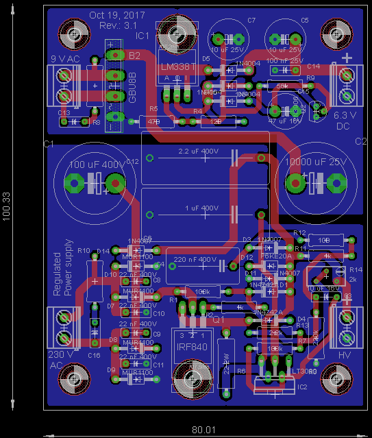

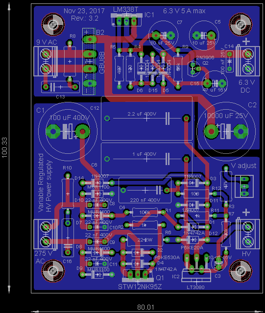

Hello,
I have modified the regulated Maida style Power Supply to make it usable as a high voltage variable power supply for my lab, or as a fixed high voltage power supply for tube application by disconnecting the pot and using only R3 for setting output voltage.
I also modified the layout to use heat-sink on the side instead of the bottom, I was also thinking to make the high voltage module only and to design a separate switching regulator module for the 6.3 V heater supply, but finaly I leave it, it is always possible to not populate it ?
If you don't find an error on this last version, I will send it to the PCB manufacturer Monday, if you find an error tell me 🙂

You can use the 2W version : 93R1A-R22-A22L Bourns | Mouser France
This will give an output voltage of 50 to 300 V DC

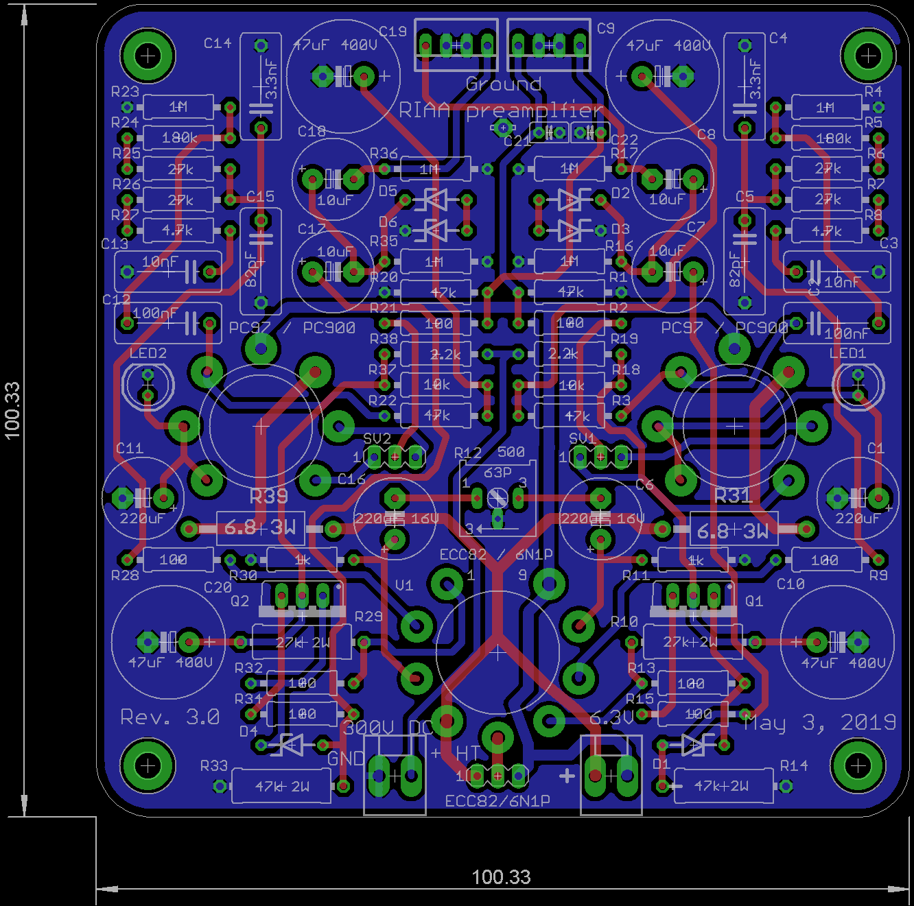

Hello,
In the past several members requested a PCB for this RIAA preamplifier and following others PM inquiries, I have redesigned the RIAA PCB with 10 cm size therefor it is now possible to buy 10 pieces for only 5 $ from PCBWay or other Chinese manufacturer 🙂
May be there could be some other cosmetic changes ?
I have also replaced the cinch connector with Molex one...
