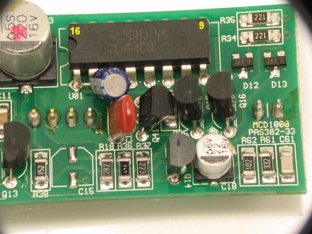

Yes. To save time, post the DC voltage on the top row of pins. Copy and paste the following list into you reply. Do not let your probe slip and short between pins.
Pin 9:
Pin 10:
Pin 11:
Pin 12:
Pin 13:
Pin 14:
Pin 15:
Pin 16:
Pin 9:
Pin 10:
Pin 11:
Pin 12:
Pin 13:
Pin 14:
Pin 15:
Pin 16:
The voltage is dropping very low. If you use a car battery, you MUST have a 10-15 amp fuse in the B+ line.

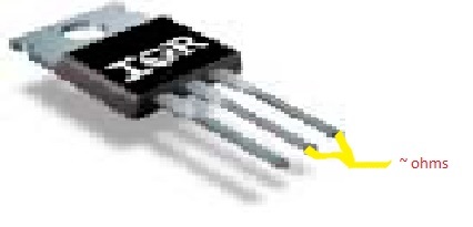

Have you checked the output transistors? You can probably check them without removing the clamps. You should not read anything near 0 ohms from the metal tabs of any output transistors to either of the two orange arrow points in the photo.
What was the original complaint with the amp (when it was installed in a vehicle)?

An instant infinite reading there is a bit odd. I'd expect it to read a low resistance and then go towards infinity.
If you checked the output transistors and none read shorted, connecting it to a better power source (properly fused) is the next step.

That means that the supply is operating. Do you now have rail voltage on the orange points?
The voltage on pins 11 and 12 should be at least 12v if the battery is charged. What is the voltage directly across the B+ and ground terminals of the amp when the amp is on?
Pins
11 - 9.53 v
12 - 9.53 v
