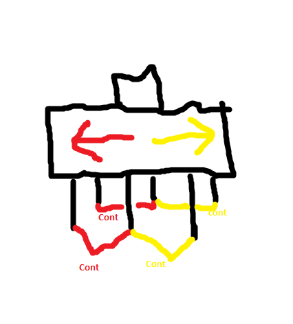

You need to check the switch to confirm that it's making a good connection between the center terminal and each of the outer terminals when it's in the 'off' position. If you don't understand how that type of switch works, go to the 'switches' page of the car audio site (page 35). There is a diagram there.
Check it with the meter set to ohms and no power applied.
I went ahead and removed the panel thanks perry probed the connections with speaker wire they all beeped on the meter I just wanted to make sure I had the connections right so here a picture of the switch and the colors represents where I probed to test across when switch to the opposite sides there was no beeps or ohms on the meter
If you had continuity for the red lines when the switch was in the leftmost position but did not have continuity between the yellow lines when the switch lever was moved to the rightmost position, the switch has dirty contacts.
I had continuity both ways just not when the switch was on the opposite sides I was probing when switched back they continued to beep again

Re-check the audio again but work the switch back and forth about 20 times to see if you ever get audio when it's in the off position. If you have contact cleaner, flood the switch with it before you do this.
that's alright I should have made the text more noticeable the yellow just doesn't like to show up sometimes
I sprayed the contact cleaner worked the switch for a bit with it unpowered hooked up the amp again sounds works both way thank you so much perry I would have thought the switch was working properly according to the test
